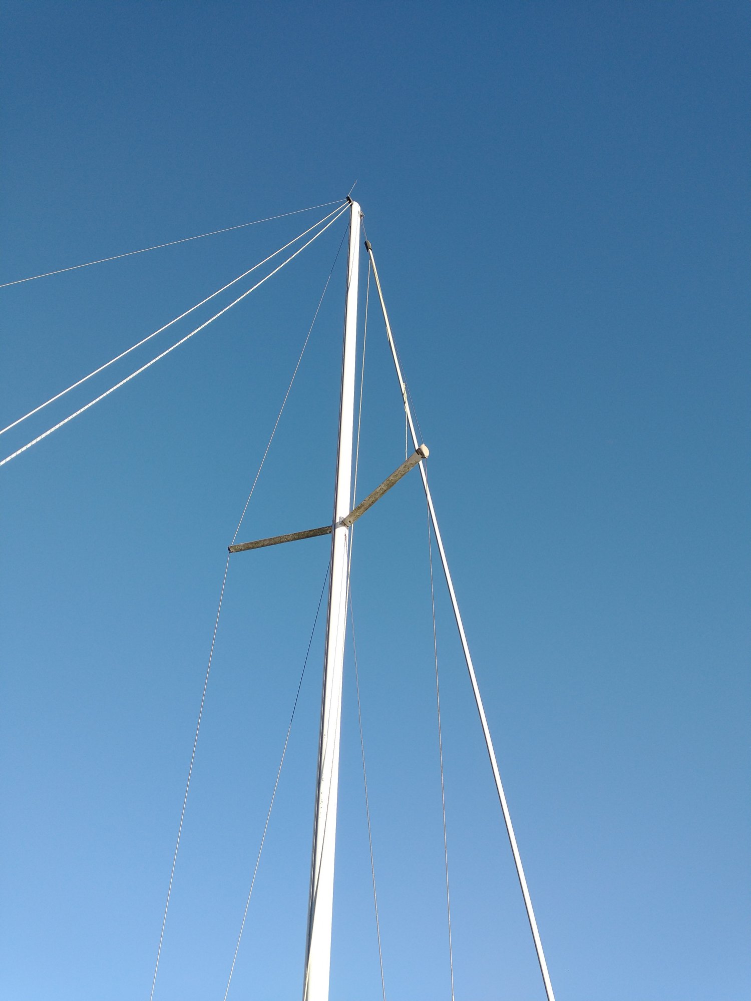

If the messenger line is hanging just above the shrouds,is it possible to use a climbing harness or bosuns chair using the main halyard and go up grab the line safely

The problem with climbing the mast on some trailerable boats, is that the keel/ballast isn't heavy enough to keep the boat stable with a 200lb human/pendulum up the mast.
13,228
@Leeward Rail is correct about the lever arm of an adult up the mast. The mast is about 30 feet above the waterline, 200 lbs at the top is 6000 foot lbs, or ⅓ more than the boats weight. Additionally, the winches may not be big enough to actually raise the weight to the masthead.
Will it be necessary to go the masthead or just the spreaders? If only the spreaders and you have a very light person who is brave, sending that person up to retrieve it. By light, I mean 100 lbs or so.
Still, I would take the mast down, it look like the step is hinged which makes it pretty easy.

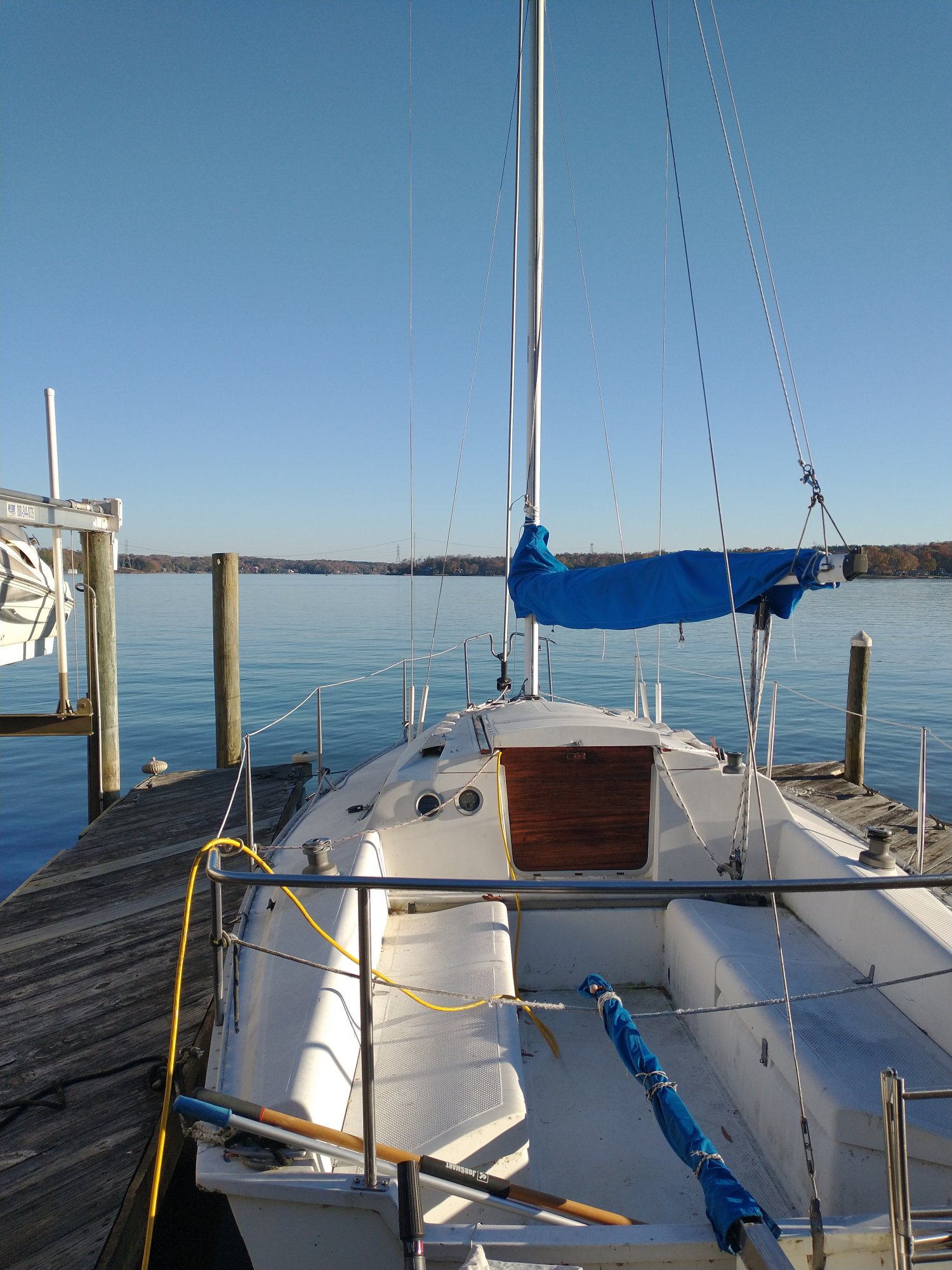

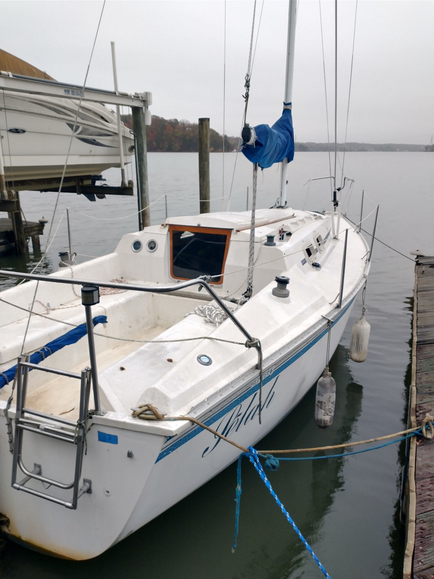

The first question I have is why did the messenger break? Did the slide get jammed in the foil and then the messenger broke due to pulling force? This looks like a CDI furler, which has an internal halyard. There are a few ways it can get jammed (from my unfortunate experiences)
-Broken strands in the wire halyard get tangled up in the sheave area at the top.
-The sheave is worn and the halyard has slipped off the side of the sheave.
-The forestay sags too much. Needs to be tight.
You can remove the whole assembly if you use the main halyard as a temporary forestay.

The first question I have is why did it break?
If I had to guess, looking at the first photo it is evident that the foil is too low from the top of the mast and it may have suffered a halyard wrap due to its extended length. lifting the jib by about 8" may solve this problem. This could be done by adding a pendant at the tack of the jib.
Jul 6, 2013
223
Catalina 30TR, Atomic 4 2480 Milwaukee
This type of furler doesn’t have a masthead halyard. The halyard is internal to the foil. The sheave is in the black cap at the top of the foil, so halyard wrap isn’t possible. This appears to be a proper installation.
