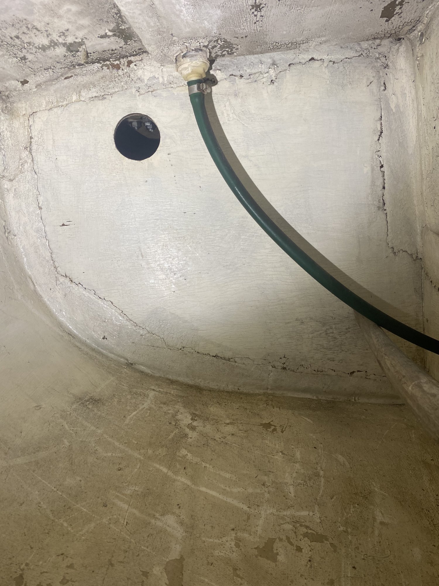

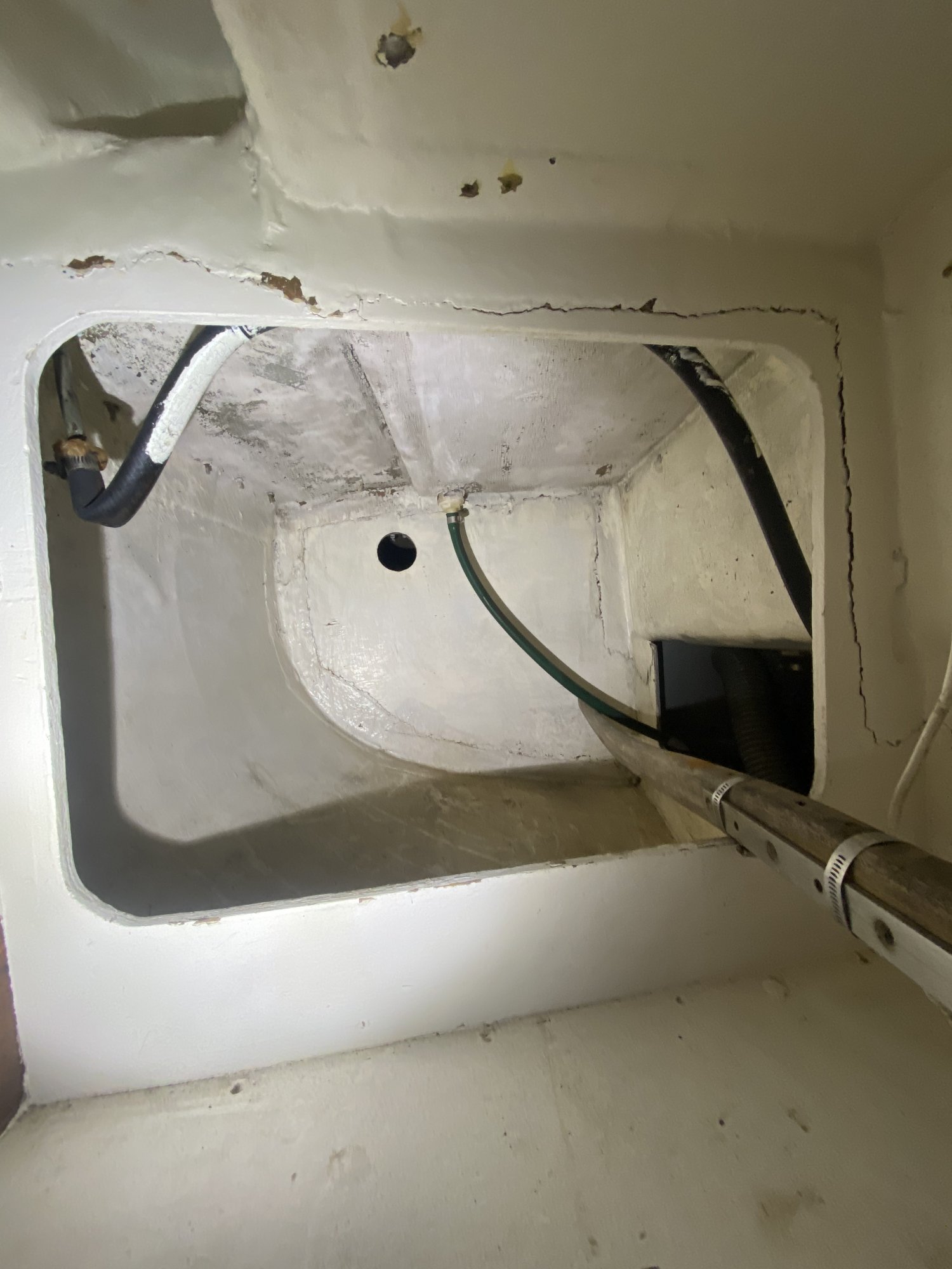

I recently purchased this 1963 wayfarer islander 32 and I’m a little concerned about the fiber glass lifting up in the hull supports , could I break off the lifting fiberglass sand and lay fresh glass ? The back sides look a lot better and the pieces of plywood are only about a 1/4 inch thick how much are they even helping ? The front one has a bit of give . The hull looks great and everyone keeps telling me how strong these all fiberglass 60s boats are but the lifting glass does have me alarmed considering I have her setup to solo sail and plan to take many solo trips soon ! Any advice would help !

To me, it looks like the fiberglass tabbing to plywood bulkheads is separating. It could be from years of flex, possible water intrusion, or standing rigging that has been incorrectly tightened. Getting a handle on the cause is important, but a fix isn't too difficult if you're able to venture into some fiberglass and epoxy work.
7,619
I don't think there is an immediate danger. Tabbing can lift off like that from a variety of reasons: Too much rigging tension as said. Collision. Improper lay up. Hard grounding. In the case of the latter is there any other evidence of a hard grounding? Maybe broken tabbing or cracks around the keel stub? Displacement of the keel from the stub (Observable while on the hard)? Water ingression? A damaged keel joint would be the only reason I would forego using the boat solo or otherwise.
Make a plan to fix it DIY if you can. It's unpleasant work but not particularly hard or requiring special skills. A good angle grinder that's not too big or heavy would be a big help.

:plus: On the issue. Tabbing. Failure. It happens. As pointed out by @nightowle multiple possible causes. It will not likely sink your boat but it will continue to fail.
Boats flex and contort while riding over and through waves the tabbing is there to stiffen the hull.

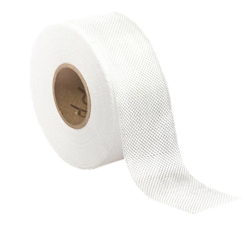

As @dlochner shares you will want to replace the fiberglass tabs that connect the hull to the plywood bulkhead.

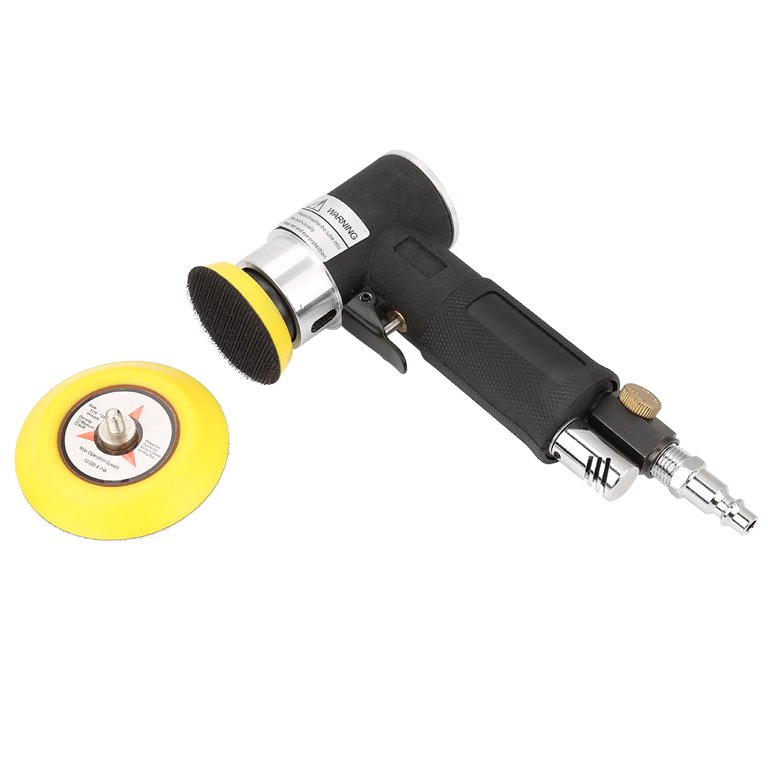

This involves removing the loose pieces. Grinding off the paint/gel coat to solid material, carefully. Wetting the area (to bond with a tab of fiberglass - the glass hull to the plywood bulkhead) with polyester or epoxy resin. Laying a wetted piece of fiberglass on the areas you are tabbing together. Then paint or gel coat to seal over the tab.

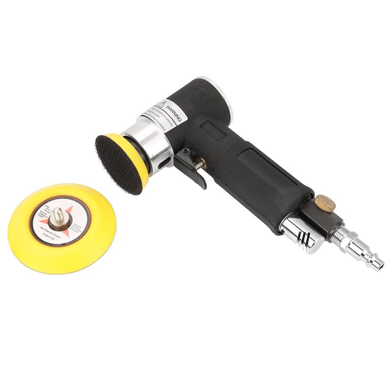

Grinding might be best accomplished with a small head air sander/grinder.
Mini Air Angle Sander,

I personally wouldn't mess with that, I'd get a quote from a competent boat fiberglass guy. That dust is murder! And it's hot, and if you're not doing FG work every day it's awkward and messy. (I've done more than my fair share of it!)

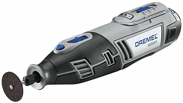

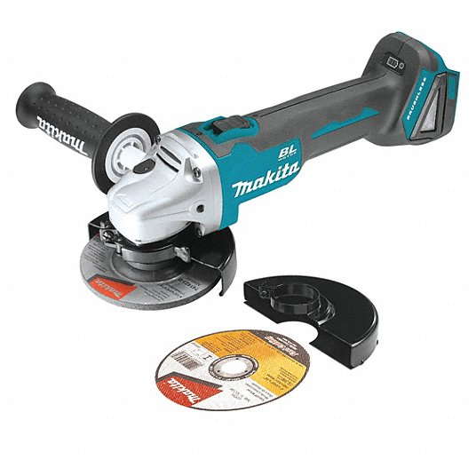

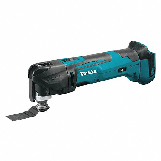

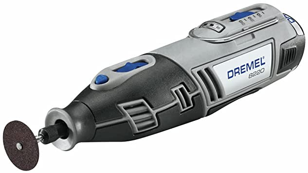

The good news is that you now have an excuse to buy some new toys....In addition to a grinder (get a cordless if you don't already have one) I'd add a dremel with a cutting wheel and a multi-tool (also cordless) to my collection of tools for that job. Cut the old tab off of the plywood. You can use the dremel to notch the joint where the fiberglass tab meets the hull. Then use the multi tool to lift the tab off of the plywood. Then grind the lip of the jount until you have a smooth bevel at the joint boundry. Grind the surfaces a little where the new tab will sit to get a good bite and lay wetted fiberglass tape around the joint. I'd use epoxy as the resin and 6 oz tape. Cut the tape into 4" strips and wet each one... lay them on a piece of plastic sheeting and cary that into the boat, place the wetted tape on the groove and squeege. Overlap each piece by about an inch. Allow the resin to go off and when it is just barely tacky to the touch.... do it again but over lap the edges so that some fresh plywood is under the second layer. If the layers still seem shallow, you may need a third round. I like to buy my fiberglass materials from Jamestown Distributors. They will get on the phone with you and talk you through any technical details you may want. If you tell them what you are doing, they will recommend the right product and quantity for the job.
I went around and double checked all the rigging (I don’t have much experience)it Is in my opinion extremely tight but has slight give. Both rear bulkheads are like the this on both sides. I haven’t gotten the boat out of the water yet but plan to before any trips to double check everything . Only one of the bulkheads in the rear has play and plan to start with that one first. based off everyone’s answers I would say the likely culprit was years of water intrusion , I sanded down a spot on the bulkhead and the wood is still solid no rotting found! I’ll be down at the marina in about an hour I’ll post some more pictures any advice would be appreciated!

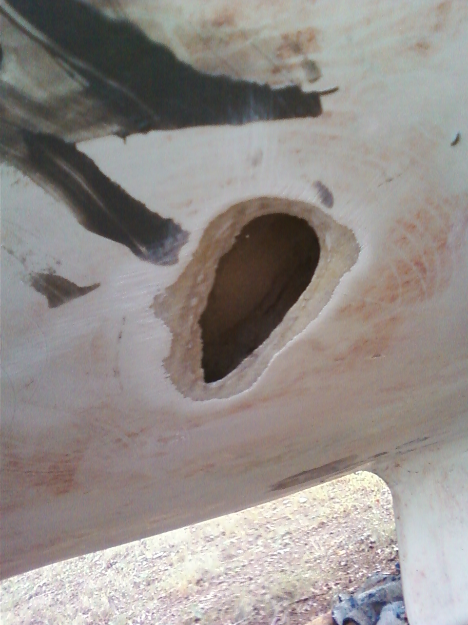

@jviss gave the correct answer in the previous post but... here are a few things that help if you ignore it and plow ahead (which is what I have done many times -- not ignor jvis:biggrin:--- plow ahead:beer:). First thing to know is that raw resin is toxic... many people are cavalier with epoxy but you should not be... and prolonged skin exposure often leads to an alergic reaction that once you trigger... will make you sensitive for life... so... don't get it on your skin and if you do, wash it off quickly

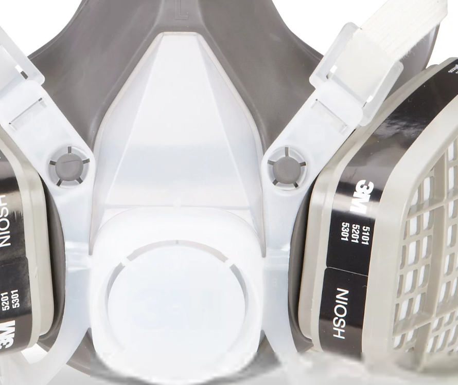

For respiration PPE you need one that also absorbs organic vapors. 3M makes one and I can usually find them at Lowes or Home Depot ... it looks like this... make sure you install the organic vapor cartridge.

A trick I use a lot is to get a piece of overhead projector vellum .. like this.
Epoxy does not stick to it... You can line the edges with masking tape (sticky side up) and then lay four to six layers of wetted fiberglass cloth on the film as needed... then take the film and fiberglass into the boat and tape it in place where you want the tabs. The vellum holds it all in place while the resin sets and when you peel off the vellum you have a nice smooth surface with minimal sanding needed before painting. I like this meathod because you can wet and squeegee in the comfort of your work shop (space) and you don't have to do this while contorting in the tight corners of your boat. It also saves time because you can do multiple layers at once and you don't have to wait between layers. For odd shaped glass projects, take the vellum to the job and trace out the space with a sharpie right onto the vellum. You now have a template for the cutting of the cloth.

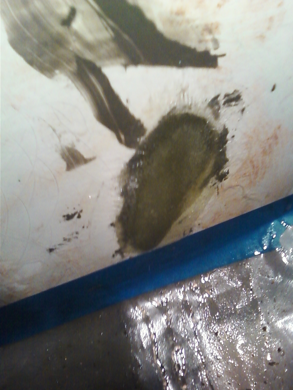

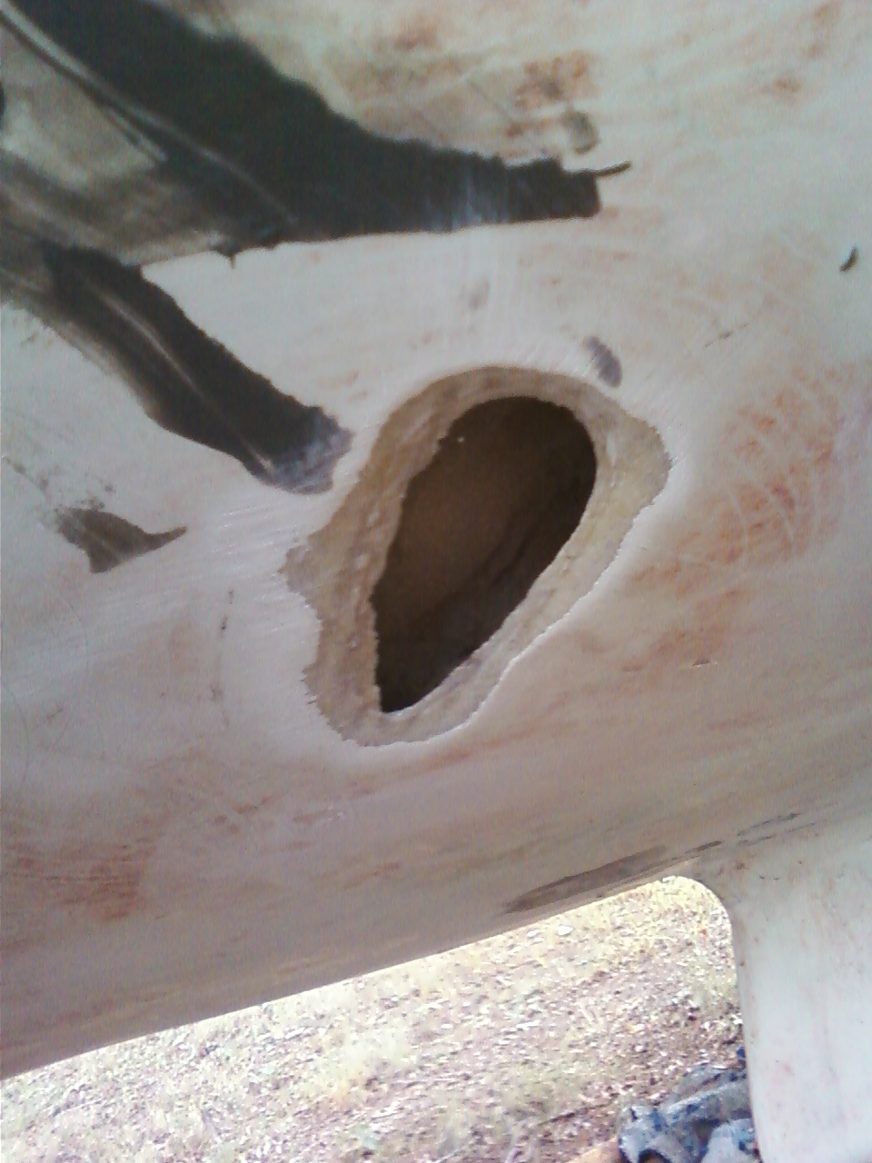

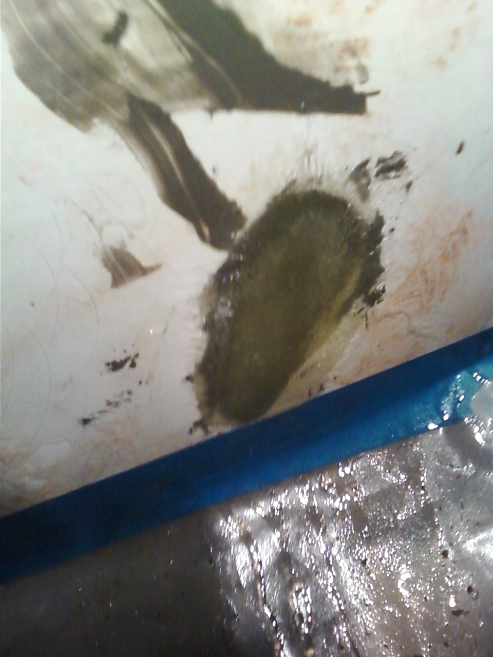

Here is a pic of a hole in a boat that I fixed using the vellum meathod
And I tapped a 6-layer fiberglass patch with vellum into the hole with vellum and this is what it looked like when I removed the vellum,... you can see the vellum sheet in the bottom of the pic.
