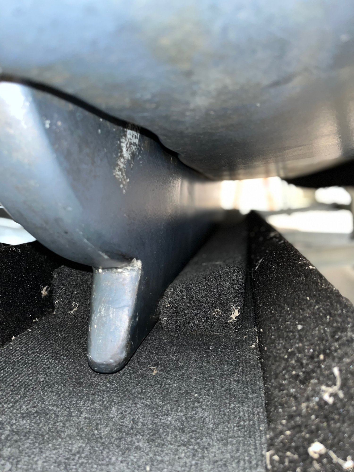

Will do that. Since boat is on the trailer I fixed up what I have adding another half. Once launched I will completely redo. I can see that this could be important launching too in case cb came down while still on trailer. Can you recall if the tray was 2 boards or one piece? I am thinking 2 since there is an angle on each side.
Jul 24, 2012
45
Hunter 240 Muskegon

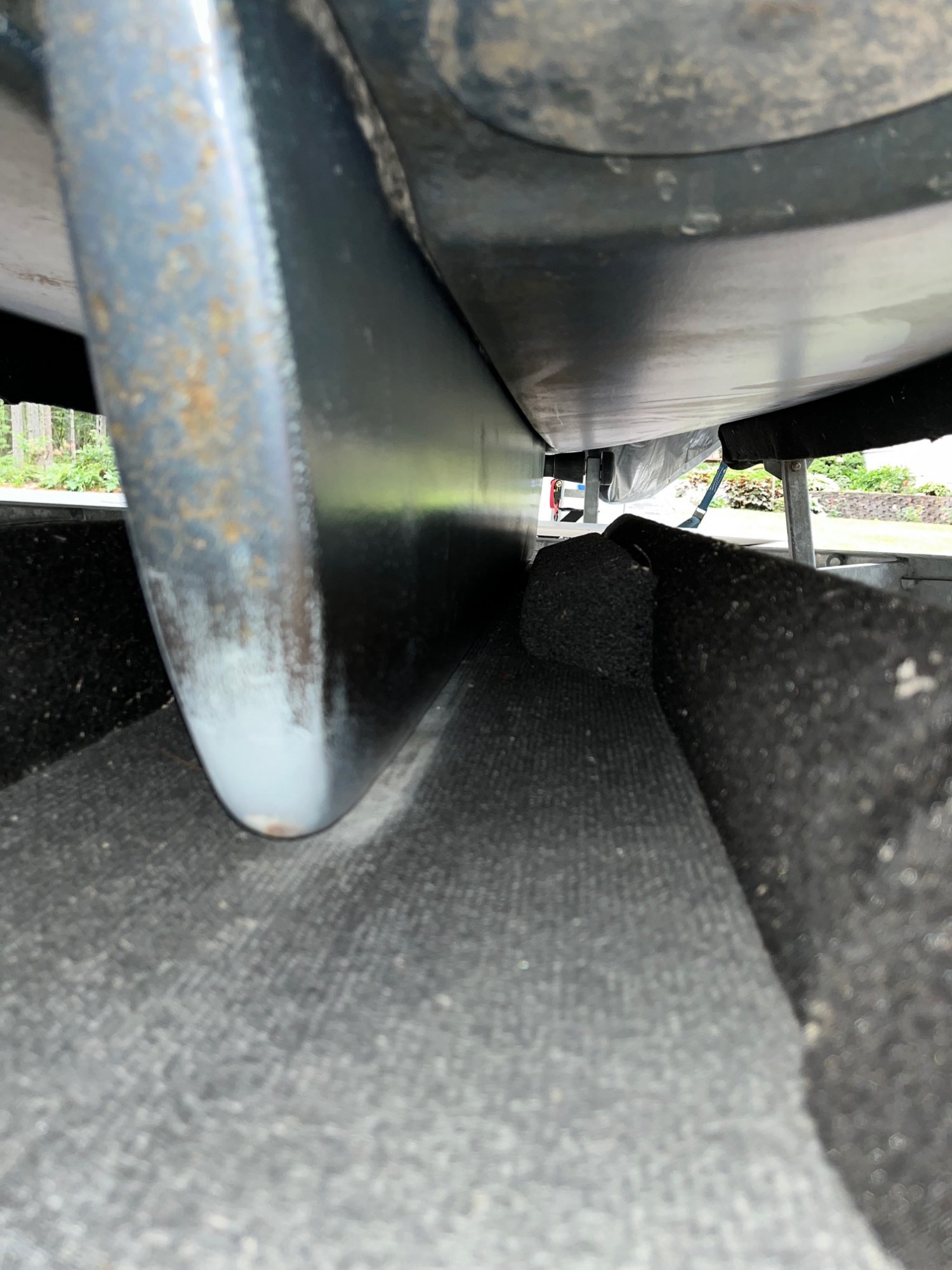

The bottom board came on my 2003 Magic Tilt Trailer. I had problems getting the boat centered on the trailer in high winds, waves or currents. I added the side boards and guide board shown in the pics. Now the boat goes on the trailer centered every time. One of the best DYI improvements.
I have a roller but once the boat is out of the water, the boat is about 1" above the roller. The boat is just resting on the bunks. The swing keel is just resting on the bottom board. I Have a Hunter H240, 2004.

That looks like a nice setup. I just finished work on my trailer with new tray, bunkboards and bunkboard supports. The tray on my hunter trailer does form somewhat of a v. It will be my first time loading her back on trailer come winter.
10,413
-na -NA Anywhere USA
When loading up the boat after sailing season, make sure the centerboard is not jammed between the hull and centerboard plate. If it is the bunk boards need to be raised by the same length all way round on the supports
