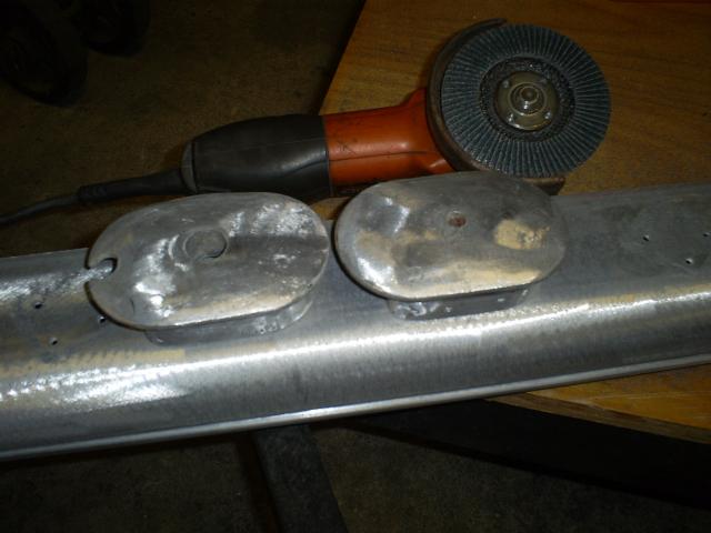

I just pulled the boom. It was on there for 30 years and corroded completely. I used an electric impact gun to unscrew the screws. Some of the heads broke off but I was able to grab them with vice grips and unscrew them out after that. If there is corrosion a screwdirver will just mess up the slot like you suspect it will.
I used a 4-1/2" flap disc sander to remove most of the corrosion and hand sanded and wire wheeled the tight radii. It's at the powder coater right now. It will be 'marine silver'.
An impact is the way to go to remove them. They sell them pretty cheap now and are very handy.
