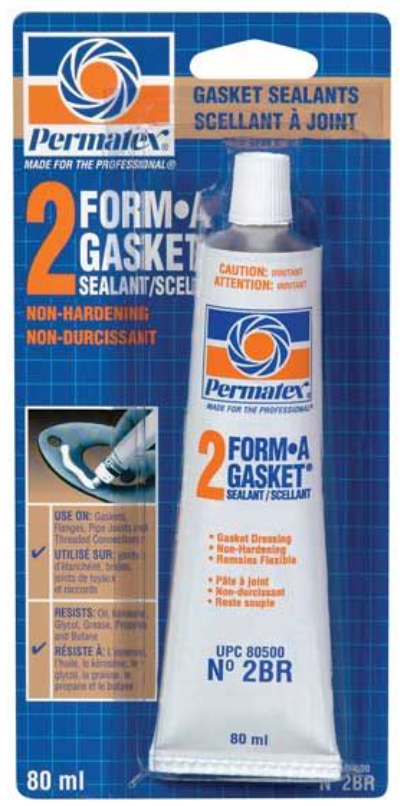

Does anyone know if I can use Permatex form-a-gasket #3 on the PVC thread? (I heard you're not supposed to use teflon tape on plastic and I already have some of the permatex onboard)

Teflon tape certainly won't affect any plastic as it's completely inert at ambient temperatures. The tape is a popular thread sealant because it's clean as opposed to pipe dope which is messy. However, Teflon tape not the best thread sealant on the block, hence you will see in commercial and industrial applications for threaded pipes carrying water, the preferred sealant is 2 - 3 wraps of thread and a very light smear of pipe dope. The most common pipe dope I've seen is Permatex #2. The combination of the two seems to be better than the tape alone and the smaller amount of sealant used makes the job much cleaner.
