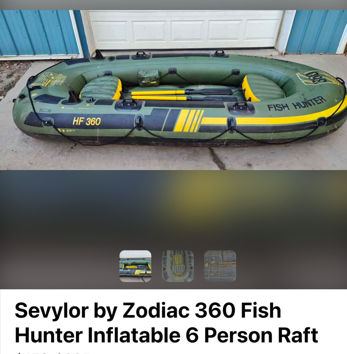

Looking at this for a shore tender
Seems pretty simple to tow and store.
Thoughts?
14,300
If you put 6 people in that raft there will be a lot of wet butts and probably wet feet, that's assuming it will still be floating.
It looks like a light duty PVC raft. PVC is not UV resistant and is not very strong. Sevylor is a mass market, low end, brand, it is essentially a toy. While the quality is probably OK for that market and use, regular use as dinghy will shorten its life span. The paddles look like cheap plastic paddles that will not be very durable. The raft with its flat flexible bottom will not row or paddle well, you'll spend a lot of time going in circles or you will need 2 people paddling on either side to go in a semi straight line.
It is probably best left right where it is.

I guess we will leave it where it is. Thank you for your honesty.

We have a similar one for rowing from the dock to our mooring. It's survived 3+ seasons, though this year it needed 2 patches, which was a relatively simple fix. We're not exactly gentle with it -- pulling it up on shore, etc. but it's served it's purpose. Gets us from the dock to the boat 250 yards away and back again.
I'd love a small rigid row-boat that would actually track decently (the inflatables don't track worth a damn, people will think you are drunk or don't know how to row) but for the price, they'll get you where you're going eventually.
The biggest issue we've had is that it's kind of a pain to get from the dingy to the boat -- you can stand up in them, but getting over the gunnel can be a bit of a challenge. You're very low to the water, and the sides of our Catalina 22 aren't huge, but it does take some effort.
We've had 4 people in ours and it was fine. It's rated for 6 maybe 8, but for that many, I'd probably row out and then motor to the dock to pick the rest of the group up.

It's a light weight, so for lightweight work, it might be OK. Above that and better to look for a more solid dinghy.

Depending on your needs, that blow up boat may work. Note that it's more of a toy than an actual boat. But it all you want is a way to get from land to boat and back again, and you don't need to very far, then it would work.
If you plan on using that as a real dinghy when cruising I think you will be disappointed. Note that if you deflate it, it will still take up a decent amount of space. Inflating / deflating will also be time consuming. A hard dinghy will be cheap, easy to row, easy to tow, and will work a lot better.

For an inflatable, I would really recommend spending the money on a real boat, not vinyl toy like that. It might last a year or two but it will be very wet and horrible to row. A Highfield 280 would be more seaworthy than that 360. I recommend an aluminum floor for rowing, motoring and stability but they weigh a bit more and don't pack as small as an air matt floor.

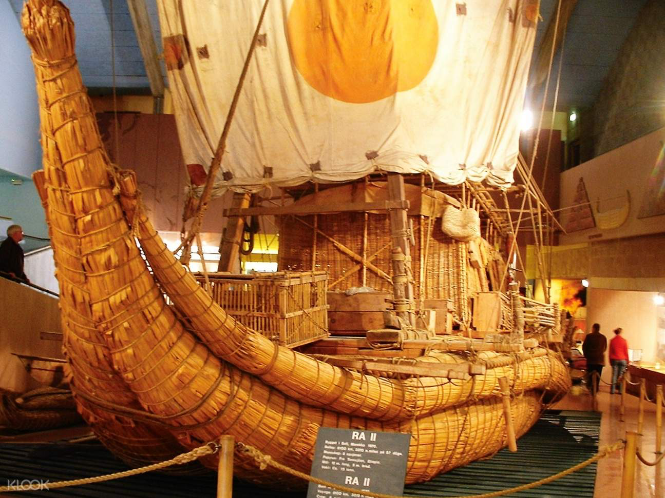

Reminds me of the KonTiki...

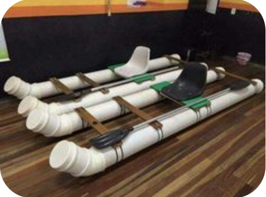

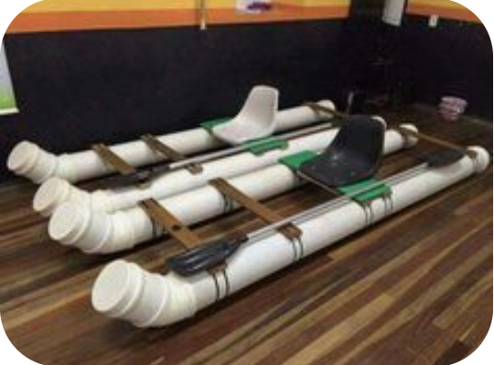

It looks like a modern-day vision of a coastal pond cruiser without the sail.
