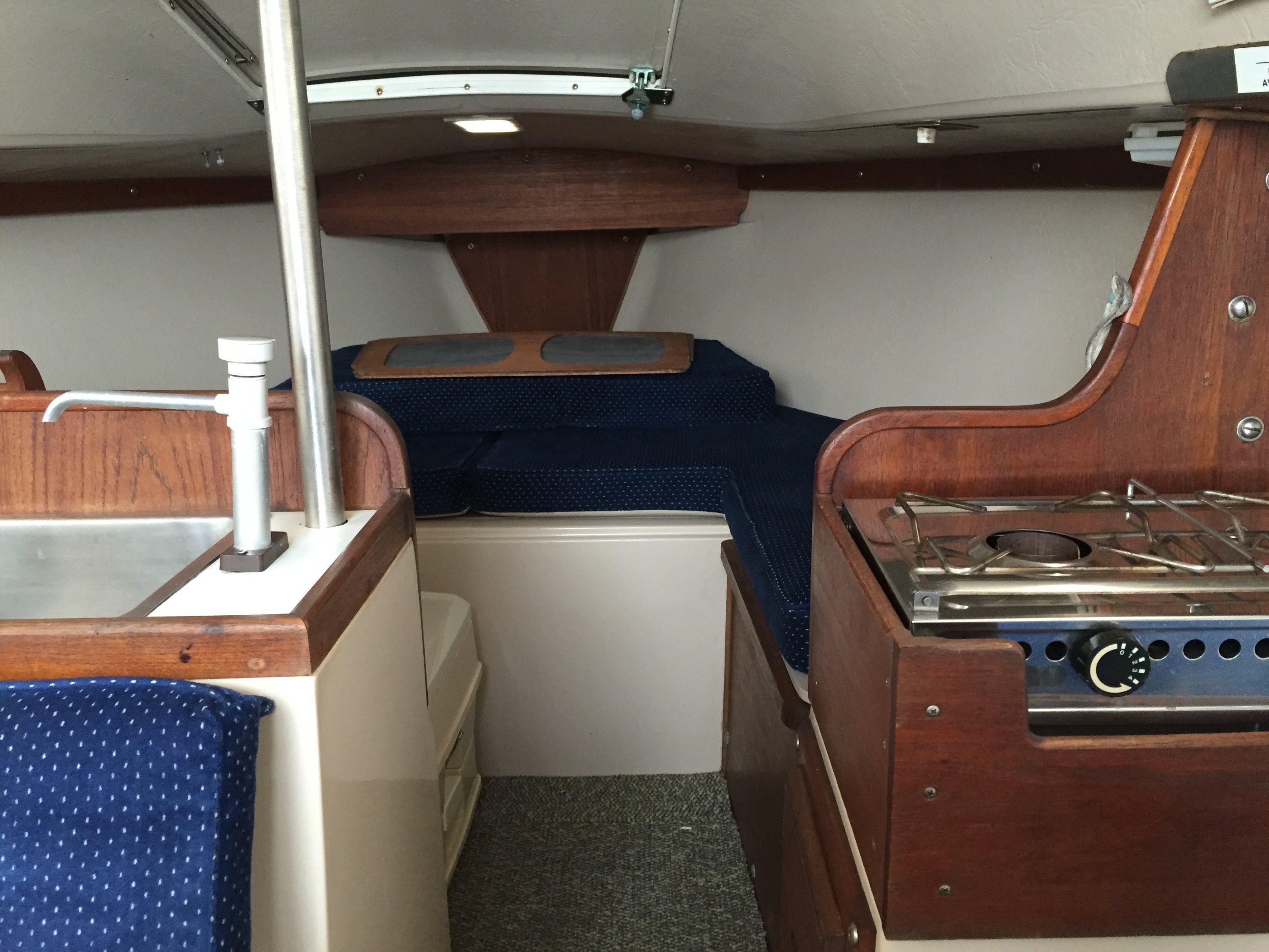

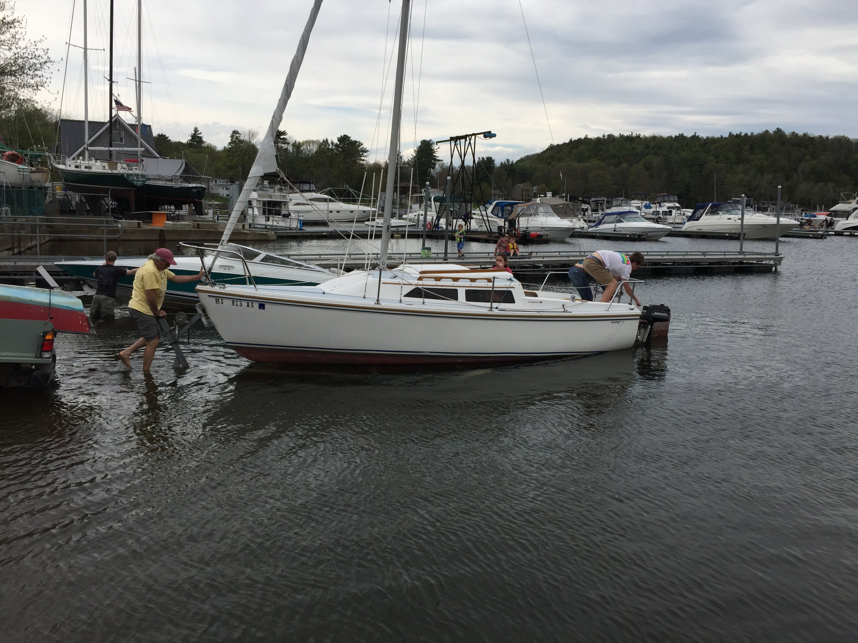

So I bought the boat today and overall I am pretty happy with it but it does have a few condition issues. The sails are nearly perfect but she has been moored in Cape Cod the last 10 years and the keel is pretty rusty. It has the original Load Rite galvanized trailer which also has some surface rust. The bow pulpit was damaged when he was pulling it out of the barn but still usable and I hope to find a used one. The interior looks great and most of the wiring still works. I am hoping to get her on the water soon without doing much work on it until the Fall.

So I completed the sale on a 87 model this weekend from a really great couple. They pretty much spent the entire day going over the boat, helping us rig her and getting her to the new mooring on Lake Champlain. The first sail went really well although it was snowing here this morning so it might be a few days before we venture out again
Some condition issues I'd like to address are:
- As Shotgunslim predicted, there is some rot on the edges of the top bulkhead. I have no idea how to fix that
- The mainsail cover and cockpit cushions are shot
- Replace the bow pulpit wrapped in duct tape :)
I'm broke now so I'll have to do these things one at a time.

You look like you are in pretty good shape... from a distance it does not appear that the keel is so badly rusted it would need a full keel job. To sail for the summer I would just wire brush the areas of bad rust, put on some primer and a little fresh bottom paint. You might get a little more rust by the end of the summer, but not enough to hurt it any more. You can tackle an epoxy job on the keel after you haul out for the winter, and it won't be nearly as bad as mine was.
Don't worry about the rot on the interior wood just yet... there was probably a leak that can be easily fixed. Later in the winter you can remove the bulkheads and repair the water damage, it is not hard. You can buy some butyl tape for $25 and re-bed your hardware to prevent leaks for this season.
From the pics I see your boat is in pretty great shape, the only things you'd need to do are elbow grease. Don't worry about the seat cushions... UV kills everything over time, it happens to the best of us. Cheapest fix is buy a used heavy duty sewing machine off craigslist and learn to sew. After doing some basic projects and refining your skills you'll be able to make all the cushion covers and sail covers you'll need just for the cost of material.
If you want some more specific advice about any problems you find take some more detailed, close up pictures and post them here. Lots of members on this forum have tackled just about every major and minor job that is possible on a C-22. For now you look like you are in good shape, enjoy a summer sailing her and plan bigger improvements for the fall.
