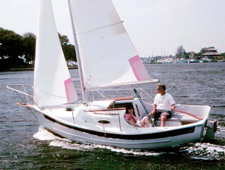

I have a Seaward 17 with a winged shoal keel. It's about 6 ft long, 18 in wide, and 5 in thick. 450 lbs. So it's a bit chunky to say the least. Problem is I can't get the boat to sail on a close haul to save myself. I read one article that claimed the best you can do with this boat is 60 degrees. What am I doing wrong?

Is this your boat
Do you have a traveler? Are you experiencing weather helm or do you just luff when you try to point? From this picture it sort of looks like the rudder is not biting very deep in the water. Do you notice a difference in pointing ability if you shift to the back of the cockpit?
Yes, this looks like my boat. Yes I have a traveller, and yes she luffs when trying to point, then stalls and heads downwind. The rudder extends about 30" into the water . For what it's worth, this boom looks like it's shorter than mine.
