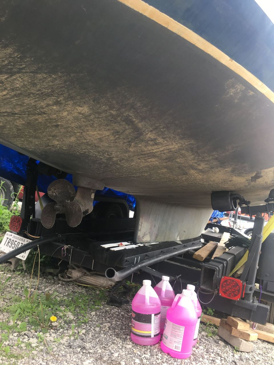

I have VC17 on my hull. It wasn't pressure washed at the end of the season. We attempted to do so about a month ago and it did get a little cleaner. As you can see the paint doesnt look the same throughout. I know VC17 is a unique paint so I'm going to ask a seemingly dumb question... Is this dirt on the bottom or does this look like a quality of the paint? If it's dirt, any recommendations on how to clean it?

I do power wash in the fall at haul-out but there is sometimes some of that stuff left in the spring. I use a light hand sanding with 220 grit to take it off then wipe it down and put another coat on.

Do your self and your elbows a favor if it is, in fact, dried algae(sometimes called pond scum). Use a diluted, acid based cleaner. Toilet bowl cleaner, the cheap kind you can find at any janitorial supply house... Smart & Final comes to mind.... Mix it up in a 5 gallon bucket and get a long handled pot scrubbing brush to slosh it on. It will literally disappear before your eyes. Hose it down with fresh water, you're good to go. Acid will remove anything biological in nature.. If it has a petroleum-organic character, such as the skid marks from rubber bumpers... then Acetone is the right product.
That sermon completed.... that looks like old paint has simply worn off...not new biological growth. You'll know immediately, because toilet bowl cleaner will not work.. nor anything else... to remove bottom paint. Stripper or sanding are your options... but heck.. you should be able to just follow the instructions on your new bottom paint label for apply it over existing painted surface.

The paint is VC-17 which is a freshwater only paint. One of its virtues is no buildup to speak of and it leaves a very slick surface. It changes color to that dark brownish black color in the water.
Diluted muriatic acid will also clean it up. Wear PPE, especially eye protection and have lots of water to rinse it.

Wow! Thank you for the overwhelming number of responses! I can scrape it off with a fingernail so I'll try some brillo pads before resorting to acid

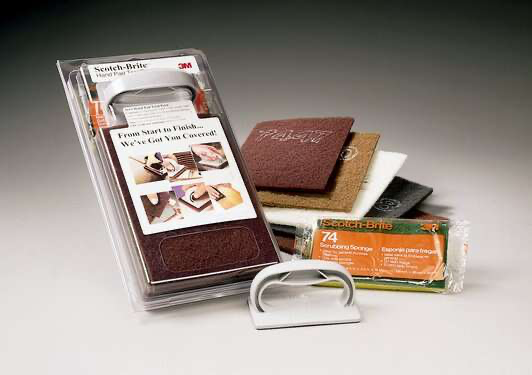

Not Brillo Pads but Scotch Brite Pads. There is a major difference. Brillo pads will leave little bits of metal behind to rust on your pretty bottom...
You can get scotch brite pads in different abrasive levels. https://www.3m.com/3M/en_US/company...0644+8710812+8710964+8711017+3294857497&rt=r3
You can even get them with a handle to protect your fingers. Scotch-Brite™ Hand Pad Trial Pack 961S
