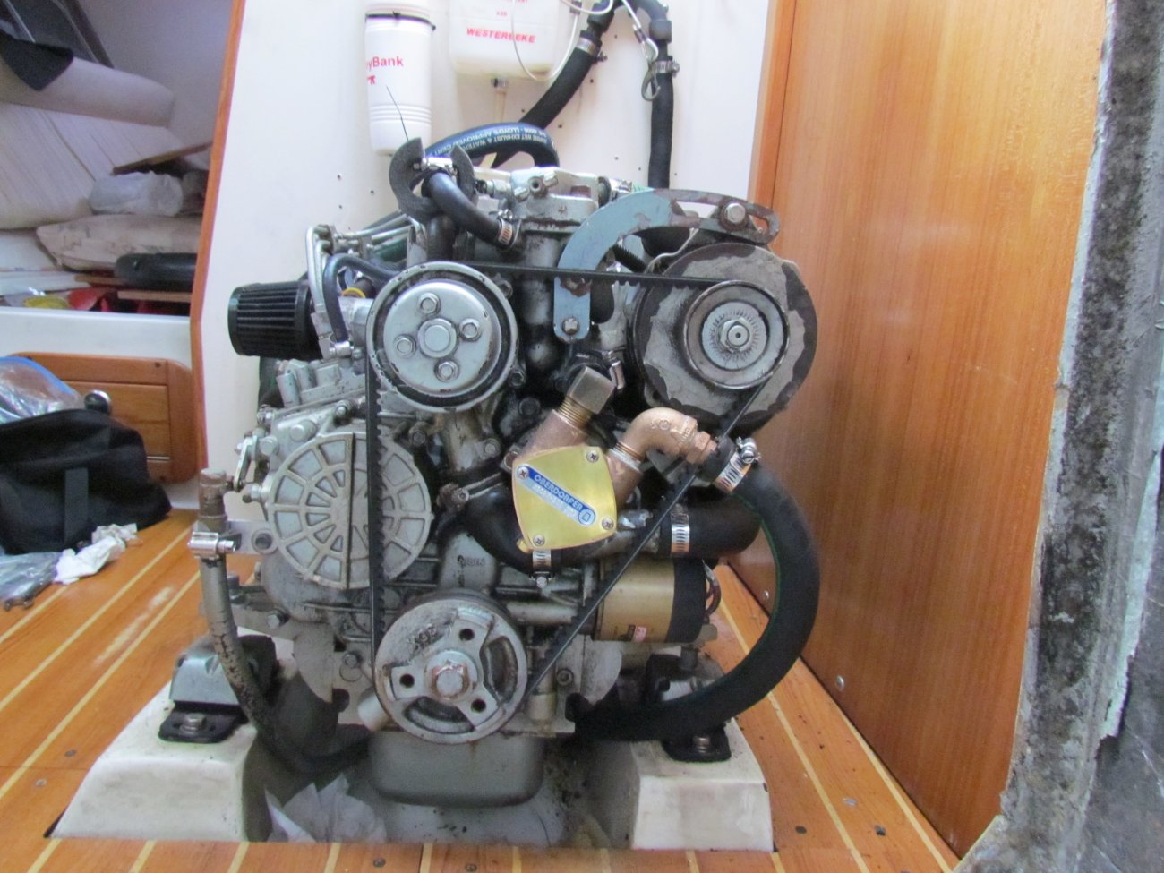

Think I lucked out. My switchover to Ober didn't require any grinding to fit my M24XPB. I did read about some
folks who had to do some grinding.

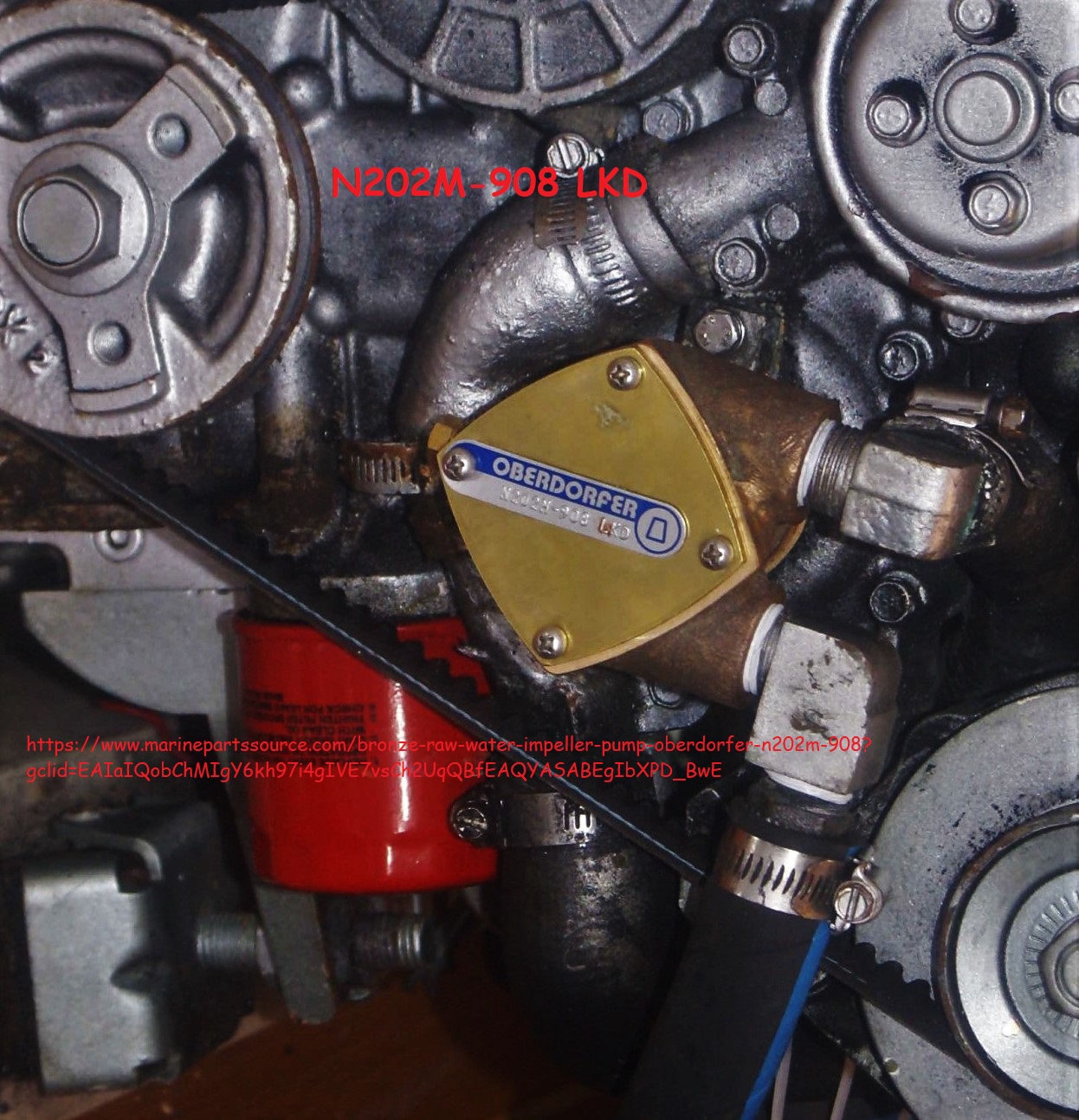

Ober part # N202M908
Impellor OB 6593
O ring OB 9797-034B
This was in April 2016 but part number should be the same. O ring sooo much better then using paper
gasket in Sherwood.
