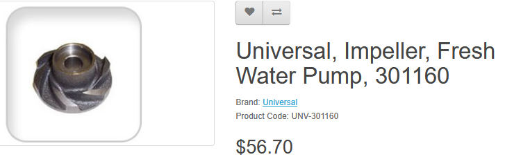

Also, does the M25XP have a circulator impeller that needs to be replaced every so often?

@Ralph Johnstone I looked it up just after posting and discovered that you are correct

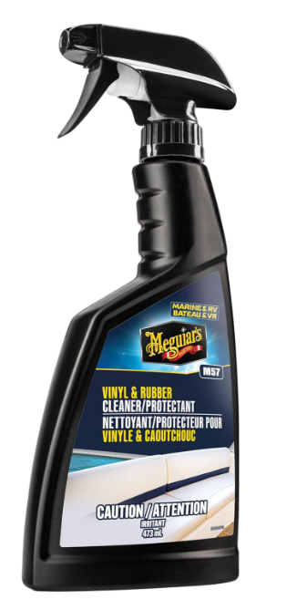

Same experience as @Davidasailor26 and installed a new Yanmar raw water rubber impellor after 10 years of use. It looked perfect when removed. Coated it with Meguiar's vinyl protector :
............ and sealed it in a zip lock baggy. Still looks great after 16 years and the new installed impellor still looks great is still going strong. I have to wonder if exposure to air (oxygen) is the culprit here.

Let's discuss water pumps. You engine has two. One is the 'raw water' pump. This pump sucks up seawater (fresh water if you're in a river or lake, salt water if you're in an ocean, sound, bay, etc.). The other water is the 'coolant' pump. Just like a car or truck has a water pump to circulate coolant through the engine block, your Universal M25 has a water pump to circulate coolant through the engine block). Where the car has a radiator to cool the coolant, the boat has a heat exchanger. The automotive radiator is an 'air to water' heat exchanger, the marine heat exchanger is 'water to water' meaning that the seawater is used to cool the coolant. Note that the seawater and coolant never mix, they are kept separate inside the heat exchanger.
Note that your engine also has a thermostat (just like a car). When the coolant reaches a set temperature, the thermostat opens and allows the coolant to flow through the heat exchanger.
While the coolant pump can wear out and need replacement, that is pretty rare. Mote common is for the thermostat to fail closed. This will cause the engine to overheat. Signs of a bad coolant pump are leaks of coolant (not water) and an overheating engine.
My understanding is a Universal M25XP is a Kubota D850. If that is correct you can get a whole new coolant pump from Kumar Bros for $32.89.
I used a Kumar coolant pump to replace the one on my M18 several years ago and it has worked just fine.
Of course you would want to verify the fit.
