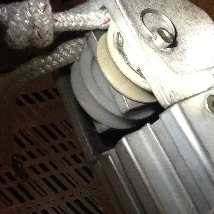

Hello All
The main sail's reefing lines are routed through the boom. One set of shives is missing and the others set needs replacing. It is very difficult to turn. The reefing line sheaves have an outer diameter of 1 and 1/2 inches, inner diameter of 5/16 inches, and width of 7/16 inches.
The remaining reefing sheaves are very difficult to turn. The sides of the sheaves are rubbing against the boom.
Based on the pictures and what you may have seen on your boat, do you think the difficulty turning is something related to age or are the 7/16 inch wide reefing sheaves too wide for the space available?
