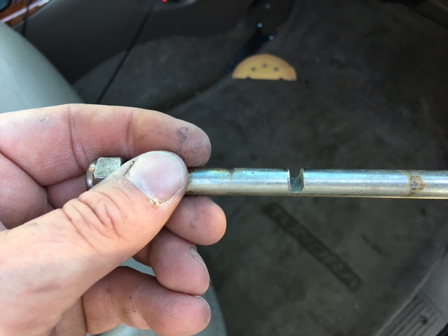

1/2" was too big. The slots the rope comes through are just about 1/2". I dropped back to 3/8" and am stuck with $300 worth of halyards. Oh well. Next time I will spend the money on better line, not bigger line. Three of four of the sheaves were fine. The bronze bearing was stuck and cracked in the fourth, but I only needed three so I just put the fourth aft. I cleaned up the sheaves with a wire brush on a drill, greased them and re-installed them. Note to everyone. You should drop your mast soon and inspect it if you never have, especially if you still have wire halyards. Mine had nearly sawn through the bolt holding the tangs for the side stays on. Wow.
23,899
Inspection is always the key to finding a problem. Looks like the wire halyard has been wearing on the pin. You caught it none too soon.
