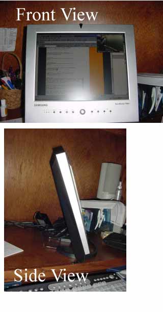

We use a Samsung 150MP 15" flat LCD panel ($400-450 (w/rebate)at Office Depot and a DVD player from Farm & Fleet ($88). The DVD player fits anywhere and the flat panel can wall mount or stand on an shelf. Very adaptable for the boat The DVD is about the size of a cigar box and the flat panel is a good size for the boat. For the winter we have the monitor home hooked up to the computer and cable TV and can do PIP of computer and TV or TV alone. Also has inputs for any videp source. If you have a laptop use it for the monitor on the boat. Both can run off 12v (minimal power requirements for both) or shore power.

Steve - there is an included 110 - 12v transformer that powers the flat panel from shore power. The panel only has 12v input so I took the flat panel's "wall wort" to Radio Shack to get the proper 12v connector and wired it directly into the TV breaker on the 12v side of the panel on our 380. Also ran the power for the DVD to the same breaker. The panel fits neatly in the book shelf above the nav station and is held down by a couple of brackets. We only use 12v power for the "entertainment center". I think that the factory installed entertainment system from Hunter they are now selling on the big boats is maybe $1800 or more. But the Bose surround sound is supposed to be pretty impressive. To me it is way too "power boatie" to have on a sail boat. John

Steve - what I got from RS works for me last season. I had to buy a two pack. I can mail you the extra one if you want it. It will just kick around until I lose it. The supplied power cable is not too hefty so 2 amps would probably do the trick for the connector. I got the connectors separate and made up my own patch cable for the connection out of 16 ga. marine wire. The breaker serves as the fuse. John
