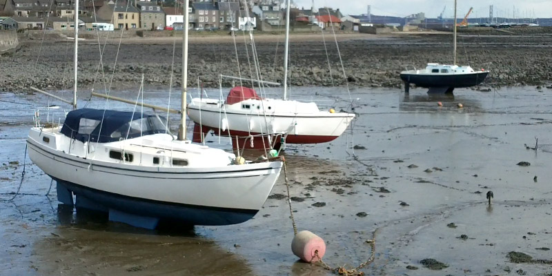

I'm not sure about the brand, but I've seen sailboats with twin keel, one on either side, so it can somewhat be left out of the water

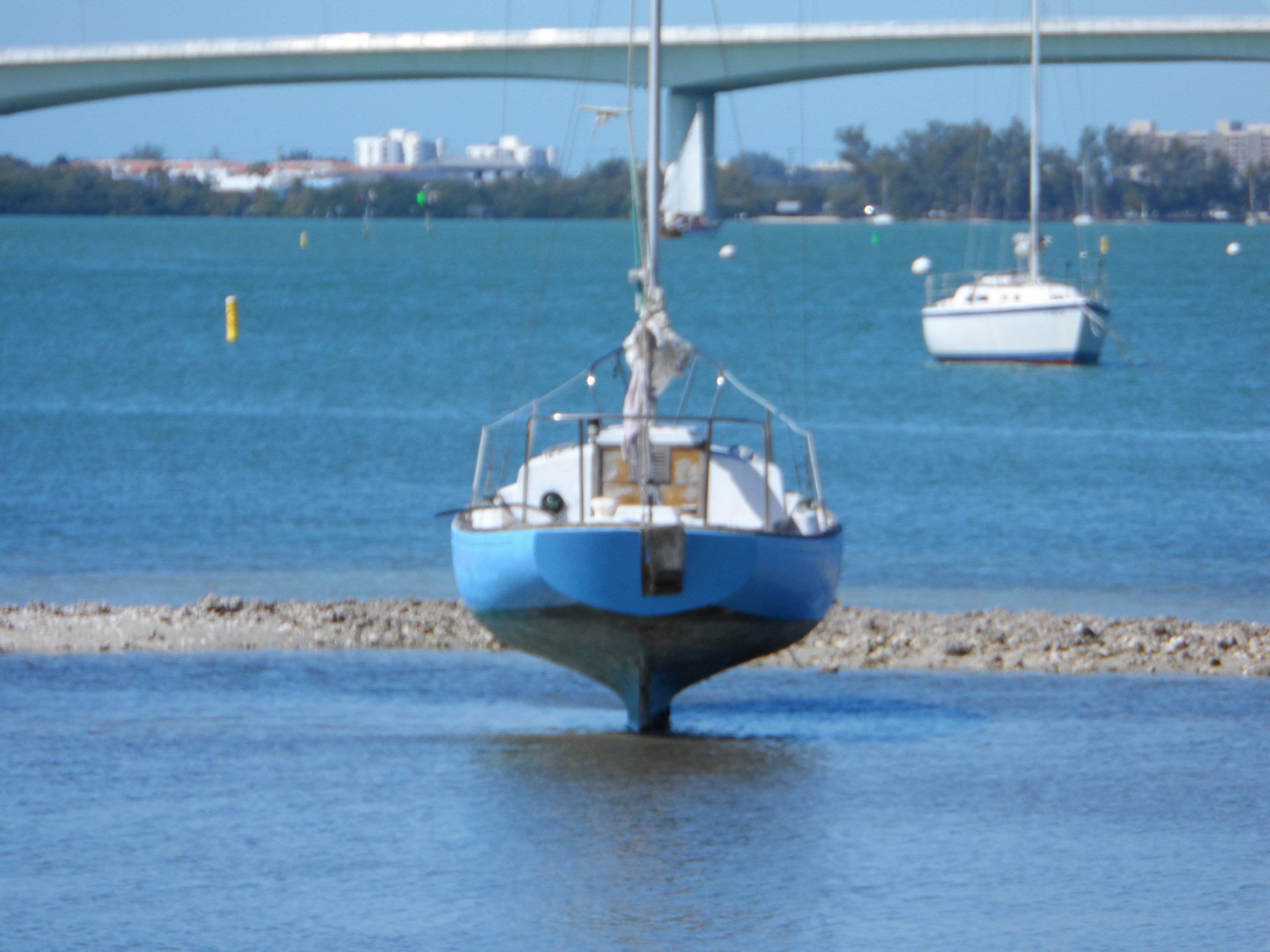

I have no personal experience with them but a twin keel might be worth looking into. They are less popular than others but I have seen some in your size range around.

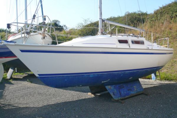

Wells Marine, a British builder had a series of twin keel boats that started at 18' (Alacrity). I had the 20' Vivacity, which was a good boat for bay sailing (Sandy Hook, NJ), but I've also seen some in the 23+ range.

The Westerly Pageant and warwick are both twin keel boats. Several for sale in FL. and was one in Lake Geneva Wis.
