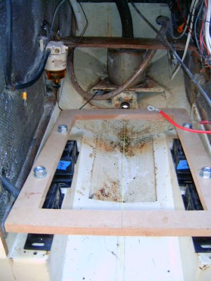

I'm in the process of repowering and am looking for advice. The original brass drive shaft shows .006" of wear and some scoreing at the cutlass bearing, but not to deep. At the stuffing box it is worn about .015" The shaft is true & I'm replacing the cutlass bearing. Should I reuse the shaft?
