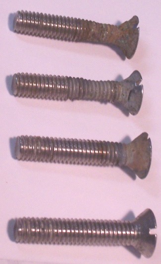

Previously there have been some posts regarding the shaft strut and replacing its bolt fittings.
A few years ago when I replaced the cutlass bearing I also pulled a strut bolt that had a very slight rust water tell tale in the h28.5 aft qtrberth pocket.
If you have no idea when/if these bolts were ever replaced you may want to check them on next haulout.
It was interesting to see how one 20 year old bolt was so compromised. I pulled all of them and found 3 or 4 in varied states of corrosion. A picture of the four follows.

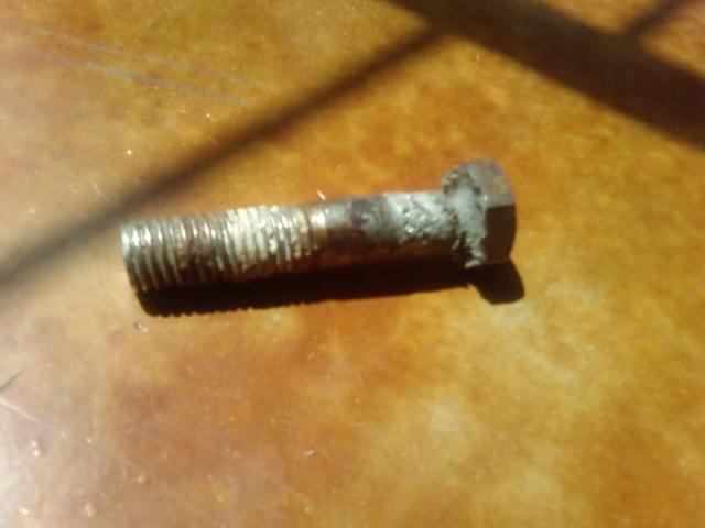

Crevice Corrosion On Stainless
