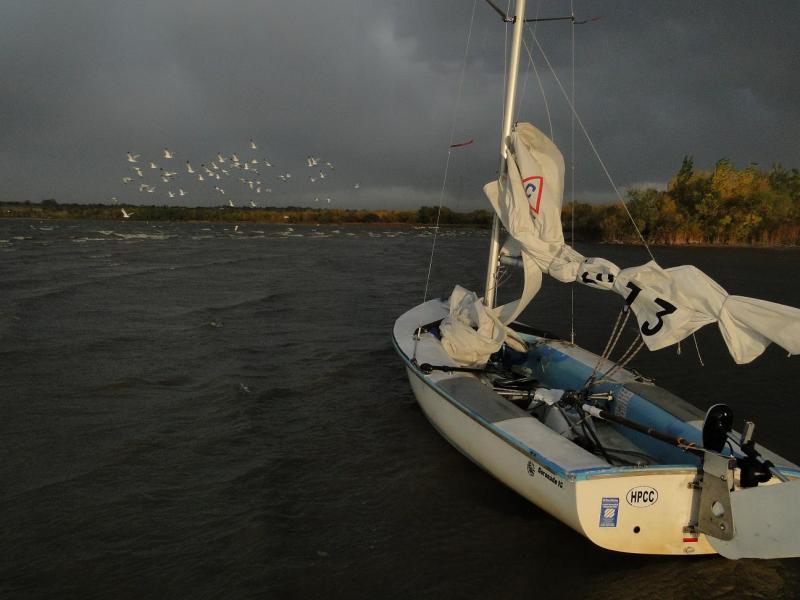

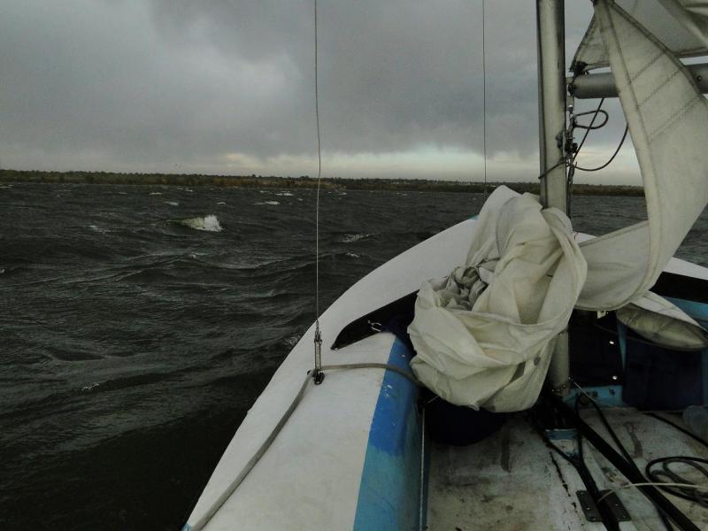

This trolling motor has got me home a bunch of times in some fairly good wind but last fall I found its limits. This day a wildly fast October front came through and I got knocked over - would have probably turtled the boat except for the mast float at the top. I got the sails down, had the centerboard down and with the electric motor, just could not get back to where I had left the truck. This was some fairly big wind, you can see in the picture. I had to leave the boat on the opposite shore and hitch hike back to my truck. Came and got the boat the next morning - of course the temps were below freezing.
I still almost exclusively use this electric motor since I have that boat to sail but it does have its limits.. I’m thinking of buying a 2.5 hp 30 pound gas outboard for it for times when I might want to motor some distance, use the electric motor when I want to sail fast.
