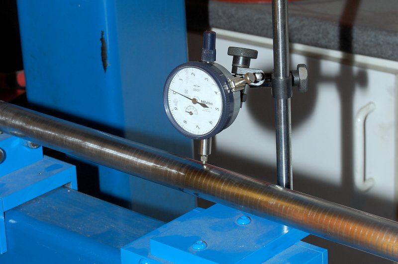

Now that we have the shaft out, the yard is measuring the runout at .003" at the center. The shaft is about 7 ft long. What do you guys think about the runout? Should I have it sent out to be straightened or is .003" at the center ok?
