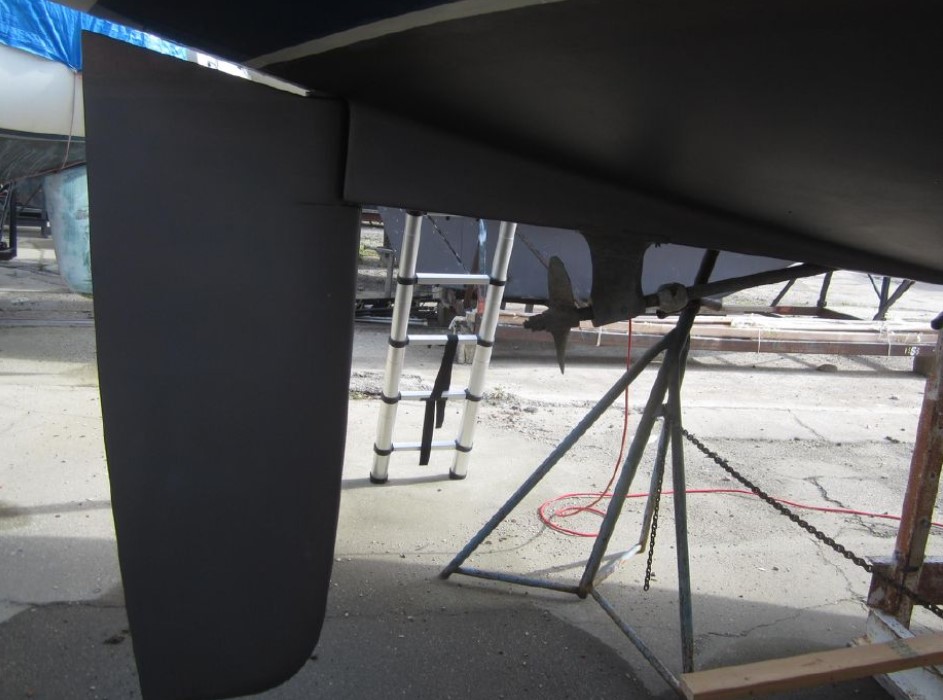

I'd side with Alexco, move the boat to gravel and dig a hole. The rudder post is longer than you think.
Jul 26, 2009
291
I had my 28 done 4-5 years ago and it was a straight forward inexpensive job. No, rudder was not pulled.
Interesting, the geometry of our boat is very similar to what's shown above (which is an '84 O'Day from YW). There's no way our's would have cleared the rudder without dropping it. As an aside, our original shaft was bronze and we replaced with SS.
