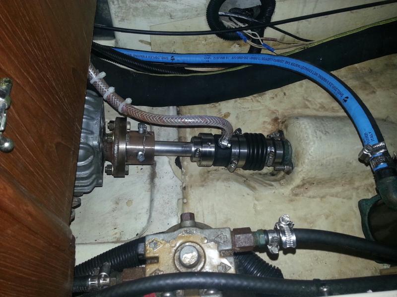

Mine looks exactly like this one......;

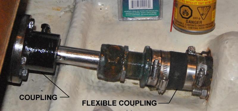

was wondering about flex couplers.
You may already have a flexible coupling in place as shown in the attached picture ........... the beefed up rubber hose which is between the gland and the shaft log. It is the simplest and most reliable flex coupling going (always assuming periodic inspection).
Placing an additional flexible coupling in here would allow for flexure at two points which would not be good.
