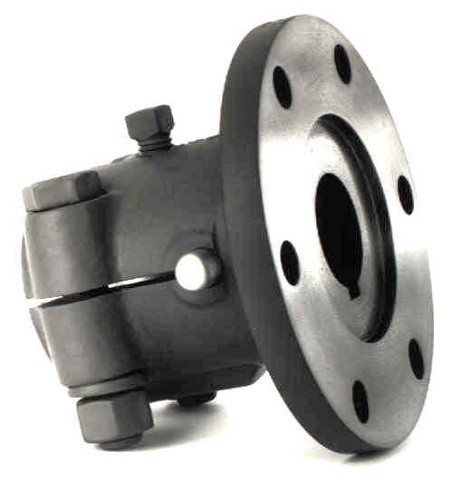

7) If you can, I can't I have a v-drive, don't replace the coupling with a solid coupling and instead replace it with what's called a "split coupling". This will make future removal and re-install much easier. Even with a split coupling you should still have it fitted and faced after removal. The $65.00 +/- is well worth it.

You could have also purchased a split coupling for only $74.00!
Yanmar 4" Split Coupling (LINK)

Every price I checked on a split coupling was $95 or more. I would rather use stainless though instead of something that's going to rust and degrade so quickly.
