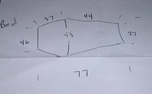

We measured the matteresses this past spring and decided to buy a fitted Queen size set for the fwd cabin, and to wait on the aft cabin as we currently don't sleep there. Both matteresses measure appox 6" thick. The matteress in the aft cabin is 54" wide measured from aft to fwd. Measured from port to stbd at the aft side it is 78". From port to stbd at the fwd side it measures 86". The matteress in the fwd cabin measures 77" from fwd to aft along the center of the matteress. At the fwd end, it is about 27" wide measured port to stbd. At the aft end, it measures 46" port to stbd. At the widest point, the matteress measures 58" port to stbd. This "widest point" occurs 37" from the aft corners and 44" from the fwd corners. I've attached a rough sketch of these dimensions for the fwd. matteress. Happy sewing! Tim Brogan April IV C350 #68 Seattle

:) Thank you Jack, Barbara and especially Tim for the detailed info. I'll get right on this as my winter project. Happy Thanksgiving.
