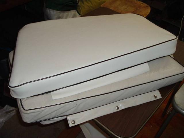

Will you use the original foam and bottoms? The PO of my boat did that and it came out well although I am not crazy about the fabric color and design. These cushions were done with top corners rolled over to the bottom. In other words no welt except at the bottom. And, of course, a full-length zipper on the back makes it much easier because you can finish it inside out. And so much easier than a top and bottom welt like the cockpit cushions I made.

Also, use piping along the edges. It'll make the difference for whether they look homemade or professional
