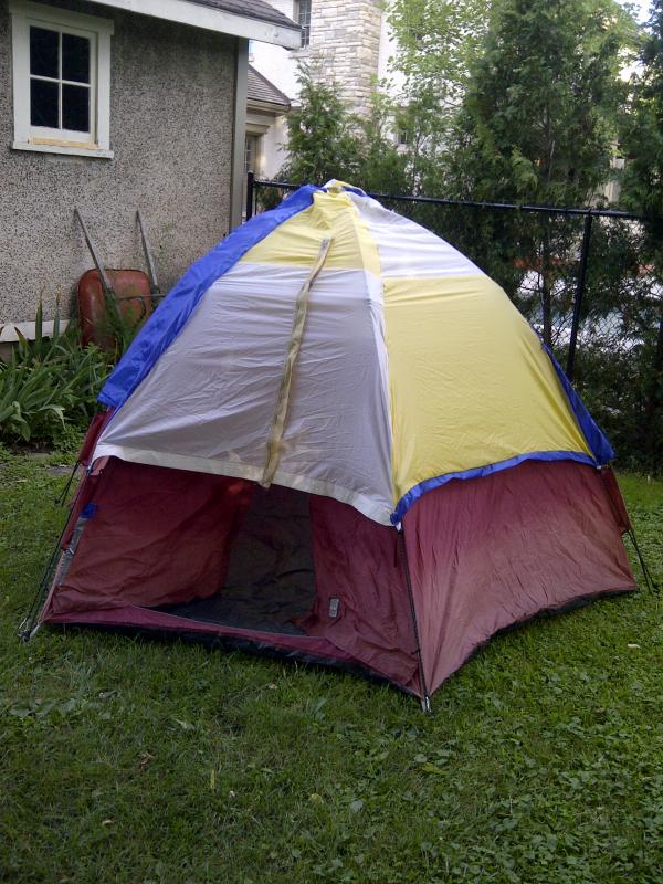

I've had good luck with my old Singer Stylist 534. It was built back before the invent of plastic gears and is one tough machine.
I do wish it had a walking foot! I end up kind of pulling some materials though it when I'm trying to sew too many layers of what ever I put through it.
I mention the "what ever". We beat this machine! My wife sews about 15 sheets of paper together for little books. I sew marine vinyl, Velcro and sail cloth.
I wear safety glasses when I sew because I break a few needles each time.
I have $80 invested in it and that includes the $60 repair fee from when I tore the bobbin gears out of it.
The tent fly was my last project. Not my best work but it works.
