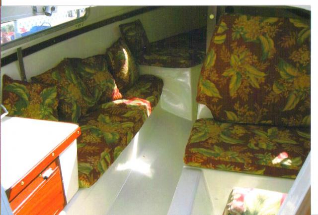

Ok, I got it, a sewing awl will get the job done.
The machnine I have is an industrial SunStar, very heavy duty, just won't zig zag. Here's how my cushions came out. Did all the sewing myself.
