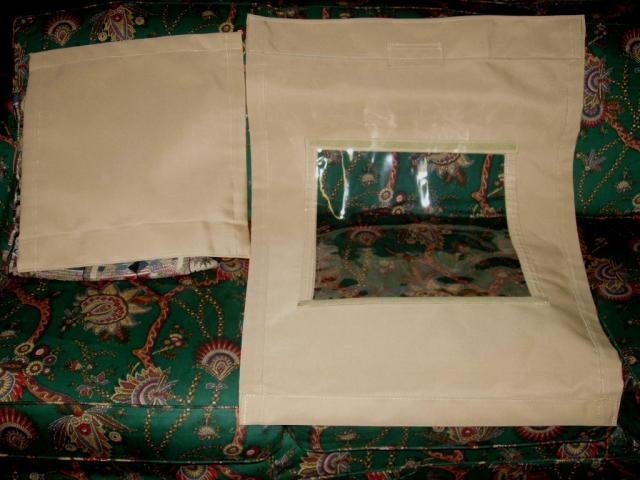

The prefered method that I used is to do a 1/2" fold and then the 1" fold using the 1/2 fold to hide the raw edge. For the top section I used a 3 layer fold over about 4" to give the top some body. Also, I have found that snaps are not a probem using even up to 4 & 5 layers of Sunbrella. You will notice that I have designed a window fir the hatachcover that can be removed during the day and installed when more privacy is required. Another feature that I constructed is the reinforcement patch that you will see on the top center of the cover that is used to eliminate the chafing that will occur from the hatch lock assy.

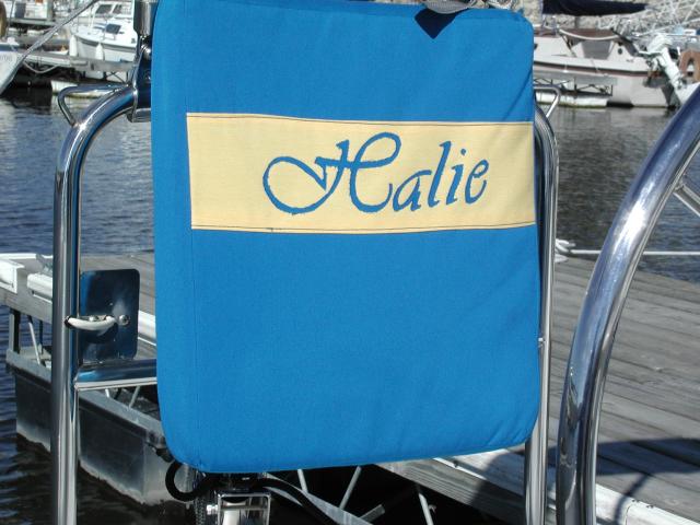

This is the Sunbrella project I did. The fabric weight on this project was light enough that it sewed like any other fabric.
The boat name matches the graphics on the side of my boat.
The inner cushion is one designed for the marine environment.
For boat covers and other projects that cover large areas I connect two peices with french seams (like seen on jeans) Fold each seam over 1/4" and then slide them into each other. Use two stitch lines, one on each edge.

To answer a few of the questions I use 3 snaps at the top which are attached to front side of the hatch pull. The sides are reinforced to give it some structure. At the bottom, I have sewn in a 3/8" galvanized rod with the ends protected from chaff with topgun sleaves, this I have found holds the bottom on the outside ot the compainion way track. For the window that is attached with Velcro. As for the sewing machine, I took the plunge and purchased the Sailrite LSZ-1 at the last Annapolis Sailboat Show. If you check Harbor Frt's web site you will also find an industrial unit that they handle but, I have not seen any reviews on the unit. Another reason that I purchased the LSZ-1 was that I was recanvasing this year so it came in handy for making several of the pieces. As for thead I have been using the UVR Polyester V-92 thread and perhaps sometime I will try the Tenara thread.
