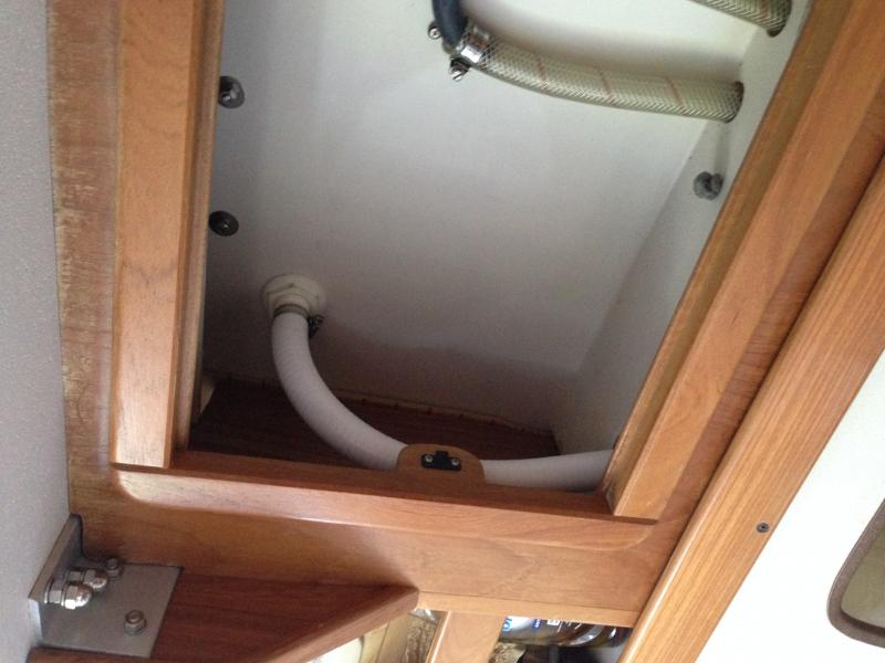

Where does the holding tank air bleeder hose likely vent over the side? The hose from the top of the tank disappears under the cockpit sole so I can't complete a physical trace and I don't know what to look for on the exterior of the hull for the vent.

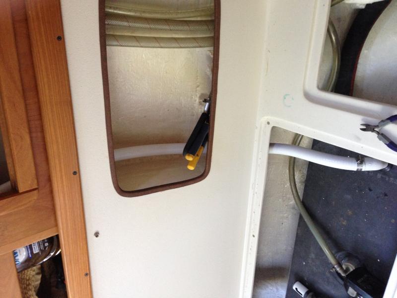

The effluent holding tank is located port side midship - not stbd - under the saloon settee between the head and the galley. Vent hose runs from top of tank aft between batteries and engine and under cockpit sole, which is why I can't trace it without being able to slither in there like a lizard. The only hose I can see that goes topside connects to the pumpout port. Looks like this is a custom installation and I'm going to have to rely on my own ingenuity.

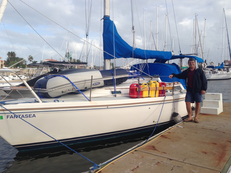

My vent is visible on the outside if the hull just below the yellow jerry can.

I checked, and the vent hose runs aft under the cockpit sole as I remembered, not up through the locker to a port-side vent. The portside stanchion doesn't have salt shaker style holes in the base, so a PO has in fact re-routed the vent toward the stern. Now will try to isolate one of the transom vents to the holding tank hose.
