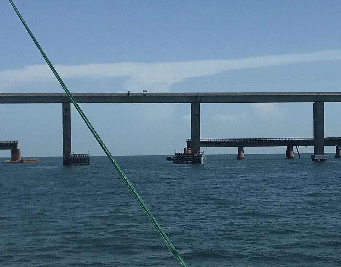

I have heard conflicting answers to the following question. Can I get my 2006 Hunter 45cc, with in mast furling, under the 65' Seven mile bridge?
Any 45cc owners out there who have made the trip? Some wind instruments on top, but nothing elaborate.
