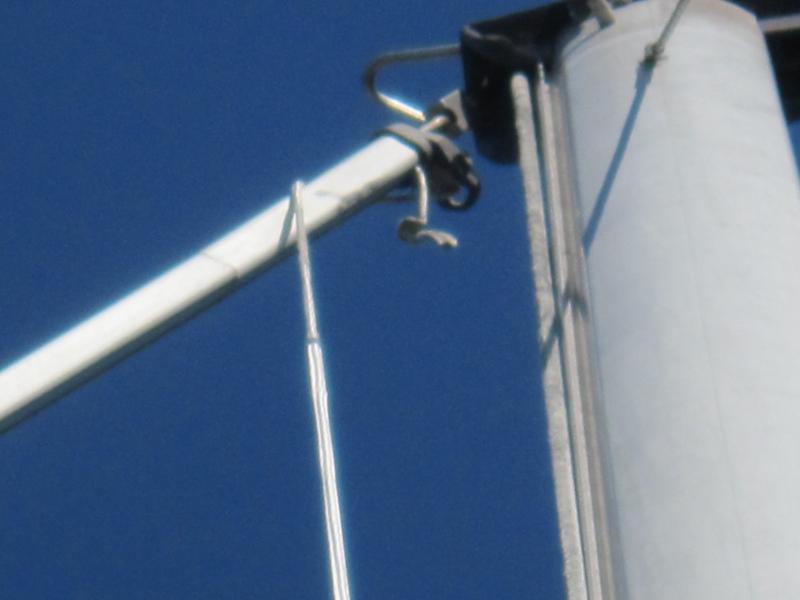

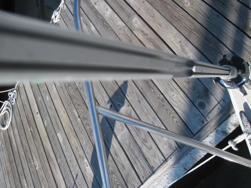

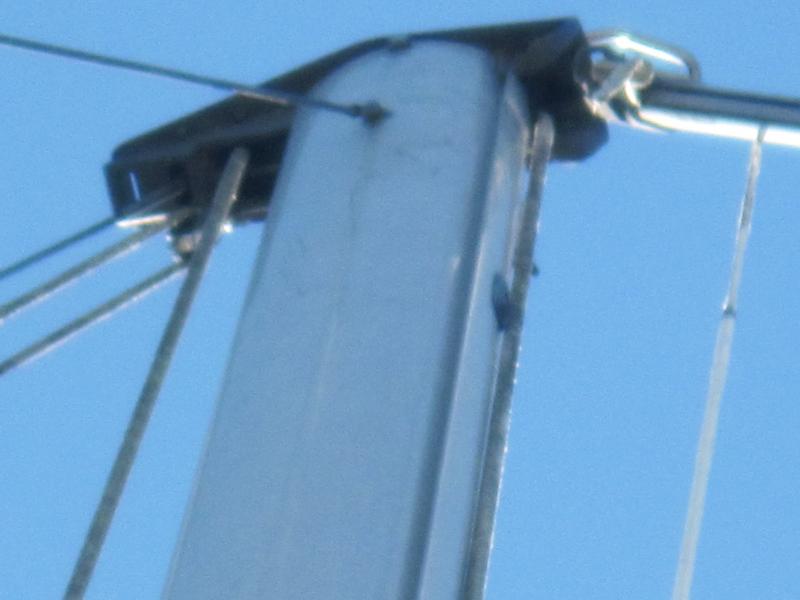

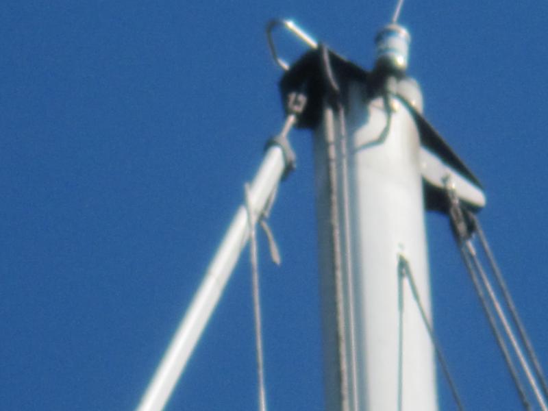

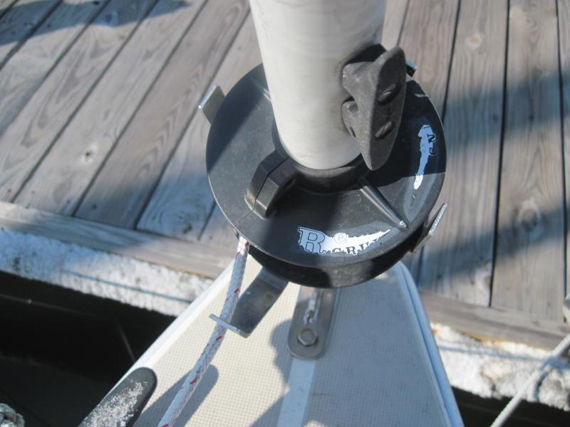

Pics of Unknown Roller Furler
Here are pictures of the unknown roller furler. Several people hae told me it is probably a CDI furler - but I don't know one way or aother.
One person at the marina indicated the 2 groove extrusion had one for the jib, another for some form of slide to attach to the sail to raise it. Aother person from another list referenced a CDI Reefer II. This is most promising information yet, but I don't have either of the cam activator (attaches to the Jib Halyard) or the other piece that attahces to the jib.
Does this seem feasible? Does the line already there indicate something may just be pulled to the top of the track?

Re: Pics of Unknown Roller Furler
I have the same boat with the same set-up. The CDI uses an internal halyard that rides in those two luff grooves in the foil. At the top of the foil extrusion there should a cap with a roller in it. Across this roller goes the halyard returning down towards the drum. There are two slots in the foils near the drum. The jib halyard goes up one groove and down the other. It exits the foil near the bottom and doubles back through a block and is tied off to a cleat. With this set-up your jib halyard is contained inside the foil and the sail when it wraps up eliiminating the need for a top swivel. Your halyard must be small enough to ride in the luft groove and long enough to be twice the length of the head foil.
Hope this helps.
Ted

Re: Pics of my roller furler
Tedsbeds - that sounds pretty iffy... There is no line that came with the boat that is small enough to ride up one side of foil and long enough to extend down other groove back to deck level...
What do you do with the halyard (twice the length of the foil) when the jib is in place? That's a lot of line to have to place at the bottom of the drum...
After looking at your pictures this is exactly what you have. One end of your halyard looks to be stuck up near the top of the furler. You can actually slide the whole furler assembly off the head stay with out taking the mast down. The mast must be secured from falling with a temporary head stay such as the main halyard cleated off to a bow cleat. But for sure your halyard is stuck up the head foil furler.

If you look at the parts manual they list a 1/4" x 65' for the halyard. I had the same rig on a Catalina 25. Off the top of the furling drum was a small set of double blocks. I would run the halyard through the blocke and back up to the cleat and back down to the blocks again to take up the extras line. Once you hoist and lower the sail you know exactly how much line you need for the job.

'Stuck near the top of the furler'. So it is not permanently attached at the top of the furler? Thw other part - 'halyard needs to be twice the length of the furler - mine is only from top of furler to near deck level. Maybe prev owner decided once raised, he didn't need the extra length and cut halyard to be single length of furler? Sounds plausible - once aloft, how often does it need to be lowered?
Now, how to get it from top of furler w/o dropping mast or taking the headstay loose?

The 1987 272 would have had a Cruising-Design Furler, but NOT the Flexible Furler. This was the furler they made prior to introducing the FF.
The Flexible Furler had a high-tech plastic extrusion, the earlier furlers had a multi-piece aluminum extrusion.
It could be that the 272 had a CDI furler that was setup (halyard) like the FF, but used the extrusion and drum from the earlier (more complicated?) furler that I describe above. The 272 originally used the Cruising Design REEFER (#1). I have attached a pic of the #1, Does this pic help at all? Hope it does!
Hope I didn't confuse the matter even more! I found this on the CDI web site: Reefer I or Reefer II?? -- The designations, Reefer I and Reefer II refer to the method of raising and lowering the sail, not the size or the model. The Reefer I uses an internal halyad that cleats off at the furling drum to raise the sail. The Reefer II uses a locking halyard system. The boat's jib halyards is used to raise a cam activator and the sail which locks at the top of the luff extrusion. Once the sail is up the halyard and cam activator ard removed and stored away from the system.

Our 272 is exactly as described...but we tie a 3/16 inch dia. line to the
halyard as described below....it is necessary to hoist the sail on the furler
extrusion...this allows you to pull the sail up and or down...it then is untied, and the original halyard is tied off to one of the cleats near the bottom on the furler (there are two just above the drum)...then we put the extra line back in the dockbox until needed at the end or beginning of the season....all of this is because the original (Z-Spar) extra line (halyard) disentigrated inside the mast....or we would have been cleating it off on the side of the mast or leading it back to the cockpit....in lieu of a block on the furling drum...really is quite simple. Pat
