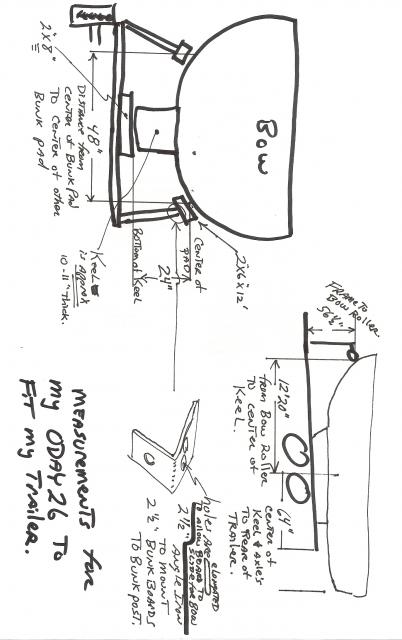

Jun 3, 2004
89
Oday 26 Lake Keowee,SC
some measurements for Oday 26 and trailer
