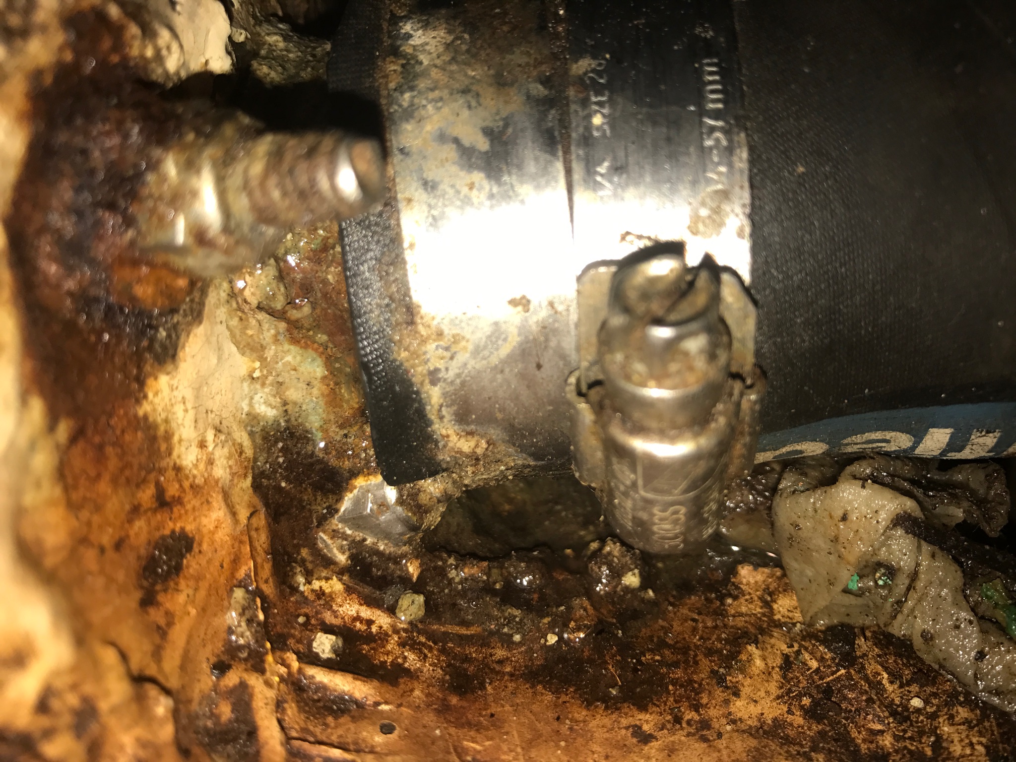

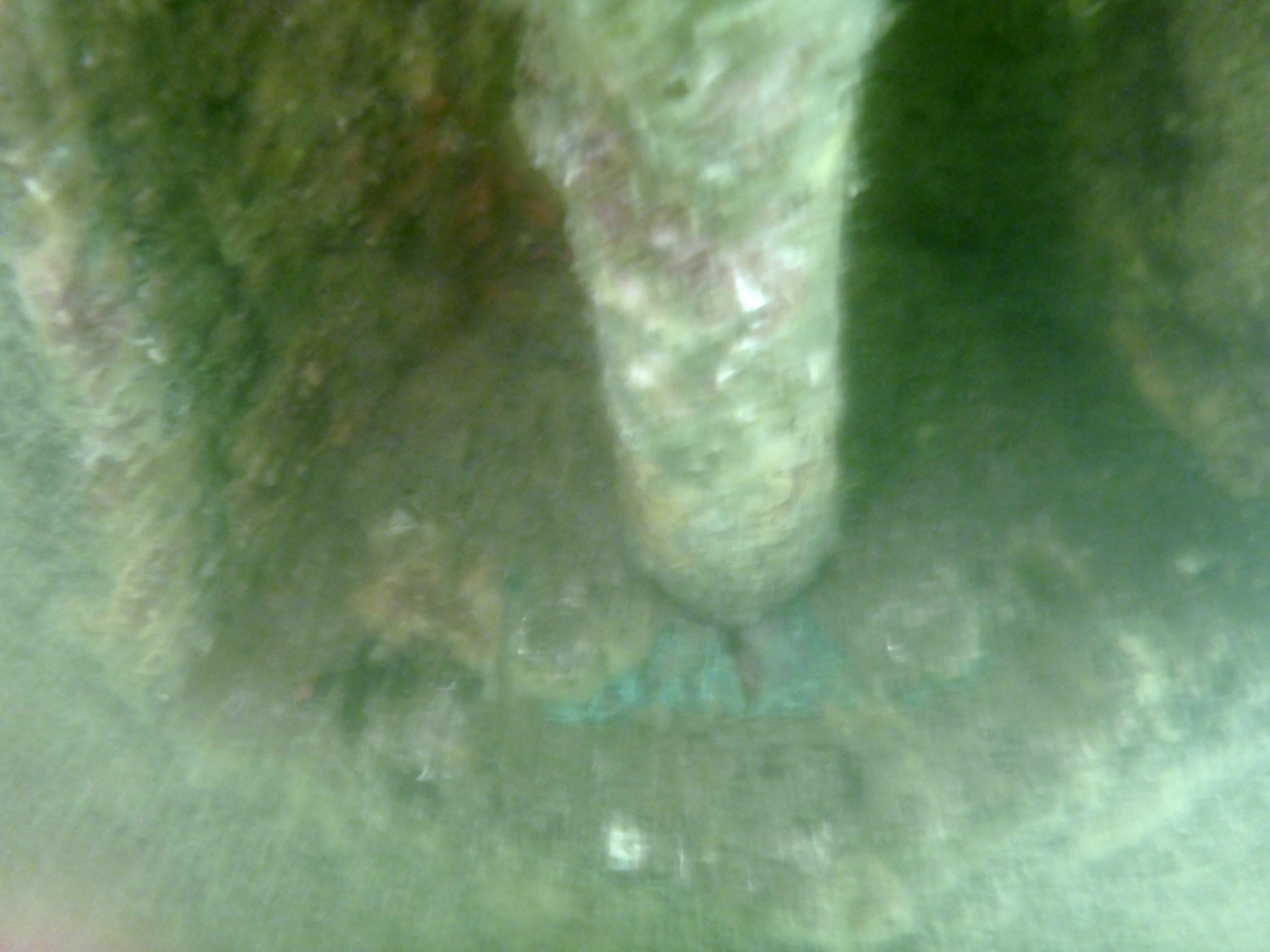

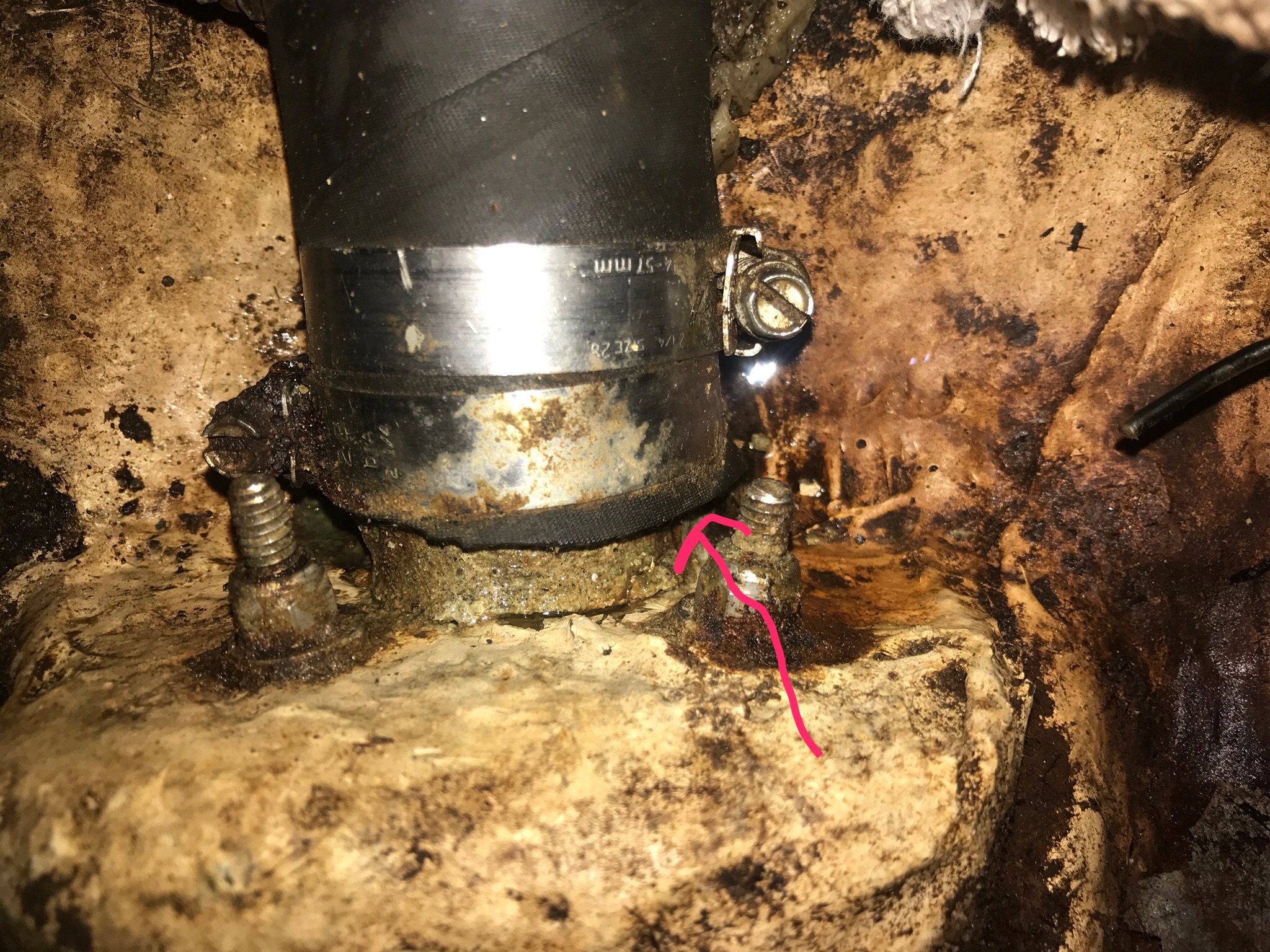

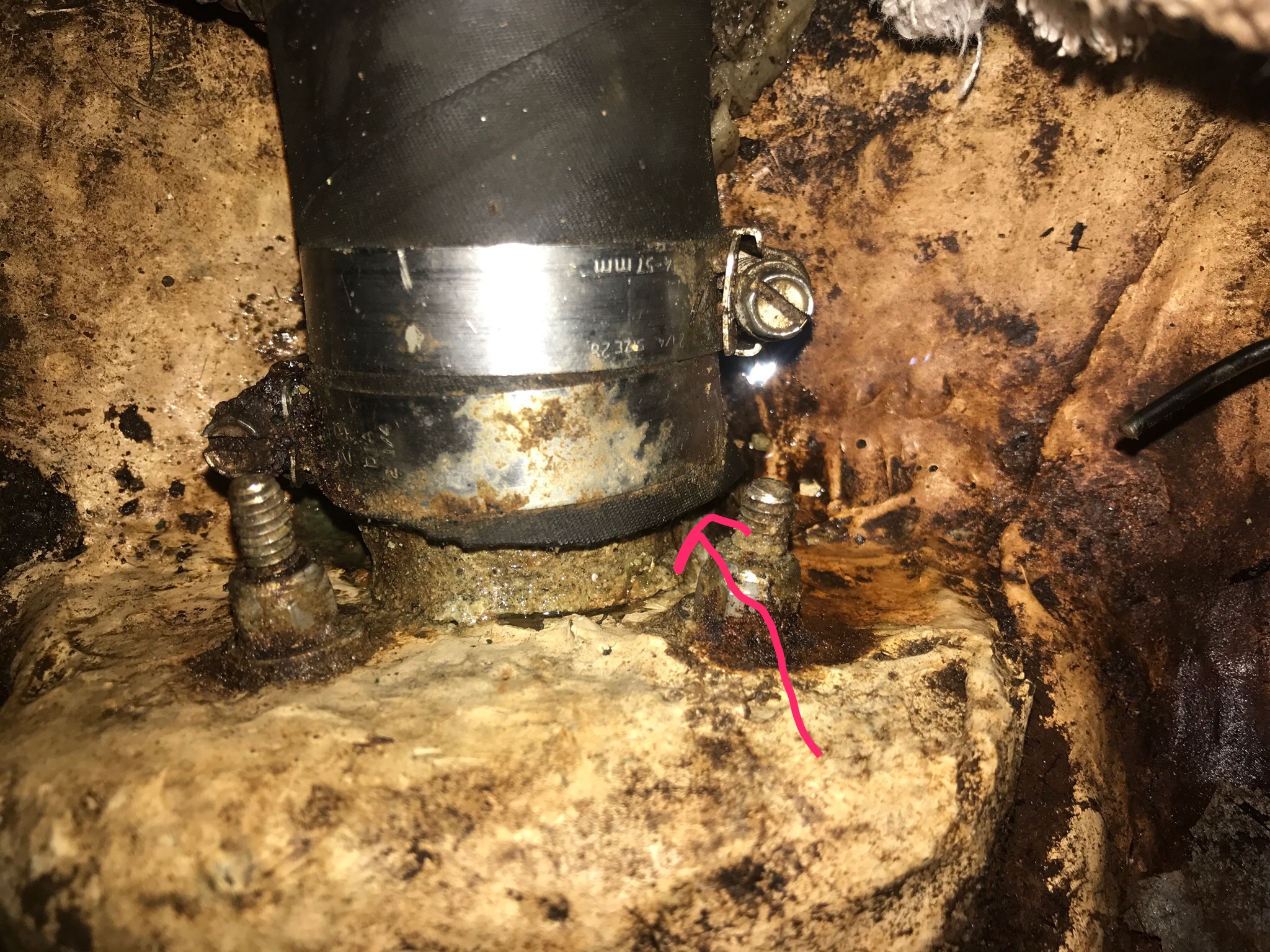

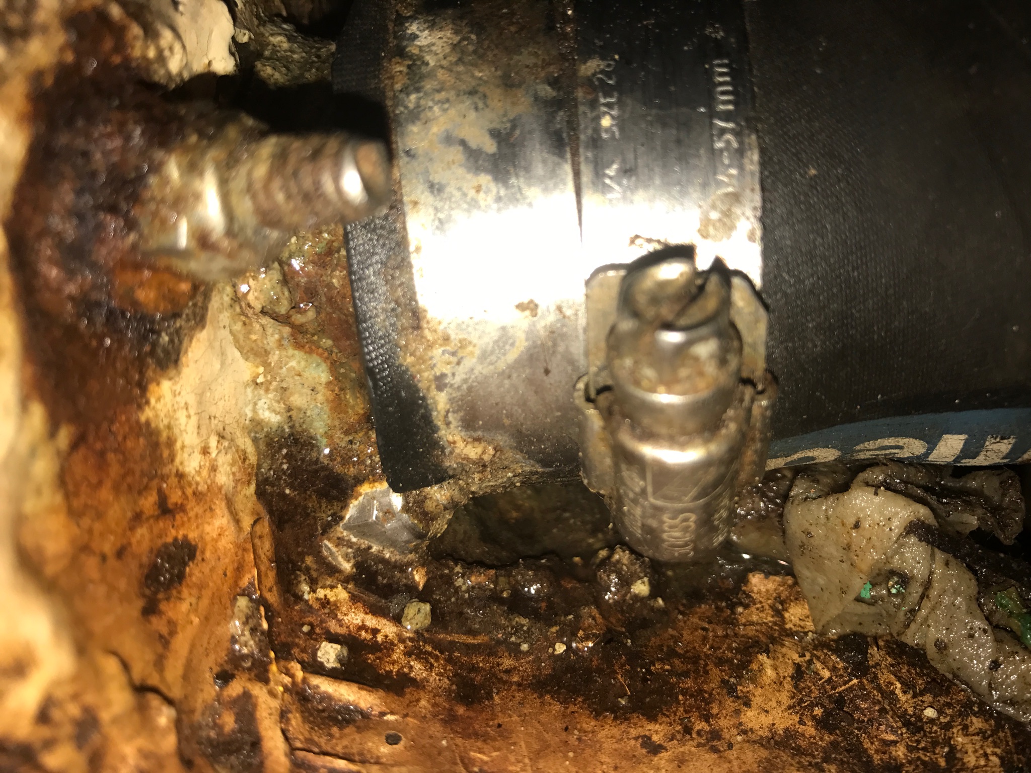

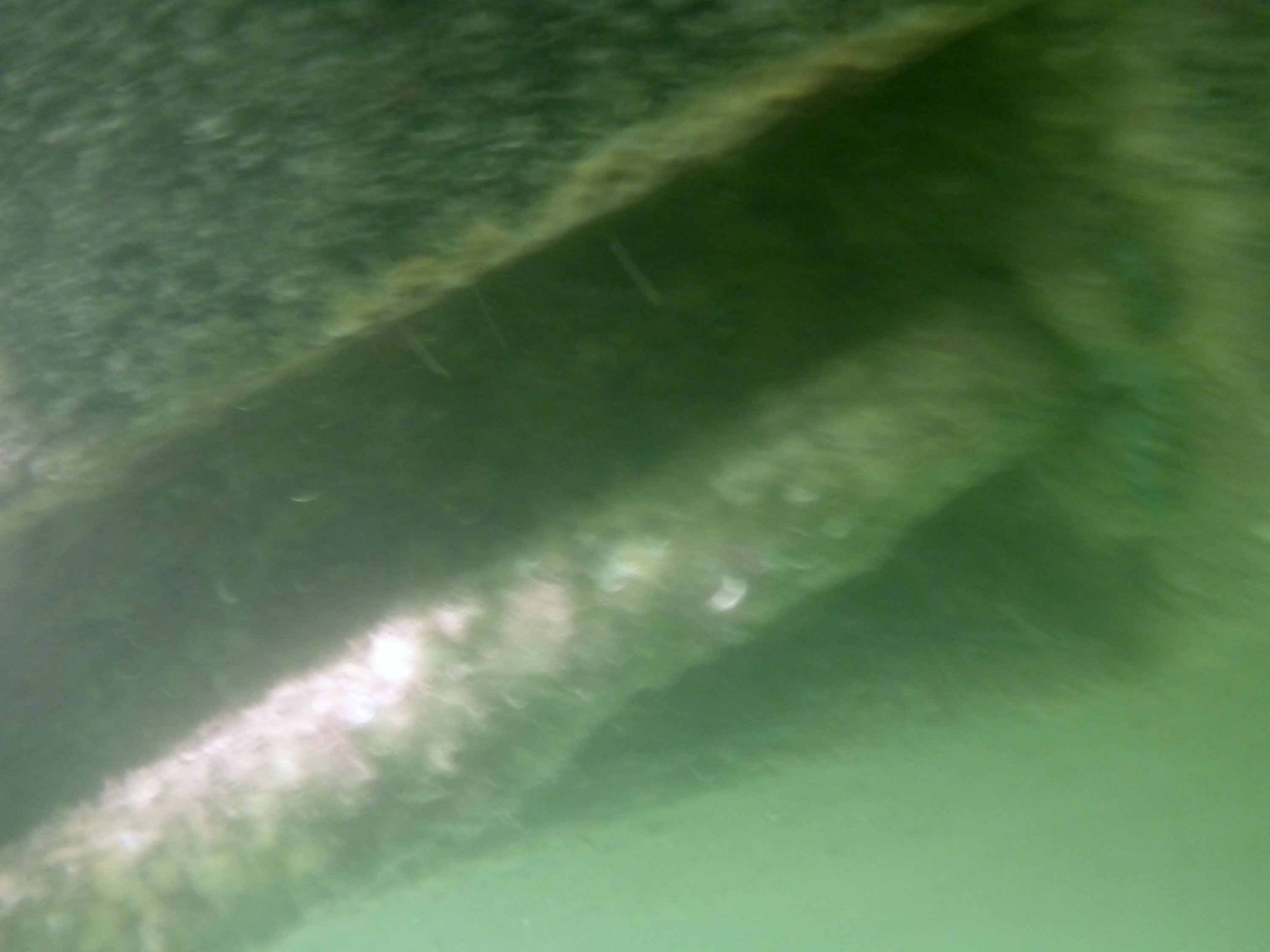

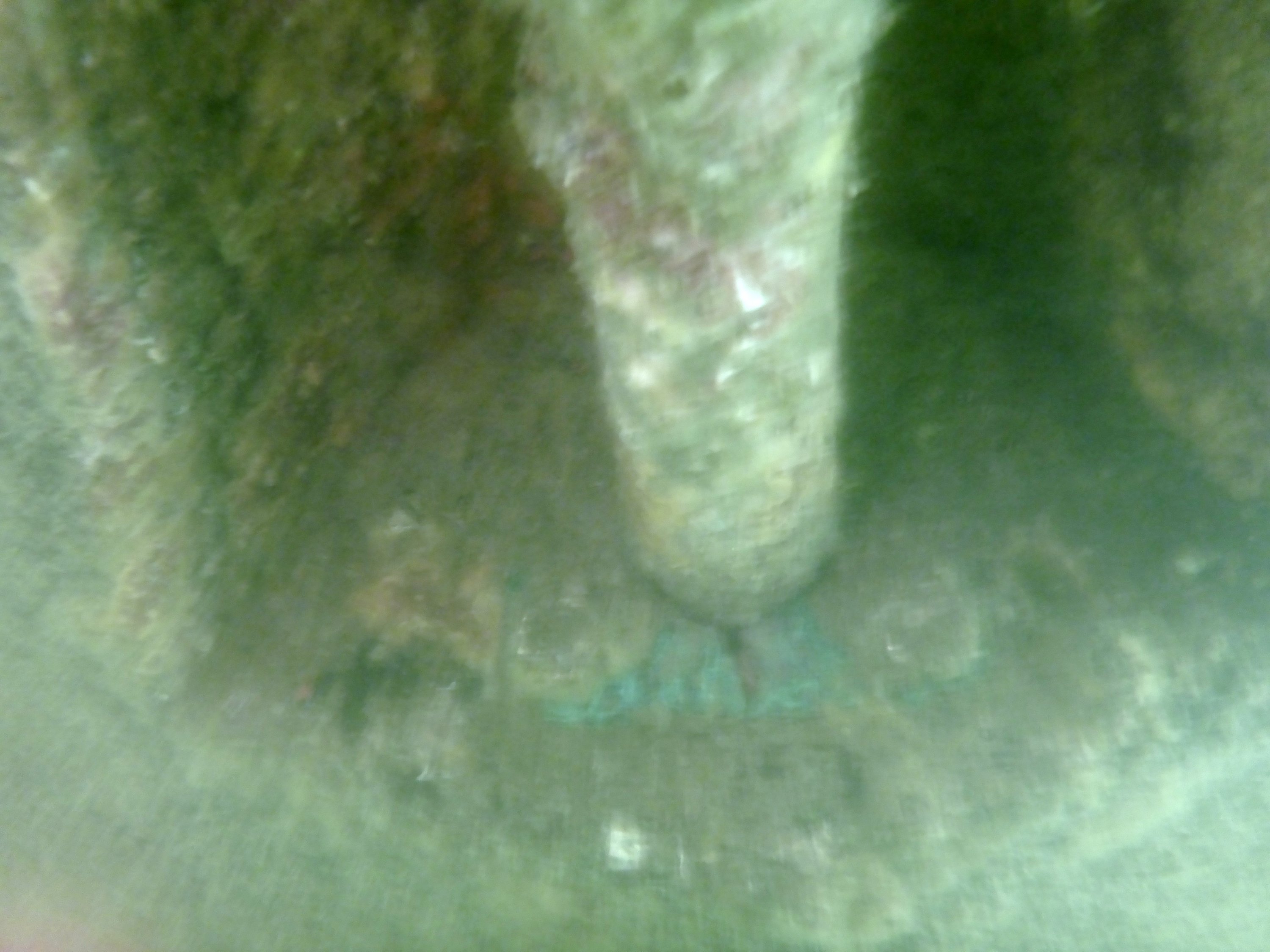

I have a leak between the shaft tube and the hose that connects to to the stuffing box. the bilge pump can keep up with it. I'm planning to get it hauled this week for repair but not sure what will need to be fixed. Could it just be the hose (proabably too easy). If it is the shaft log, does anyone know where you can get one. It seems to be square 2 3/4 or 3 inch (difficult to tell when I dove because of growth). The bolts appear to be 2 inches apart. I've scrolled through previous threads but I don't see what I need at Buck Algonquin. I attached picture 1 looking from above with arrow to leak. Picture 2 is from the side where the leak is. Picture 3 and 4 is from outside. Appreciate any advice you can give me!!

If you are going to pull the shaft, I would replace both the shaft log, and the stuffing box hose.
You should be double clamped on both ends of the hose.
I replaced my old bronze shaft over the winter. If you plan to keep / reuse your shaft, you will need to carefully remove the coupling. This was probably the hardest, most time consuming for me.
Once you have the coupling off, if you are lucky, you can slide the shaft out past the rudder. On my boat, I had to press the cutlass bearing out of the strut to get a little lateral play in the shaft.

I replaced both the shaft log through hull and the shaft log hose about three years ago. Unfortunately that's just long enough ago that I don't recall what the dimensions were, but it was a somewhat odd size fitting which I concluded was no longer made. I got the log hose from Buck Algonquin and ended up having a new bronze shaft log custom made by a local machine shop.

Replaced my shaft log a few years ago when I repowered. Had one machined out of SS. A bit noisy on a cold start but doesn't leak. The square part you are referring to is the outside end of the tube where it is bolted onto the hull.

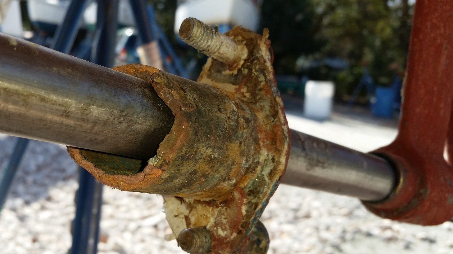

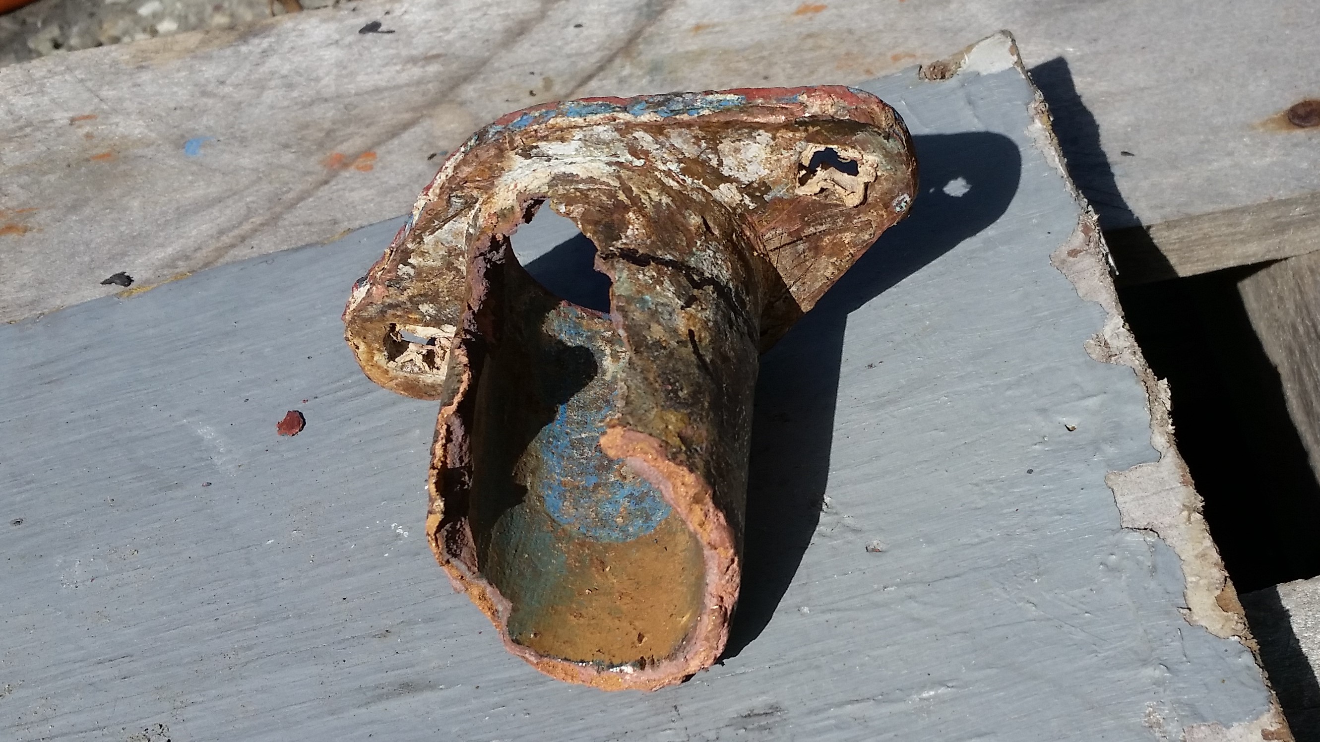

I had the same boat and the same problem (years ago). The bronze material had gone pink and in combination with the shaft rubbing on the log, the whole thing just cracked. We were not able to find a replacement part so had to have a new SS one made at a local machine shop.

Replaced my shaft log last year. It was not leaking,, not yet anyway. Here you can see the part after removing the two bolts and sliding down the prop shaft. Notice the pink color of the bronze and that the flange is on the outside of hull:
The next pic shows the shaft log after I tapped it lightly with a hammer:

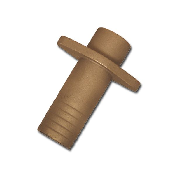

I replaced with a Buck Algonquin log. The dimensions were slightly different but worked nicely with the flange located on the inside of the hull:
