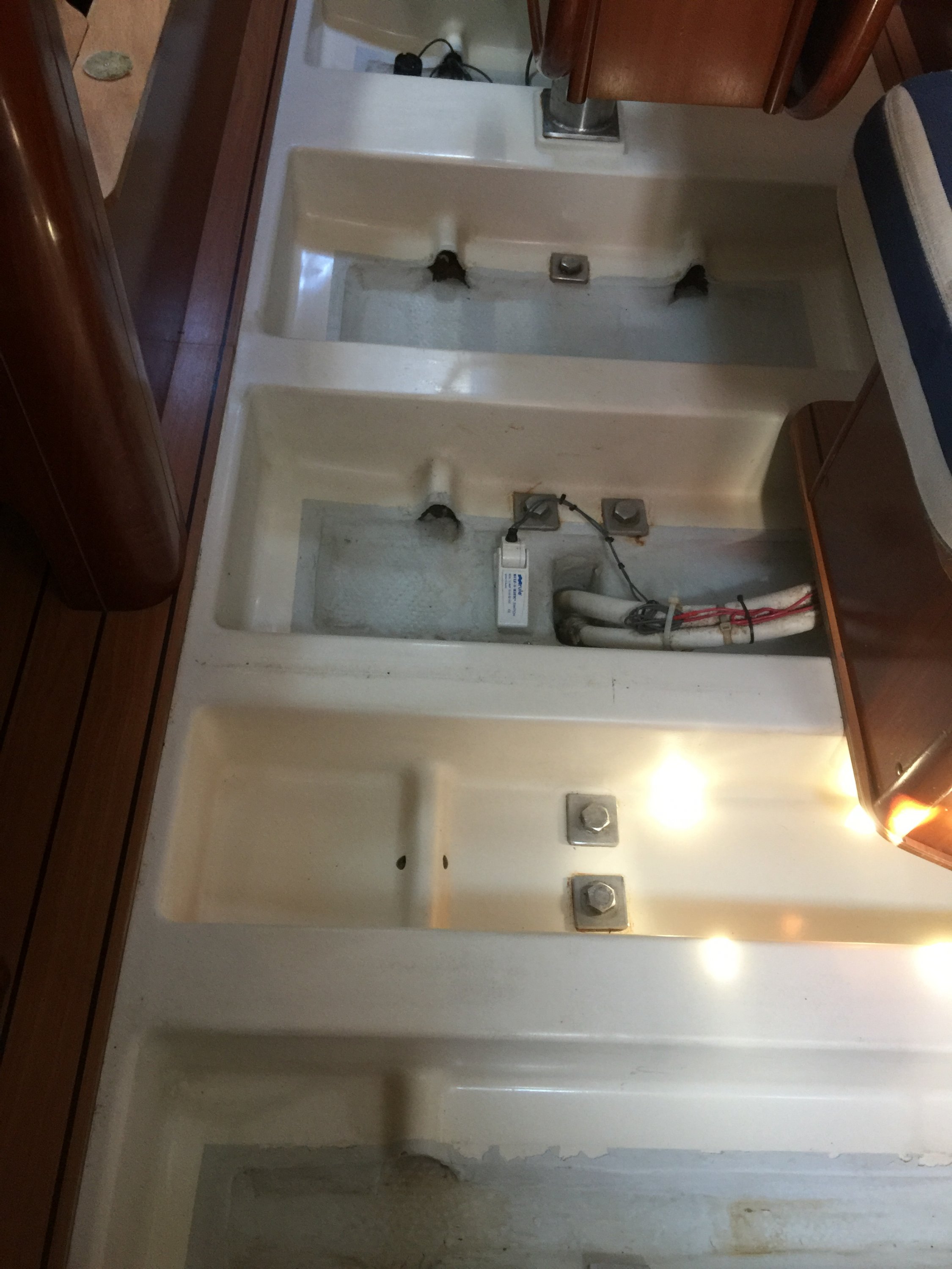

Here is the grid and a limber hole on the Beneteau First 36.7. That limber hole is absolutely open to the internals of the grid. Others are connected. The pan is solid glass. It is bonded to the hull in the low/flat areas, and the 'grid' is open space that is sort of interconnected. On the 367 before we race we play a game called drain the grid', where the entire crew stands on the aft starboard side of the cockpit while one person shopvacs out gallons of water from a strategic spot under the nav station.
Kestrel is a 2006, late in the series. Interestingly Beneteau issued an ECO (Engineering Change Order) in 2003 to increase the number of holes to help the water drain better. Seems in the earlier boats you were playing one of these kids games where you drive a marble thru a grid!
The good thing about the 367 is it is more a race boat and this grid is accessible everywhere. On the big Sense I can imagine spot where serious furniture would be in the way.
