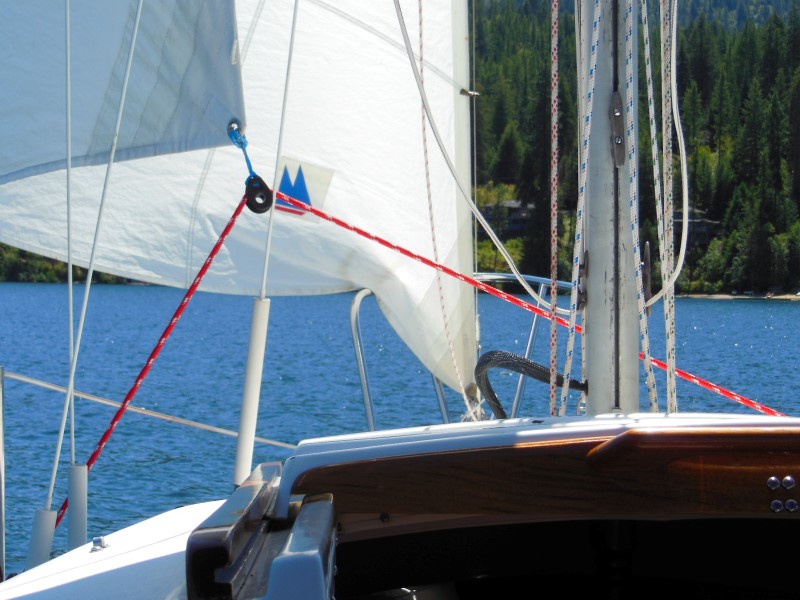

I also saw a fella in Orgeon who had self tacking gear done with line. I should have taken more pictures.

Hi Stu,
I might not have seen that particular boat, of course, but I’ve seen many, many rope only ST systems in person and online, and they all compromised the shape of the jib. Compared to contemporary system with curved traveler tracks in front of the mast base, they were poor performers,
the geometry of an all line system can’t do what a curved travel track can. Rope bridle ST systems are curved the wrong way and that makes it impossible to to get really good sail shape. Rope bridle St jibs work, but only “sort of”. With a curve traveler track system that has the approximate j dimension as the radius of the curve, you can do much more to get the sail flat and not have a hook at the clew, no matter what angle of attack
you’ve set it for.
