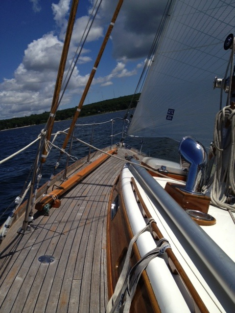

May 25, 2012
4,338
not a hunter, but. this is my system. track is behind hatch. the cabin top around the mast is over 3" thick and solid, then the wood base for the jib track conforms to the cabin with the track on top. the cabin top is very beefy in this area. the wood boom is my club footed jib boom. the goose neck clamps the the forestay with a cable to the deck. it pivots of course.
Likes: Tim Mills

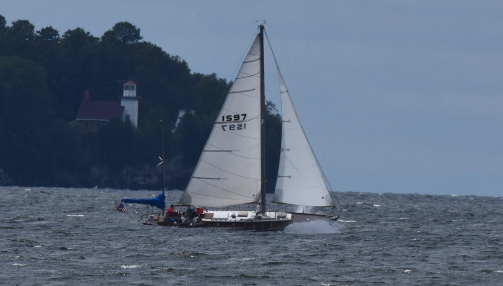

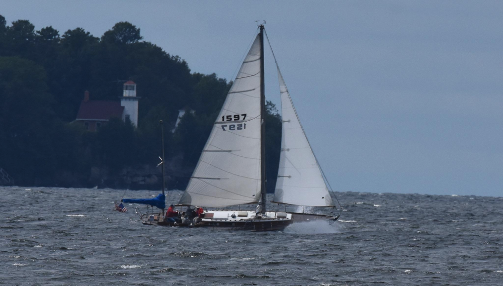

May 25, 2012
4,338
blowing 30 +, full main, club footed jib. it's a hoot to drive to weather all day. the main pulls really well, with all the cleaner air, with the slot so very open
Likes: Tim Mills
May 25, 2012
4,338
the thing to understand on aeolus is the cabin top is hugely reinforced in this area under the track and back around the hole for the mast
