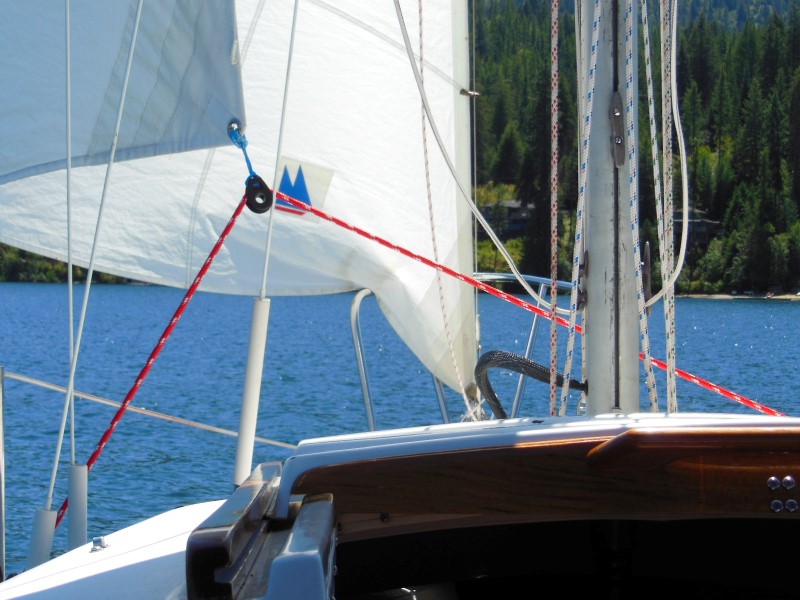

If you have any experience with a self tacking jib, please let me know what you think of them. I sail single handed frequently and would love the simplicity. Also, handling the jib sheets is a hassle when guests are aboard. I'm considering the system made by Selden.

Had one on my cruising cat. Put it away day two, tried it once later, and never pulled it out again. I will never have one. If you want or need to tack without handling sheets, sail main-only.
  • Too little area reaching.
  • Poor twist control off the wind.
  • Horrible shape if roller reefed.
These faults are very hard to get away from when the track is forward of the mast. The angles are all wrong.

Solings (27') use self-tacking jibs racing. They allow for very quick tacks; all the crew has to do is change sides. If you get one, talk to your sailmaker about a clew plate with several holes along the trailing edge. Attaching the sheet to the top hole is like moving your jib leads all the way forward. Attaching to the bottom hole is like moving your leads all the way back. Simple and effective.

You don't need a fancy pre-made setup to have a self-tacking jib. The original arrangement on our Soling was a curved 2" stainless steel pipe that we bolted to the deck on wooden risers. A stainless steel ring slid back and forth on the pipe, with a line tied to it that determined how far out on the pipe we wanted it to travel. A block was shackled to it for the wire jib sheet, which ran from the jib clew, through the block on the ring, and then forward near the base of the forestay to a through-deck block. The wire sheet then connected under the foredeck to a tackle that led back to the cockpit and a swiveling cam cleat. We got a lot of surprised looks at regattas, especially from the boats we passed. After about three or four years we upgraded to a ball-bearing car on a curved aluminum extrusion, similar to a vertical bend here: https://www.harken.com/en/support/tech-articles/curved-track/. You might want angled "L"-shaped aluminum mounting plates to hold it up off the deck, or blocks of teak might look good too.
