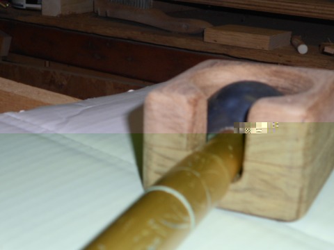

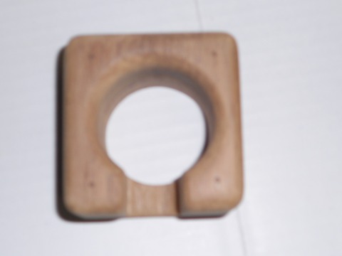

I also sail on a lake and have been trying to figure out something as well. So far this is what I've experienced.
Lock box: Doesn't work for our boat unless the tiller extension is mounted to the underside of the tiller. But along the same idea as the lockbox, I've been trying to find something that I can mount next to the stern pulpit base to quickly snap the tiller extension into. I'm trying something out now I rigged up, but I'm not sure it's durable enough to work long term or if it's choppy.
Tiller Tamer: The lake im on has constantly changing wind direction, so I found it was more trouble than it was worth feeding the line through it when I wanted to use it since I'd be constantly tweaking it anyways. And even when you loosen it, theres enough friction to annoy me (maybe not others). If the wind is consistant, I think i would use it more. It worked out that I installed the jamb cleats on the transom for the tiller tamer, because I use them all the time now to secure the rudder in place to deal with mainsail. I just keep one side tied off, and quickly give two three wraps around the tiller with a line and cleat it. Works great. But you need some kind of stop to keep the line sliding aft. I have a tiller extension clip about half way down the tiller which does the trick.
