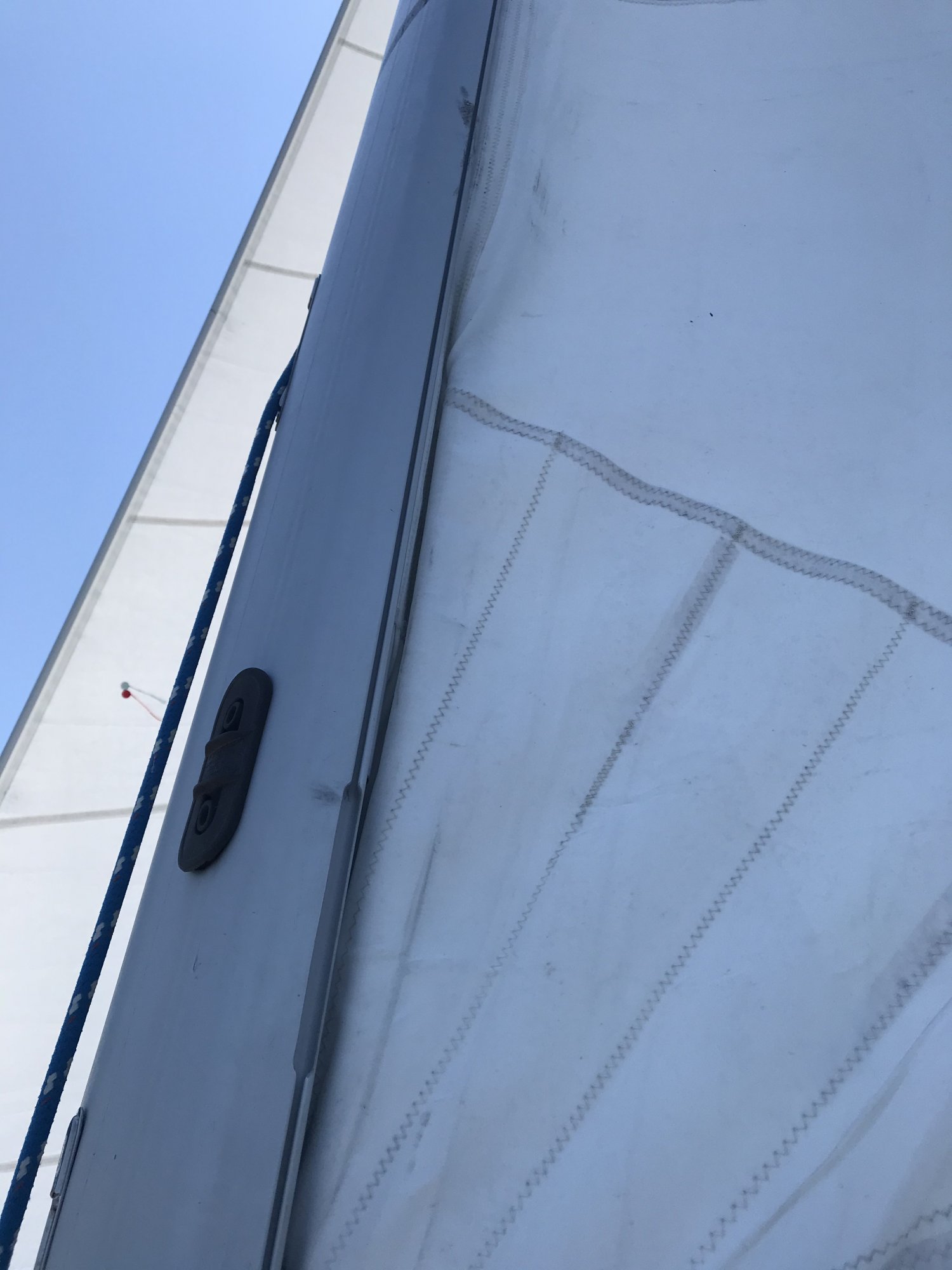

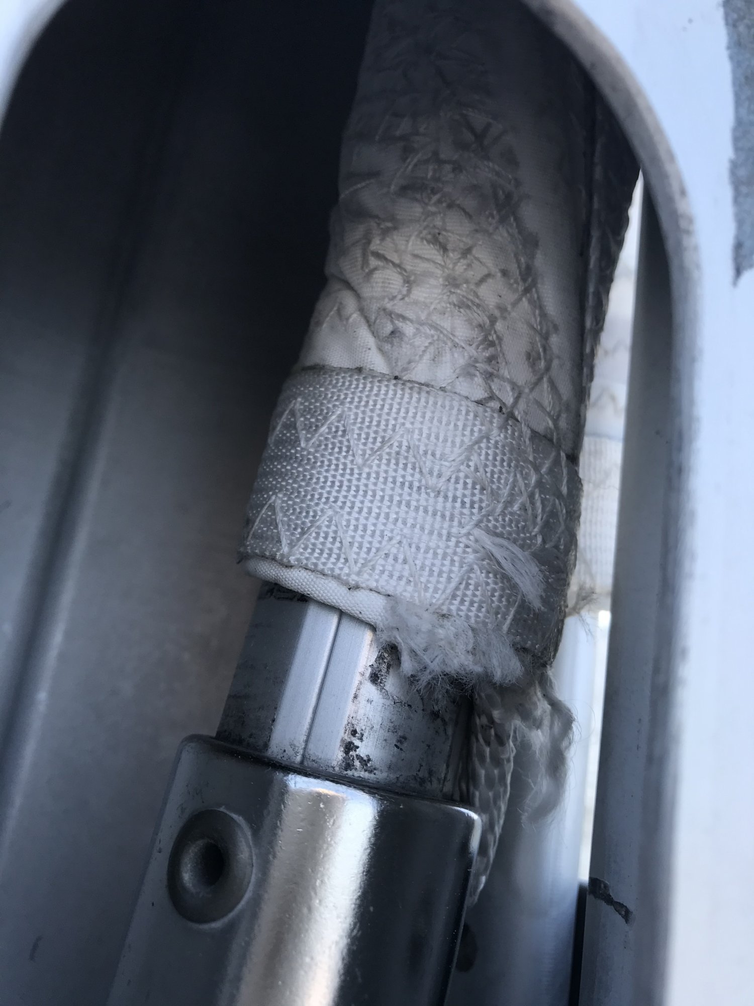

Having an issue with the furling system. The bottom of the sail will not extend fully and about one turn of the sail remains on the furling shaft. The rest (90%) of the sail is fully deployed. See pictures. This is obviously causing issues trimming the main among other issues. Has anyone else had this problem and if so advice on correcting. I have not called a rigger nor Selden yet but should I draw a blank here I shall.
Note top of the left picture shows where the sail has fully deployed but that last 1.5 - 2 feet remain on the shaft.
