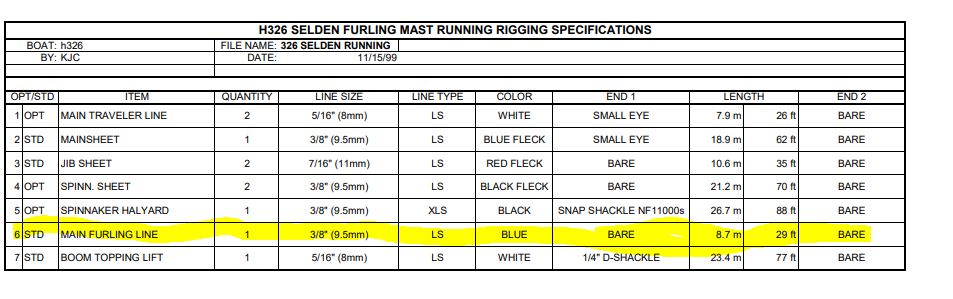

I have a 2003 326 Hunter with the Selden furling main. I want to replace the outhaul line, however I don't specifically see that in the manual. It looks like it could be the main furling line although I'm not sure. I do have the ratcheting pulley with a continuous furling line on the mast. I'm just curious if anyone might know? I've attached a snip of the manual here.
