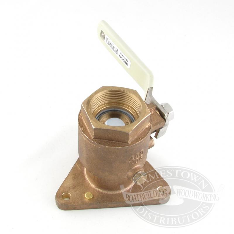

This is the big problem with trying to replace a valve on a thru-hull, which is not an ideal situation anyway. When tightening the new valve, with mismatched threads, you must be 100% certain you do not allow the thru-hull fitting to move. If it does, you break the seal. The other issues with older Oday boats is that they very often used unsealed plywood as a backing plate. This eventually gets wet and can no longer support the thru-hull the way it needs to to keep water out. I have an Oday 30 with your same situation right now and over the winter she is getting all new "proper" flanged base seacocks with solid glass backing plates.

Thanks for the ideas I am going to try a temporary repair until I get it hauled.MS is there any particular polyurethane sealant type that is best, and when you say "proper" flanged based seacocks, what are you referring to?

Flanged seacock and flanged adaptors that allow changing of the valve without a haulout.
Because they are bolted through the hull they cannot turn.
If you use the flanged adaptor with separate ball valve the threads will match. They do not match if putting a valve on the through hull mushroom directly.

Sep 15, 2009
6,244
S2 9.2a Fairhope Al
best thing sence sliced bread
this arangement to me is the best thing in the world for putting holes in a boat...and i dont think its that much more expensive than the other way...matter of fact it is cheaper in the long run ..the first time you have to work on a valve or mushroom fitting ...you dont need to haul out ...this is graet and kudos to main sail for shareing this with every one.
