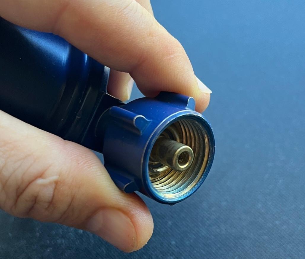

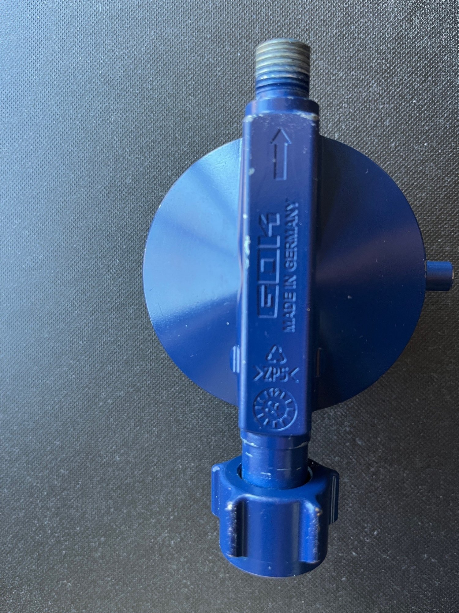

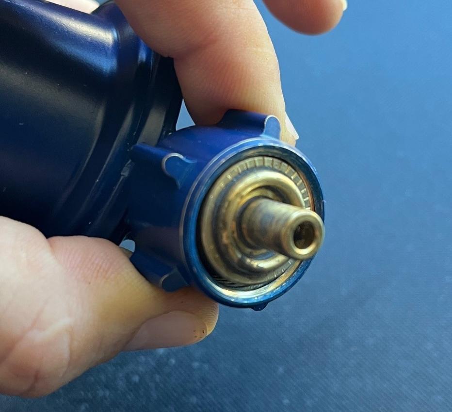

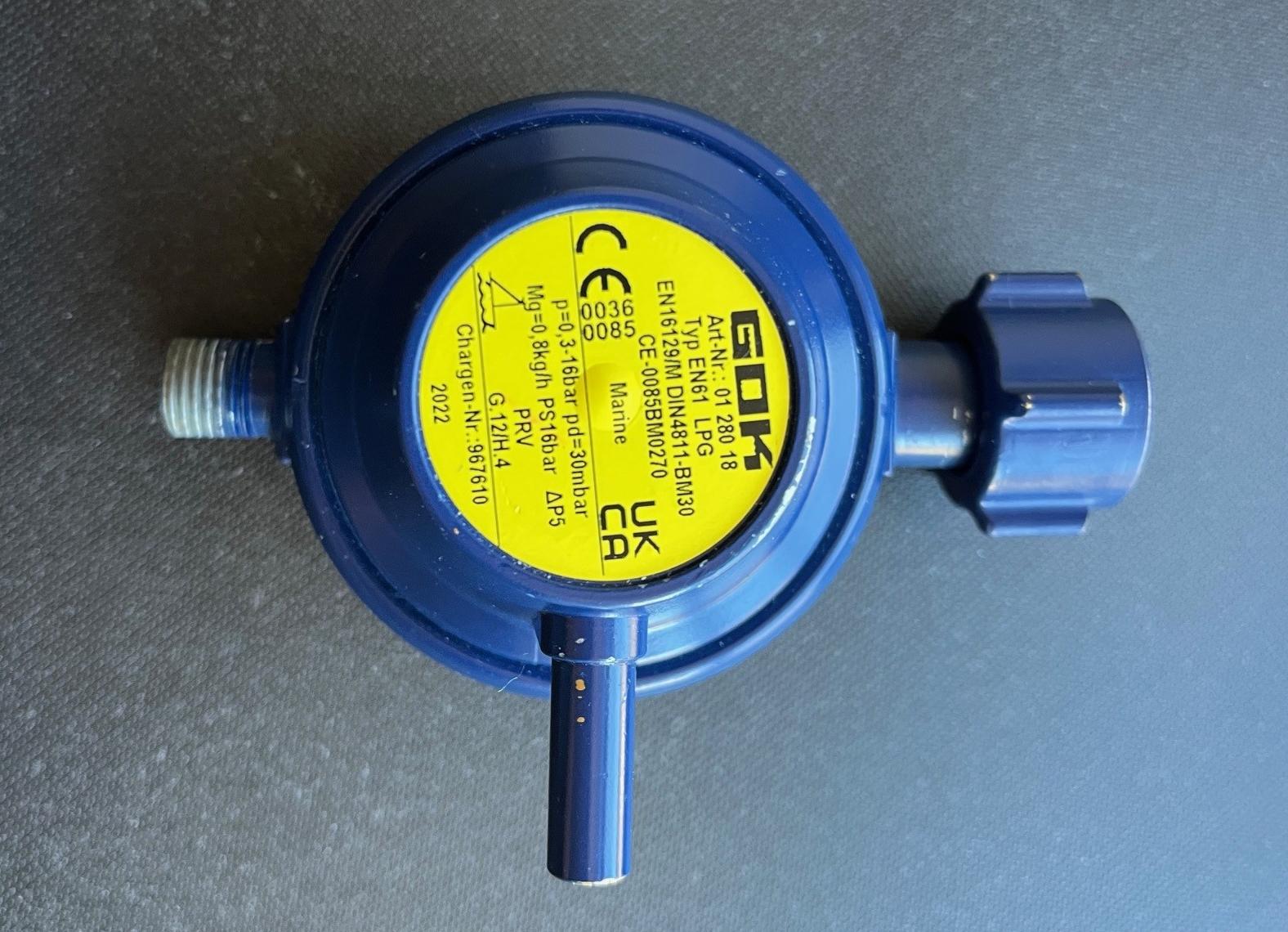

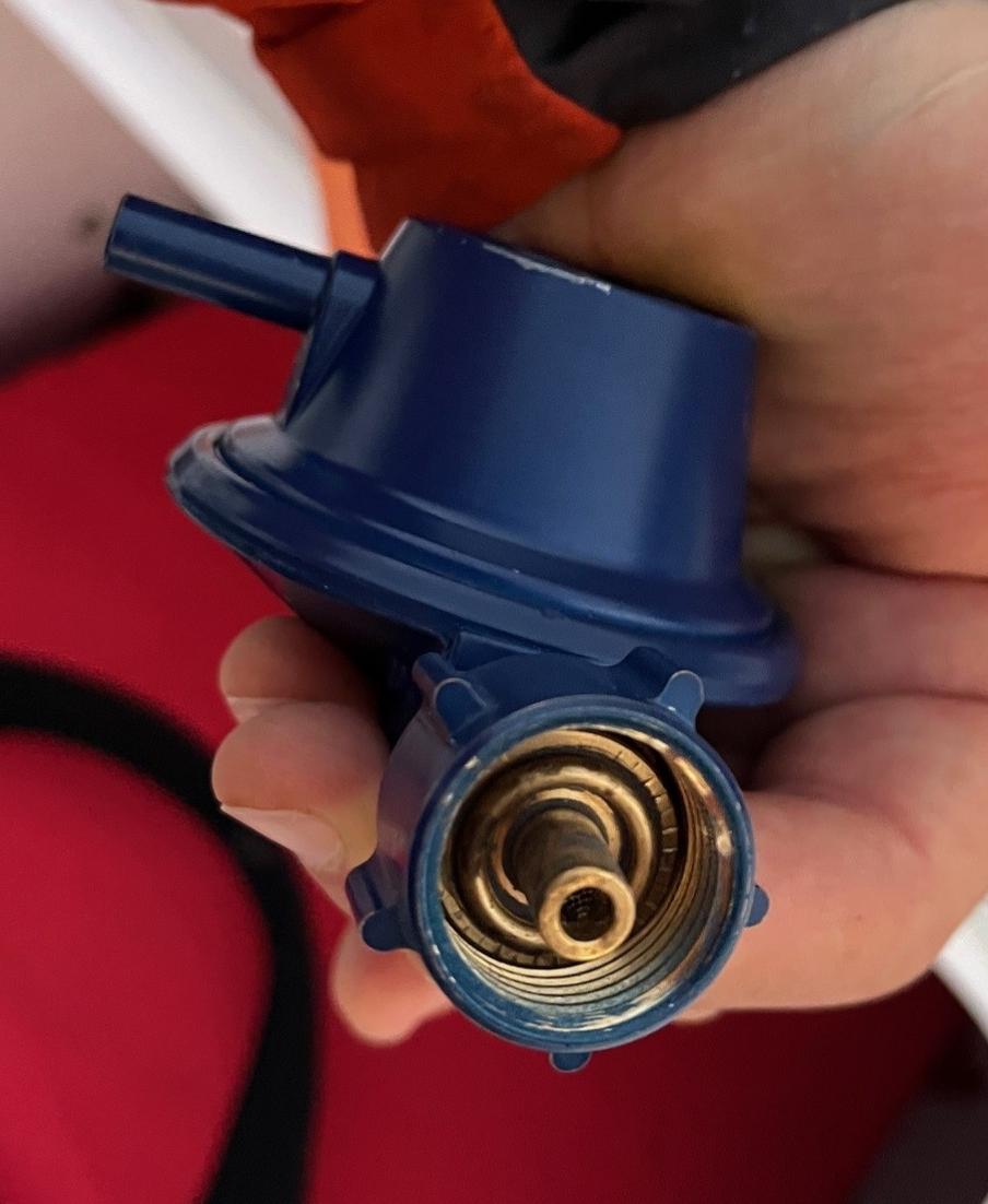

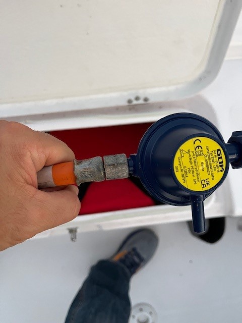

Hello folks,
I have recently bought an European boat that came with German GOK pressure regulator. I am in USA and need an adapter to connect to USA propane tanks. I searched Trident and WestMarine but they only seem to have "European" to USA adaptors and not the German to USA
Do you know of an adaptor to connect this German regulator to a USA tank for the boat?

The simplest way is to buy a new regulator for the US standard tanks.

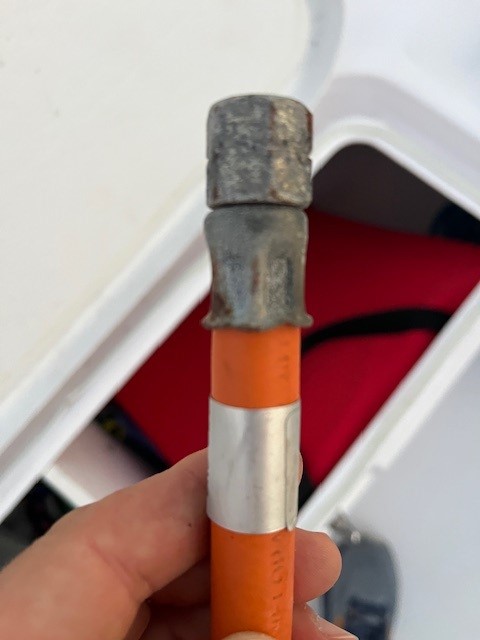

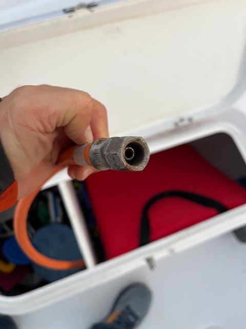

Seemingly so but the boat already has the entire gas line hose routed through bulkheads with the German connection for this regulator... Before attempting to cut the hose and mess with new fittings, maybe a simple connector option exists...

What may be easier is to find a connector that fits the end on your current hose that has a hose barb on the other end. Then connect to a short hose on on the other end the hose barb connection to US regulator. Essentially making your own adaptor, but then just keeping that German regulator if you ever need it.
As a note, finding these connections for propane/butane international type connection problems can be much more difficult than you may imagine... Ask me how I know....

As a cruiser in the Antilles, I carried tanks of both kinds. I just bought a Y valve that would let me transfer from the European to the US regulator hoses. These can be had at places like Harbor Freight. I can't see why you would need to change the hose to below, no matter what you choose to do, unless it is unsafe.
