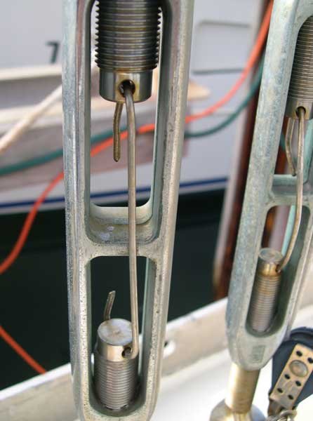

I use very long cotter keys that allow me to wrap the legs all the way around the turnbuckle and bend them back inside to lessen the hazard they present. No possilbe turning with this arrangement. These long cotter keys tend to be soft enough to allow easy bending.

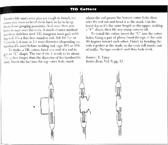

You are quite right that the photo I used does not show the ends properly finished.
That photo came from popular source - and it is not complete because it does not show the finished arrangement.
One finishes this keeper arrangement by trimming the sharp ends thence bending the ends over the bitter end of the stud (i.e. toward the inside of the barrel.) That way the sharp end is bent to the inside of the barrel - resting atop the stud end - and there is no sharp end whatsoever exposed to snag or injure anything or any one.
The original question involved how to prevent the stud barrel from unwinding and the photo does show a method that will prevent the barrel from overriding a standard cotter or ring cotter.
By the way the material I use is 3/32 316 stainless TIG rod. 304 stainless safety wire would work as well. These materials are instantly available anyplace.

Thanks for all the info, guys. I think Charles' description gives me the info I need for size, cause he can use 3/32 TIG rod .. so I should be able to use someting under 1/8 for my rings or keys.
