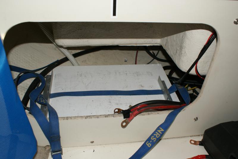

Plywood
My battery sits on a piece of plywood that has 1/2 x 1" pieces of wood screwed up through the plywood on port and starboard sides. A standard battery strap goes under the plywood and around the battery.

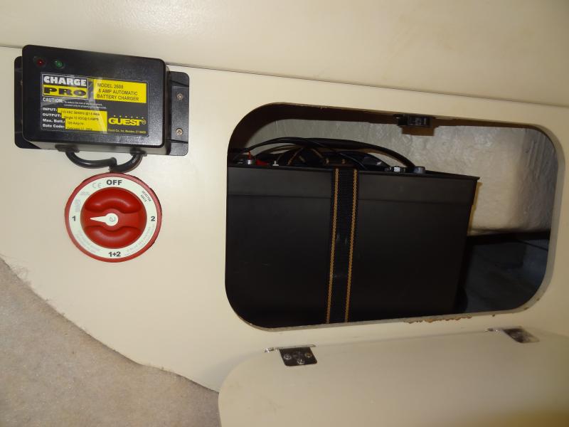

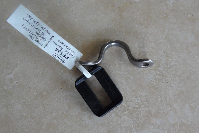

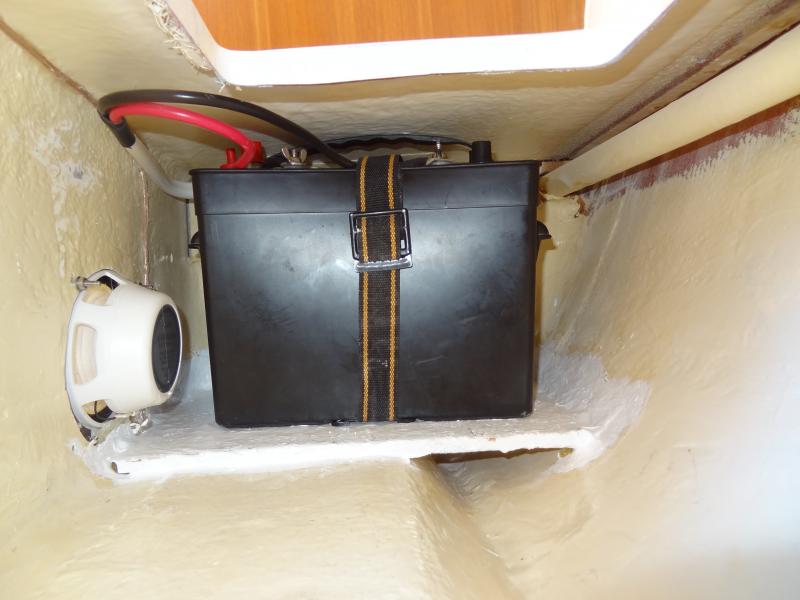

My 260 carries two batteries; both are in boxes and secured by straps. One battery sits back behind the berth wall on starboard and the second on an installed plate on the port site, in the locker directly in front of the bathroom wall. The straps for each battery are underneath pulled through two flat u-shaped profiles, screwed to the plywood plates, where the batteries stay on. The downholp profiles look like in my photo but I used flatter ones, not with such high arch and no extra plastic.
