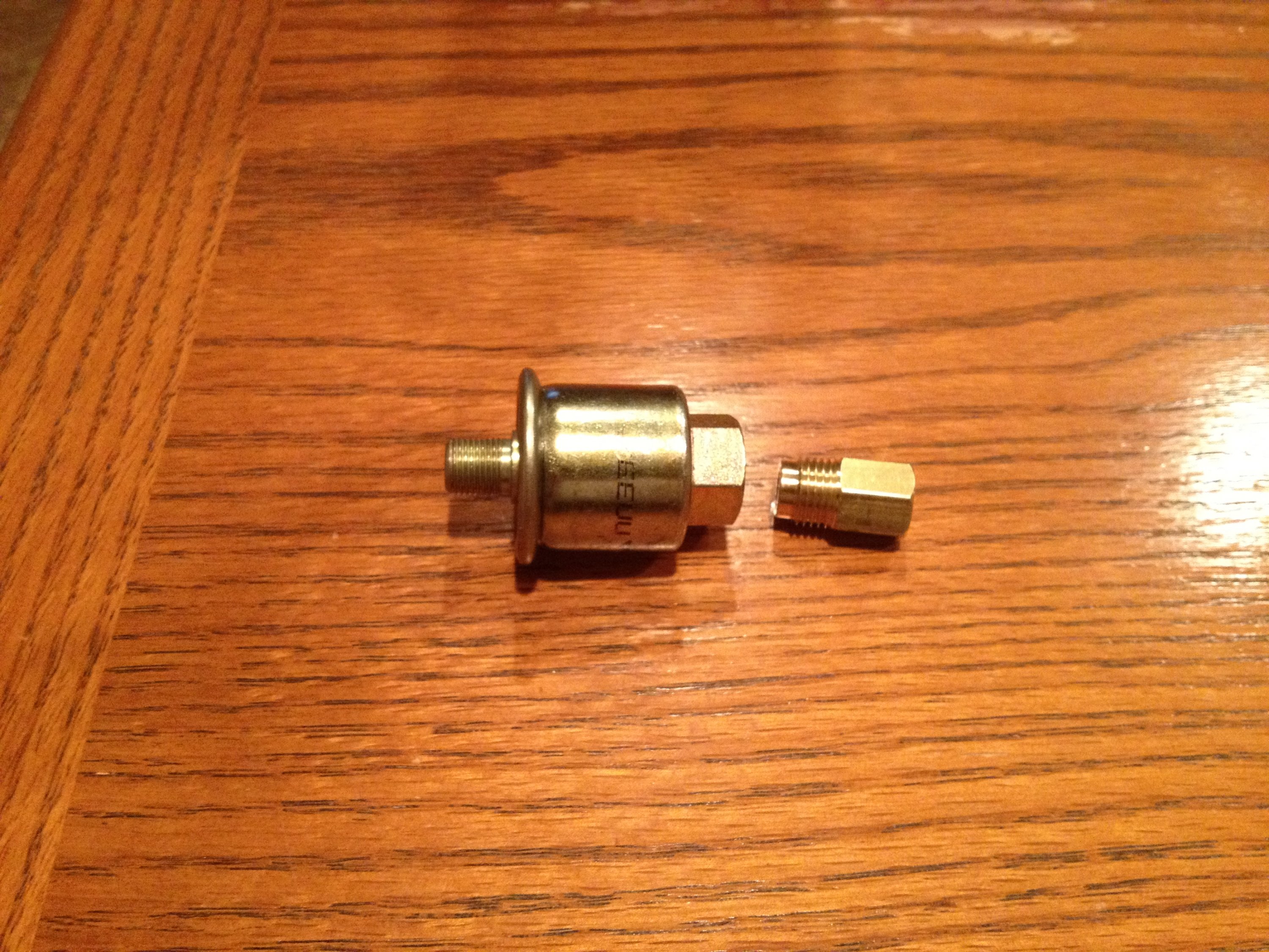

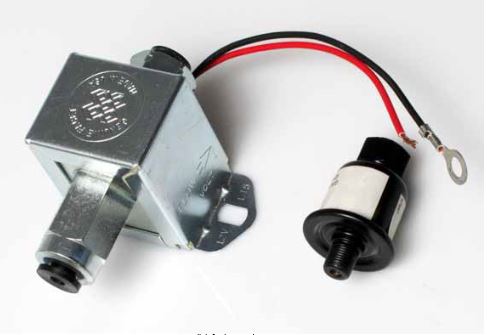

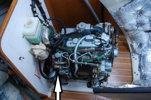

I don't think I am confusing the two. I am referring to the 80 micron secondary filter that inserts on the lower aft area of the engine (see picture with arrow), not the tertiary spin-on filter that screws on the upper forward part of the engine just before the high pressure fuel pump. This is the only 80 micron filter that I know of on the boat. And the image of the filter that comes with the lift pump looks identical to the filter on my boat (see the two photos below). ???
Jeff
Jeff,
That filter is simply a fuel pump guard screen. The actual Facet spec is 74µM & I don't know why Westerbeke rounds it up to 80µM.. It is a required guard screen for Facet to honor a warranty on those pumps and is why Westerbeke installs them. Also severs to catch any debris induced during filter changes. They way they buy their cube-pumps from facet, it actually comes in the kit..
Your primary filter is the one directly after the tank and the secondary fuel filter is the engine spin-on. You should not need to replace your fuel pump guard filter often, if ever.

Jeff,
Yea, that makes a lot of sense. Thanks for the info. I've been changing all three filters every year even though I put on only about 50 hours a season - dock to bay, bay to dock. I've always wondered if I have to change the primary Racor R15P and my secondary spin-on filter yearly since I use the engine so little. It's not so much the money as avoiding a pain in the neck job.
Thanks for the info
Jeff
