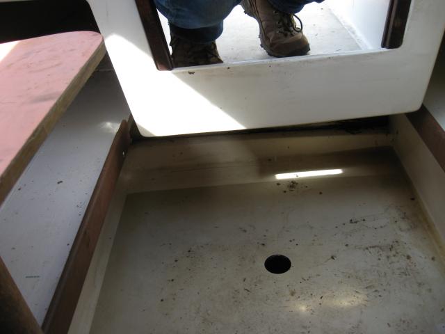

I need some info on an old O’Day 22. I have a 1978 O’Day 23 and have sailed often on a 1979 O’Day 22 belonging to a friend. This old 22 is for sale and I recently inspected it. It does not have a serial number on the transom as the 78 and 79 both do so I can’t tell what year it is.
On the two I am familiar with – the rope and cable to the centerboard come up through a pipe which extends from the bottom of the boat to the deck in front of the companion way entrance to the cabin.
On the O’Day which is for sale, there is a hole in the cabin floor (see picture). It is a foot or so forward of where the pipe is on the other boats. There is no rope exiting the hole (but that may not be a big deal) I question if the water line on the outside of the boat is higher than the exit hole in the cabin – what keeps the water from flooding the cabin? All this looks like “factory condition” not like someone cut off the pipe or otherwise “repaired” the cabin sole.
Anybody have first hand knowledge of this “model” of O’Day 22 or an explanation of what is going on here?
Thanks. Dave

Make an offer contingent on what happens when the boat goes in the water.

My 75 22 has a bilge pump in exactly the same place. The hose comes out on the starboard side just above the waterline about 3 feet aft of the hole you see there.

I can offer a few clues.
The boat predates HIN (hull identification numbers) therefore look for a makers plate inside.
Probe the "hole" with a stick.
Is the boat on land or floating?
Pour water into the hole and see where it comes out.
look for a center board pennant.
If the boat is on land confirm that is still has a center board. They sometimes get lost.
Inspect the boat as if you were looking for reasons to tell your best friend not to buy it. Because that is exactly what you are doing.

The “hole” has a little water in it. The boat is on land – on a trailer. Can’t tell if the center board is “in there” or not. There is no pennant coming out of that hole or anywhere else I can find.

It is the access hole for the builge. I seem to remember reading that the builge pump was an option. In all likelyhood the hole you see was there to allow a pump to be set in there and then the water pumped into the cockpit where it would run out of the little hole in the rear.

I have a 74 O'Day22 with a hole in the cabin floor in that spot. That is where i put the pump in to empty the bilge. My 22 is a fixed/shoal keel.

Yes I decided to continue to list the boat. The info you all provided - indicated that the boat is not damaged nor has a questionable modification been made. That said, I will be sure that any prospective buyer understands the questions I had and sees the hole that started all this.
My O'Day has the same hole for the bilge pump and it is fixed keel also. I think it is late 70's. Dave Cobb.

I sold my oday 22 from the 70's 12 years ago, but it had that hole for the bildge and it was suppost to be there, no big deal. sometimes I would spot moisture in it but again that was not a big deal. It will drain when its more then typical moisture that collects in a boat
