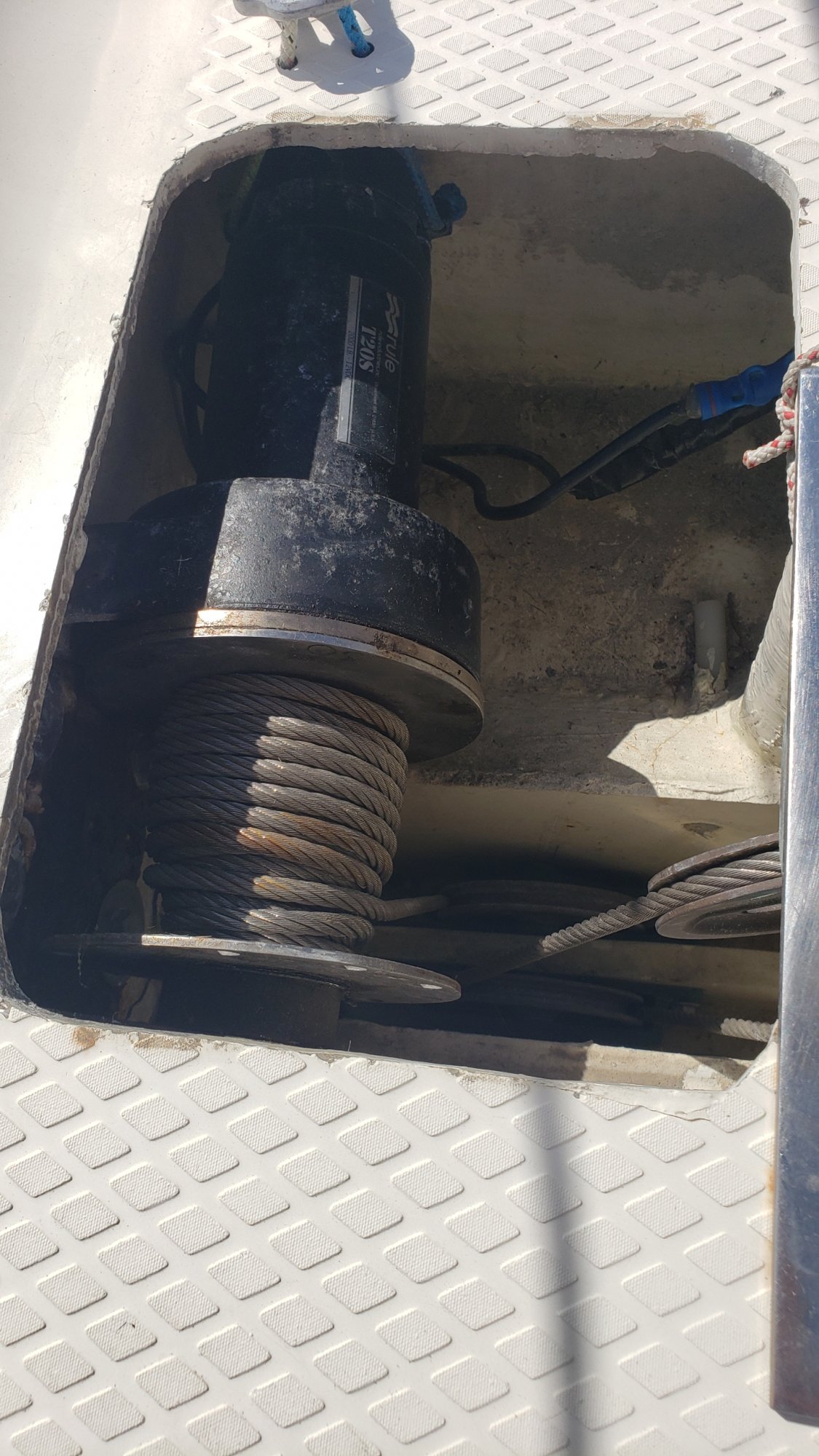

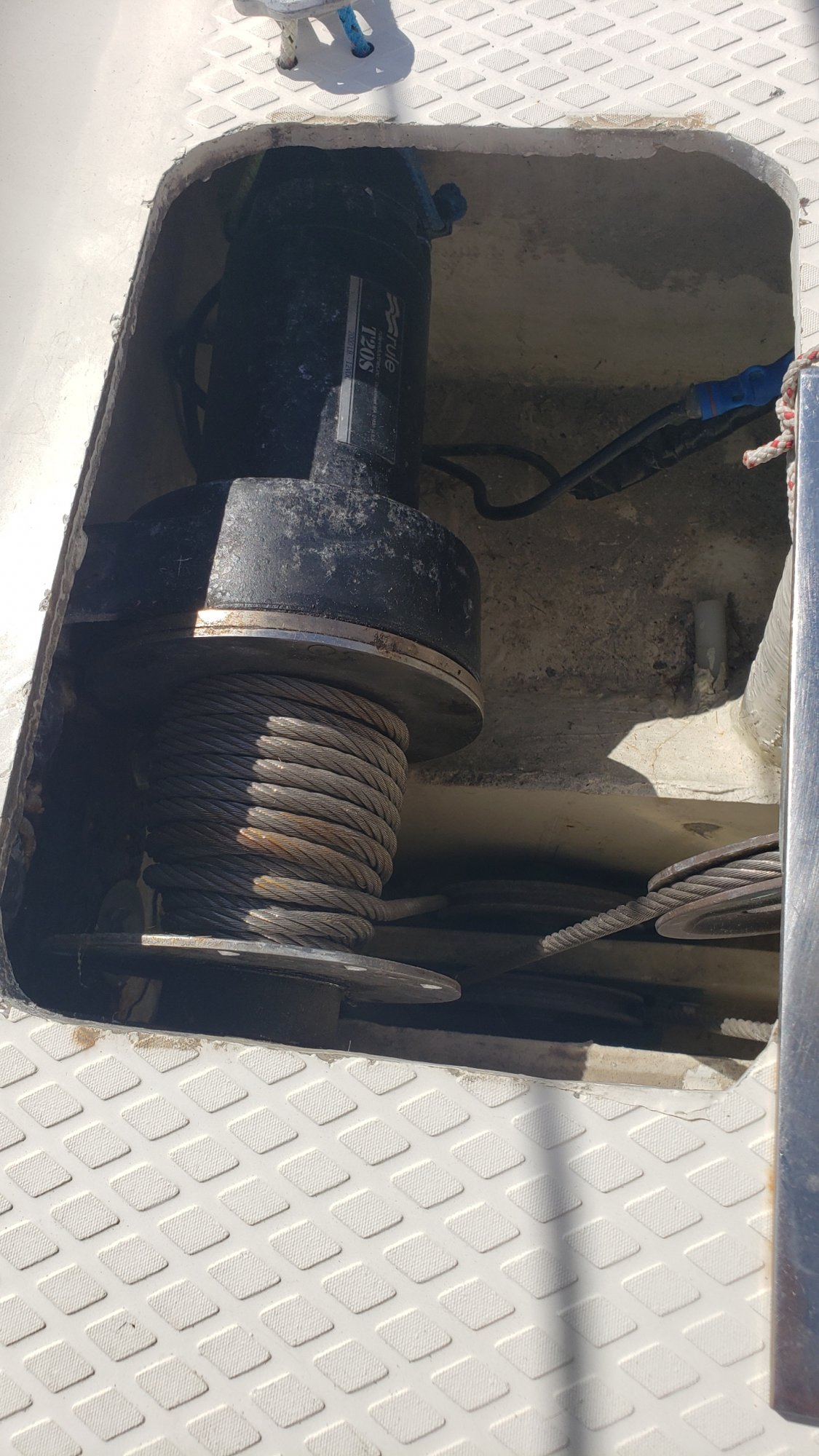

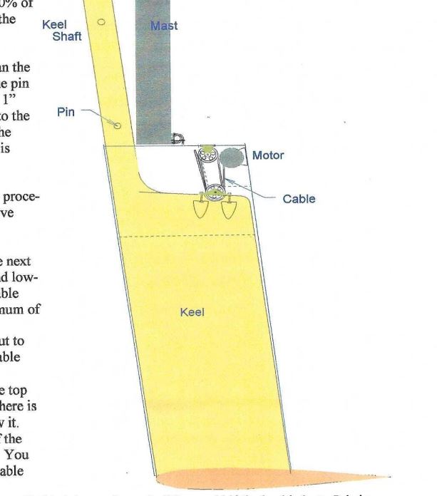

I have a 2002 Hake Seaward 32RK and am looking to replace the keep winch and install a new remote switch in the cockpit to replace the original pull-strings. Appears that the original model (Rule T20S) has been discontinued. Does anyone out there have experience with replacing the Keel winch on a Hake Seaward 32RK?

I'm not lucky enough to have a 32RK (great boat, by the way). But eTrailers.com recommends the Hawse Fairlead - 2,500 as the replacement for that model, on a trailer. Might be worth looking at. Harbor Freight also has a good selection of winches.

Thanks Tedd, I will take a look at this one. I see it has the synthetic rope so I will need to check if it will run in the same pulley system for raising the
keel. Will also check the size as space is tight as you can see in the attached picture. I recently bought a Harbor Freight 2500 winch for raising the mast and it works great and comes with a wired remote and wireless remote. I've thought about using it but would rather find a "marine grade" unit. I'm also looking at a Marine grade Endurance EMD2000SS ($367 at Northern Tool). It looks good, but will need to purchase a separate remote system.
Sounds like I'm on the right trail... Many thanks for the suggestion!

Thanks for the photo and diagram of the winch system. I'm quite keen on the Seawards, especially the keel system, so it's nice to see some detail on how it works. The 26RK is on my short list. The only thing I'm not thrilled about is the interior space and headroom, which are just a bit less than I want. The 32RK would be perfect in that regard, but it's outside my price range and also a little too big, I think, for regular towing and launching.
It looks like it will do the job, the only thing is the rule unit uses a stainless drum so keep a coat of grease on it and it should be fine I had removed the 2 line up down as soon as I purchased our boat and put a solenoid & rocker switch on the helm.

Hey, thanks for the response. The new winch is getting installed with deck foot switches at the mast and a toggle switch at the helm. Also just found that the fuel tank had several minor leaks... ... so putting ordering a new tank. Even though this boat was stored inside most its life, condensate sat in the bottom of the tank and corroded the aluminum.

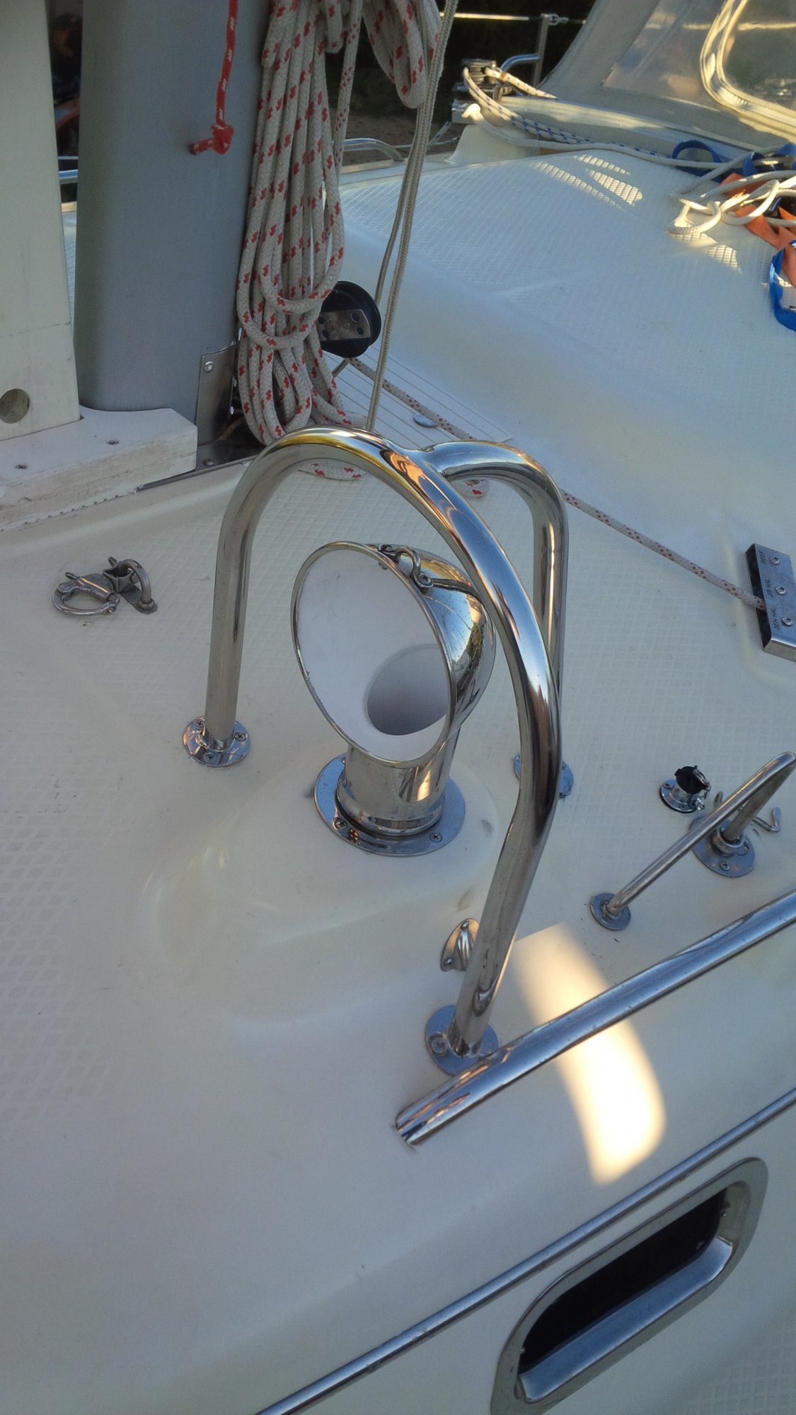

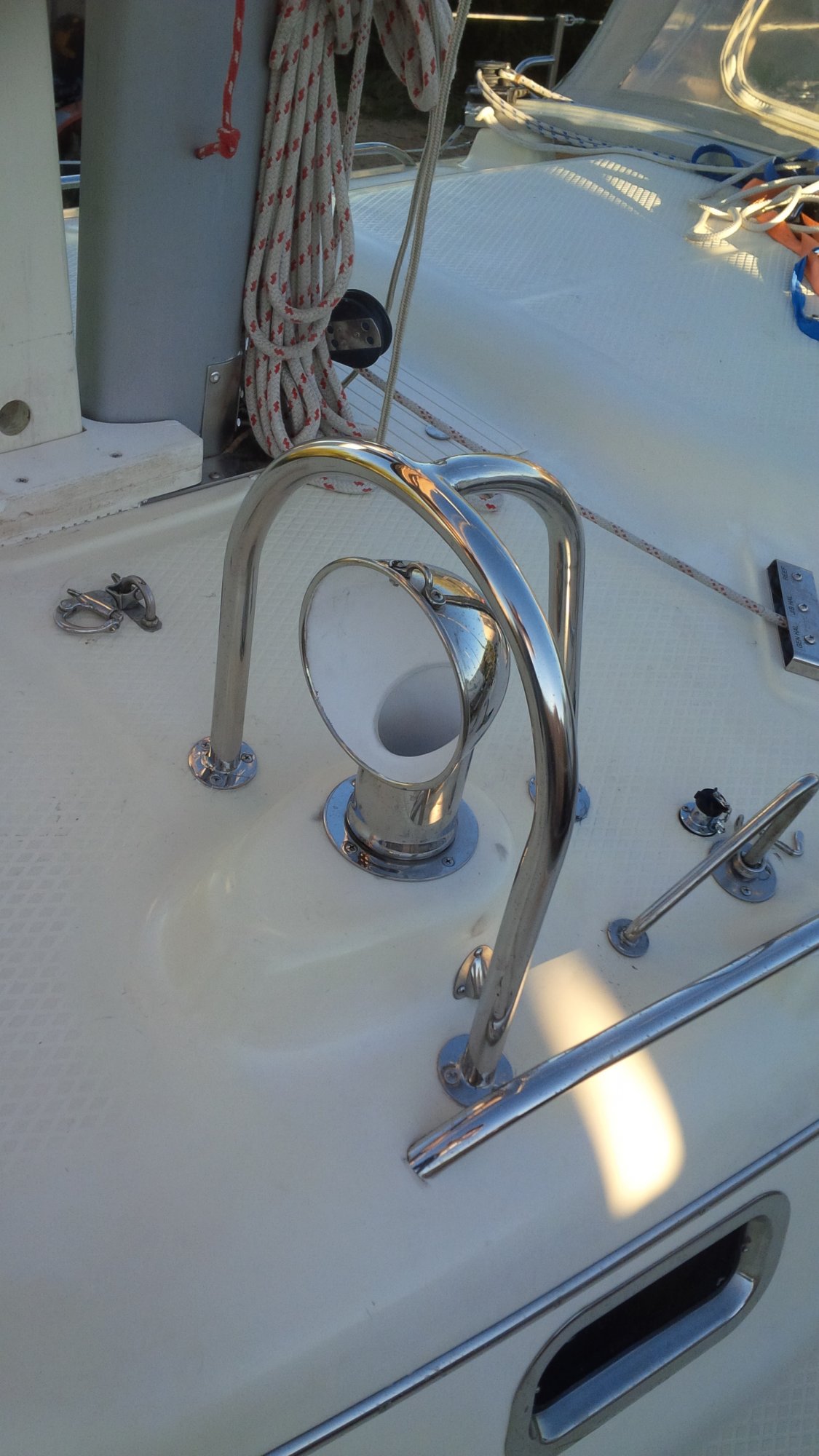

I like the hinged doors. We looked at a 2013 RK that had the doors, prior to buying our 2002. Maybe a future project.... The dorade guards are a good idea. I have tied a line from the top of each Dorade up to the mast to prevent the jib sheets from catching on them. Seems to work, but not too classy. Did you custom order yours?

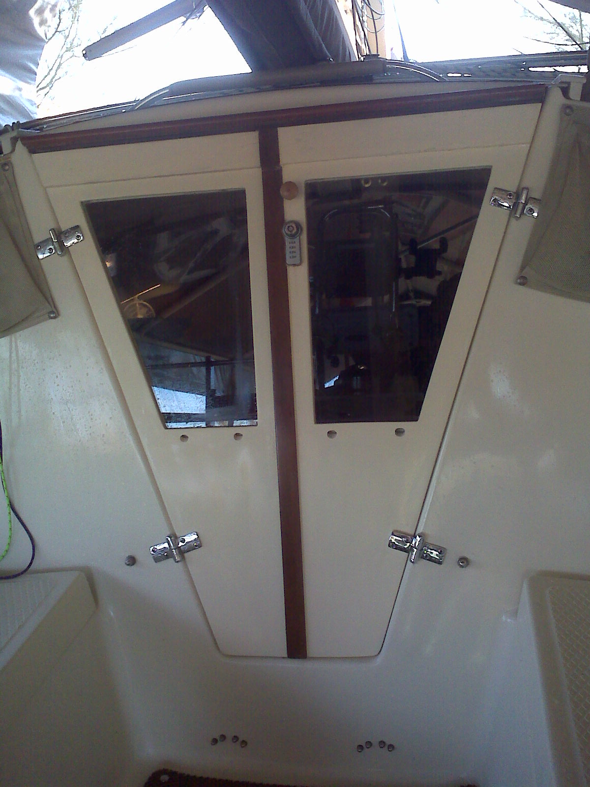

I had the companion way doors as we have such extreme temp swing here in the desert and nates come summer so we go from screen to lexan.
As weather permits the doors lift off and store in the V-birth. we can still utilize the drop boards if needed.
The dorade guards we made here out of some scrap tubing given to us (buddies with lots of 316). We still need the bungee so the jib sheets don't get caught on the keel stem as we often sail with only 1/2 the keel in the water.
