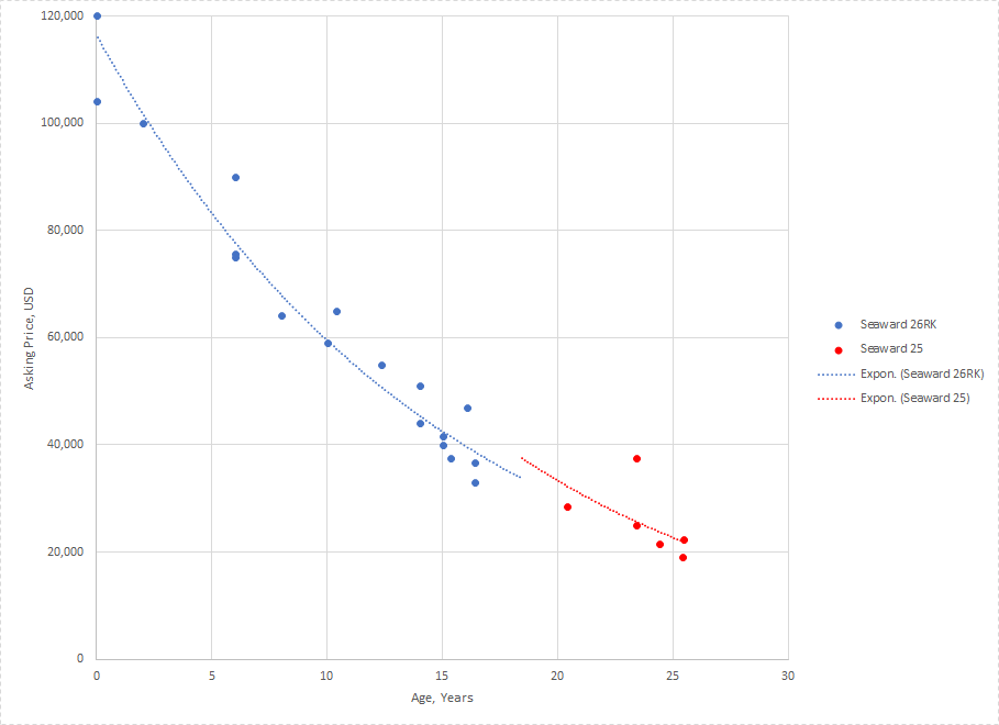

I made this plot about a year ago. You can see that 25 prices and 26RK prices are essentially the same, taking age into consideration.
