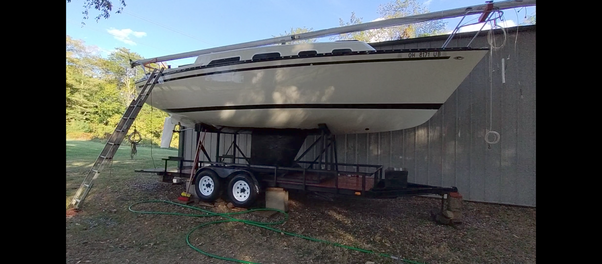

Anyone out there know of a used trailer I could get for a Hunter Cherubini 27? I'm in Ohio. I'm currently using a cradle on top of a flat bed trailer

One reason they are so rare is that the 27’s beam of 9’3” violates load width regulations in many states.

I saw that just this morning in a Google search. It requires a wide load permit - it extends 4 inches too far on each side. Maybe I need to find a heavier duty flat bed. The cradle on the flat bed works. But the trailer I have isn't rated for the WT.
