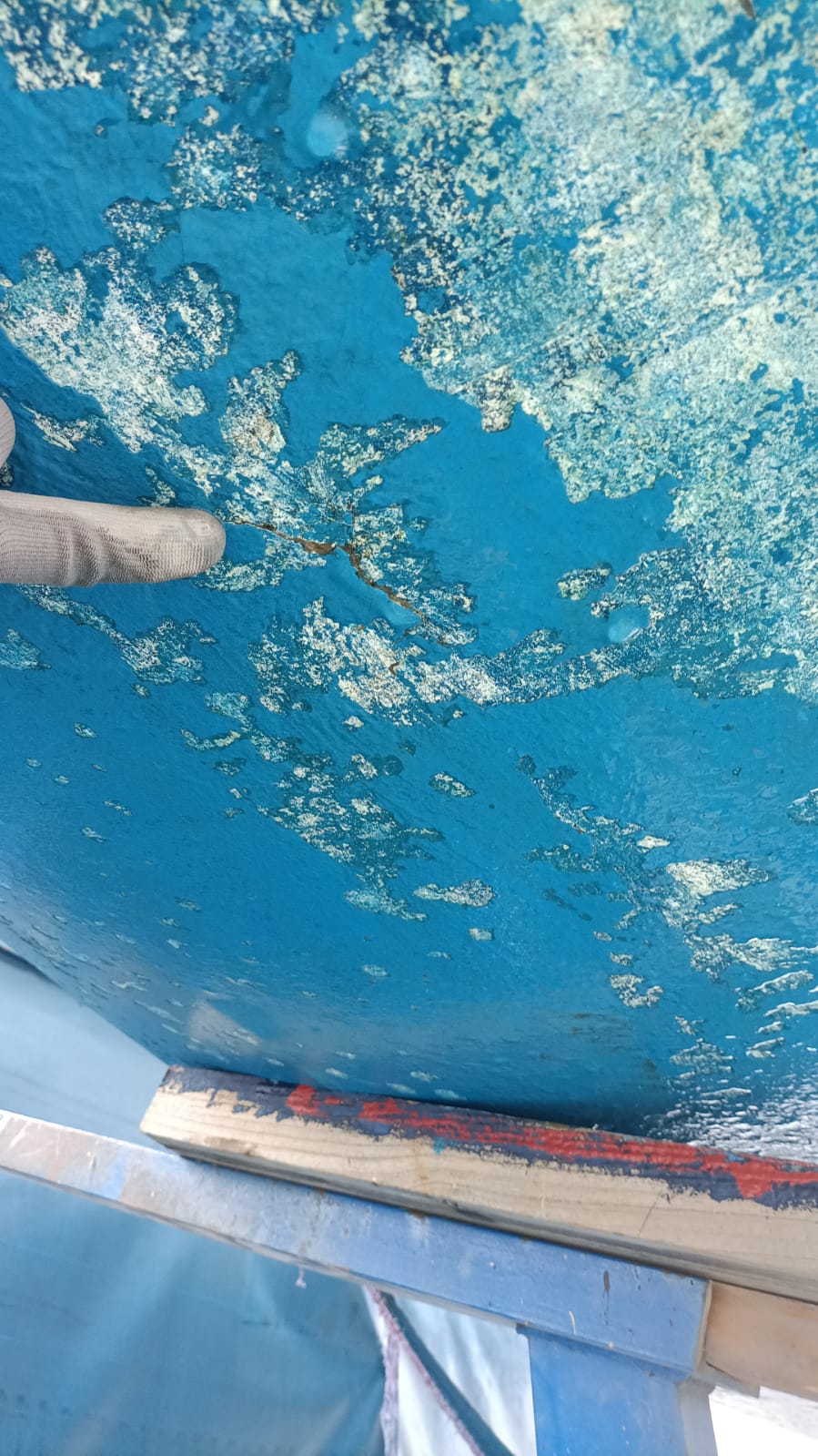

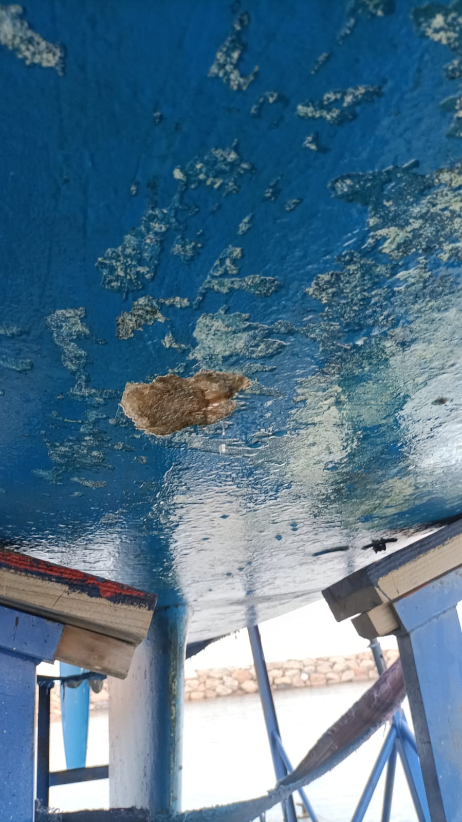

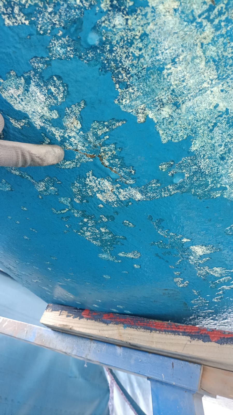

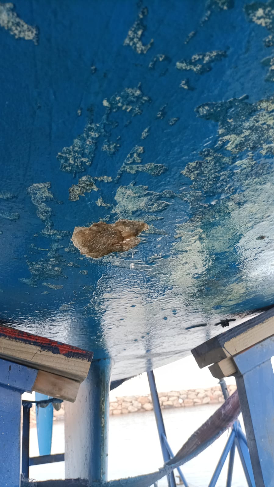

Found the hole once we lifted the boat. A small crack in the hull.
Absolute nightmare as it's directly under The bow water tank. A mechanic in the harbour is saying I'll need to remove the whole tank (which is sealed in) to fix it from the inside.
Is this really necessary? It seems small enough to fiberglass but I don't want to bodge it.
Any advice would be amazing.

If you think it is your water tank, dump a few bottles of food coloring in the tank and see if that color ends up in your bilge.
Yeah did this on the thruhull entry point and it showed it wasn't coming from there. Thanks for the suggestion. Found the hole. It's a small crack which is sitting underneath the water tank.

"Is this really necessary? It seems small enough to fiberglass but I don't want to bodge it."
" no worry it's just a small iceberg" comes to mind besides it seems to have that unusual shape similar to a camel's nose.

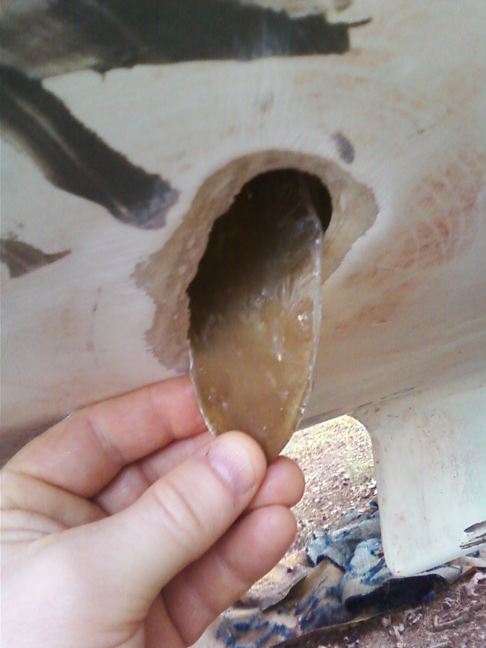

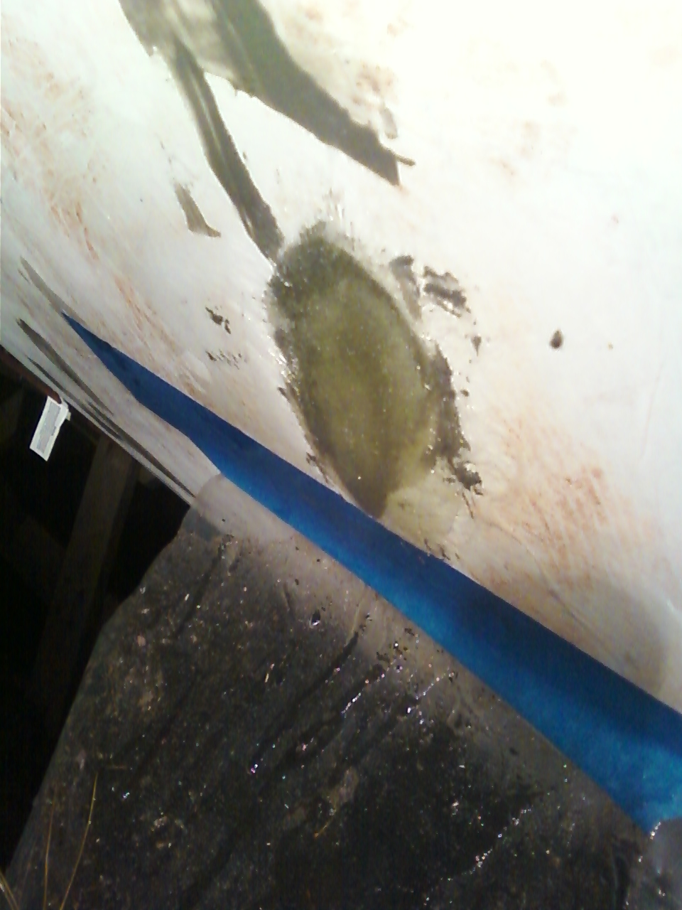

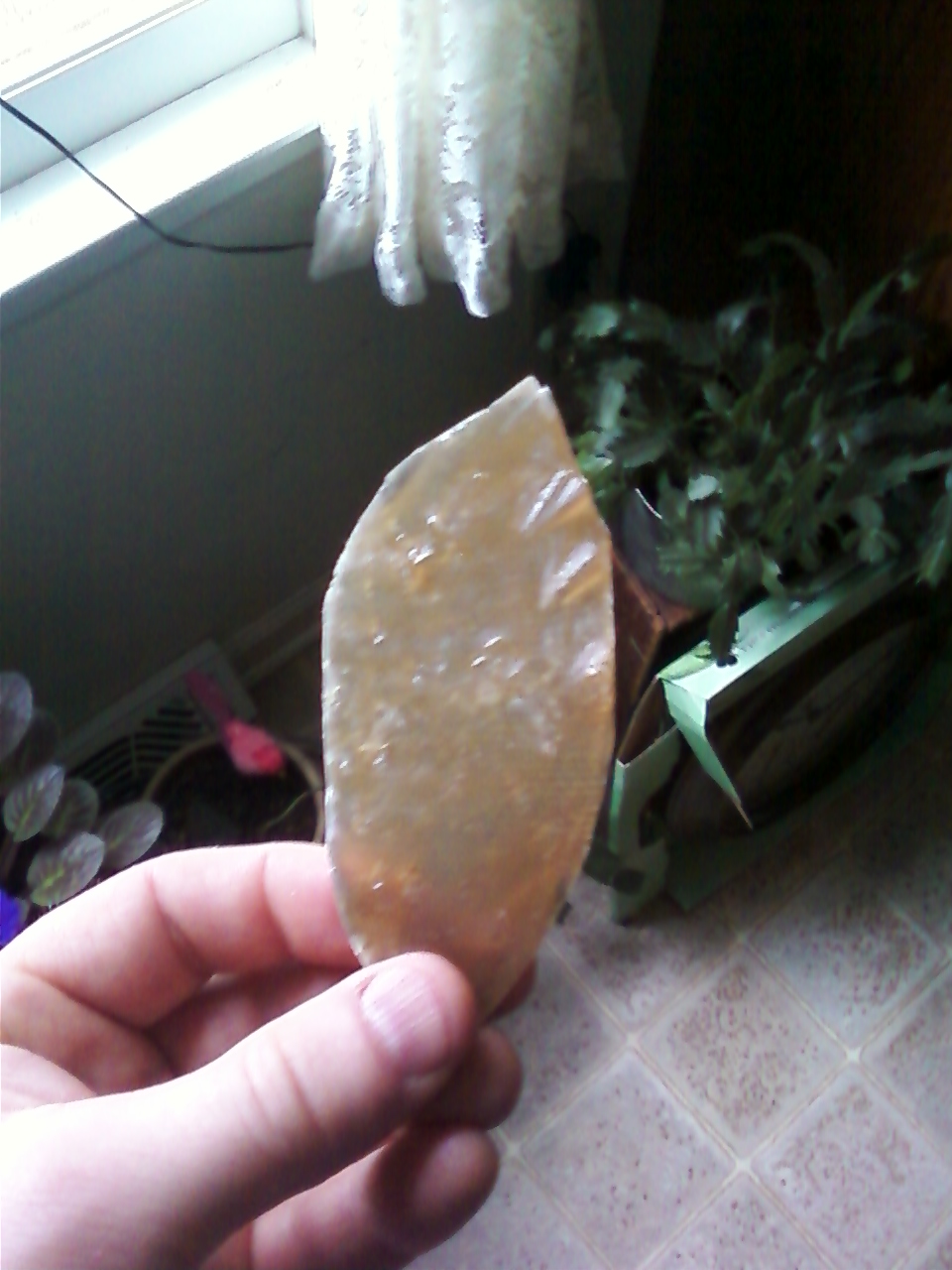

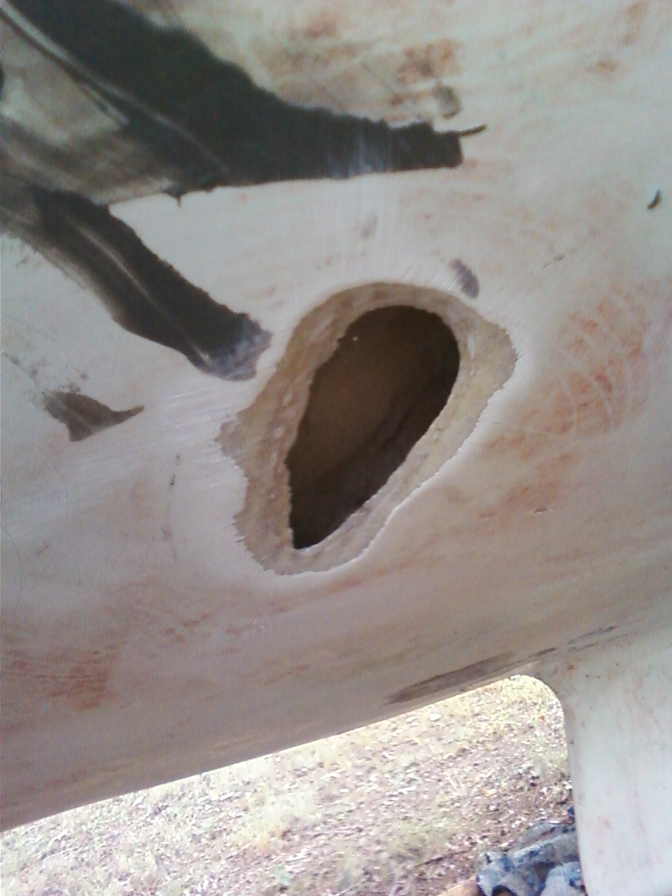

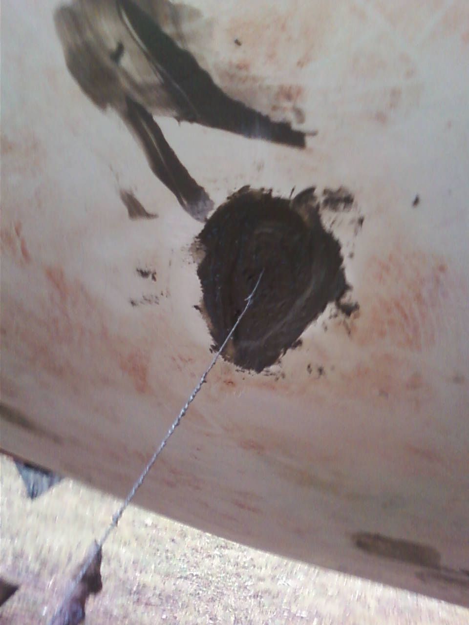

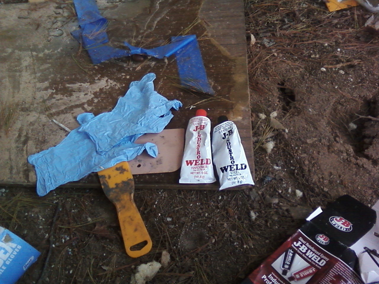

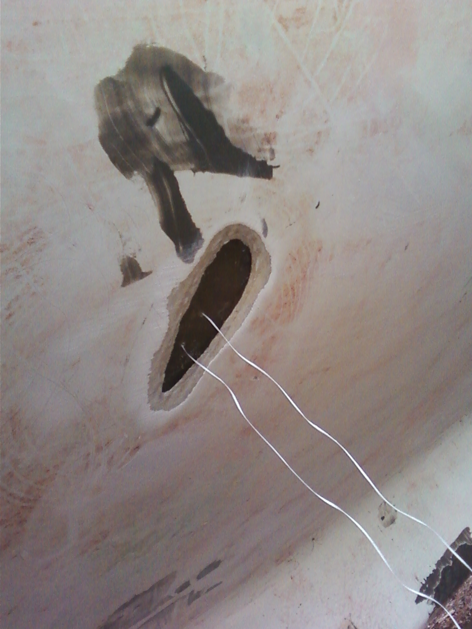

It is easier from the inside but you can do a pro job form the outside. First grind out the crack until you have undamaged cloth … then fair out the grind about 1:4 or 1:6. For example if your grind is 2 cm deep, then fair out the hole to 8 or 12 cm. You will need to glue in a backing plate. See the first few pics. I made the backing plate by laying a pice of plastic film over the hole and tracing out the hole with a sharpie. I then cut the plastice with a lip about 1/4" outside the line. I then used that plastic piece to cut six patches of fiberglass cloth with that shape and wetted them with epoxy resin stacked them and let the set. I then glued the backing plate it in place with J B Weld marine.
I held the packing plate in place by drilling two small holes and threading a piece of dental floss through the holes. Dental floss is made of dacron. I then smeared the plate with the JB Weld and pulled the plate taught against the inside of the hull with the dental floss and let the JB set.
Then I set and lay in successively larger pieces of cloth until the hole is filled in. Fair and paint. In the pic below, you can see me peeling off a piece of velum. I wetted 6 layers of cloth, each a little larger than the previous... then layed them all in the hole at once. Taped the velum over the patch to hold it in place while the epoxy set. When I peeled off the velum, I had a nice smooth surface so.... minimal fairing needed.
I’ve done this type of repair a few times and there are some tricks to make it easier. If you want to go this route we can schedule a phone call. This fix will take you to half days. The reason it takes two is you need to let the epoxy set inbetween steps.
