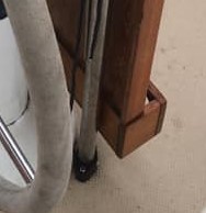

Here is a photo of the connection (sister ship). The base is a 2-bolt nylon base socket that the bar slides down into. There is a ¾"ø hole through the deck under the base for the nav-pod wires to pass through and that is were the water gets into the boat. The most recent effort involved rebedding the base with Bed-it between the base and floor. Then wrapped Bed-it around the wires until the mess was bigger than the diameter of the socket and then stuffed it into the socket. The bar was then wrapped with Bed-it and instated into the gob of butyl in the socket and trimmed the excess off with a plastic razorblade. It leaked.
I then stretched some more butyl around the socket/rod joint and pressed it into a fillet and made sure that it was tightly sealed to both in the fall after the last cruise and that stopped most of the drips but is not a long term solution.
